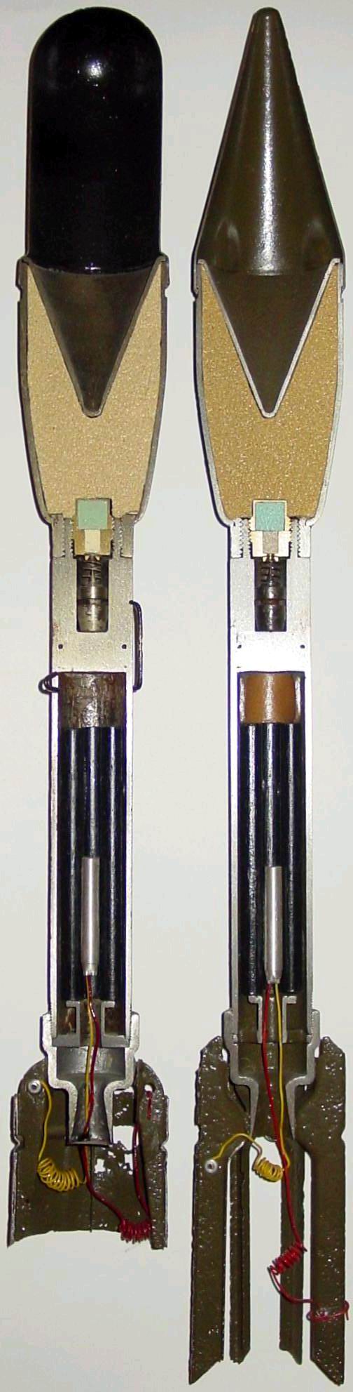

Picture is a cutaway of an antique M6 bazooka rocket, with the detonator assembly visible in the base of the warhead section (yellow stuff) just for
reference.

@grndpndr I think you've got youre rockets mixed up a WW2 bazooka rocket 2,36" doesnt have a piezo electric fuze. The fuze was a very simple impact
type. Once the safety pin was removed, the weighted striker was held only by the light creep spring. Once armed, the round would detonate if dropped
on its nose from about shoulder level. It's electricaly fired though. RPG7 series have piezo-electrical fuzes VP7
@motherload rocket propelled munitions have seldom centrifugal safety measures. The panzerfaust fuze (FPZ8001) relies only on a mechanical setback
safety.

You seem to be correct as I couldnt find any reference to the 2.36 bazooka ever being retrofitted with an improved PIBD fuse.(And Im not that old to
have any FMs/TMs referencing the M1A or improvements LOL) I may have confused the M31 RG with the same wARhead as was used
with the 2.36 in M1a.I believe that instead the 2.6in M31 warhead was the basis of the original warhead for the 66mm M72 Law introduced in early 60s
along with the russ RPG7.
I did however read of the many problems with the original mech fused 2.36 bazooka including the bad habit you mentioned of detonating if dropped with
safety removed.Or perhaps worse not detonating when desired. Such as an extreme oblique angle(glacis plates) ,long range soft targets (Sand mud).Which
may not sound important for an AT wpn but after action reports
indicate the bazooka was used much like the M72 LAW is today against bunkers,Fighting positions,breaching concertina,masonry.As an aside I read a
report about the 2.36 bazooka versus T34 in Korea.Task Force Smith tasked with stopping an armored column early in the war an american officer
allegedly fired some 20+ rockets into the rear engine compartment area of a single T34 w/o effect!?I find that remarkable as obviously that is the
thinnest armor on any tank.In the case of the T34 it could have been as thin as 3/4
in or thick as the 3.5 in glacis plate.Believe it or not story I didnt read the story in the form of an official after action report found in TMs
etc.Could very well be in the heat of the moment 2 seemed like 20 and seconds- hours.
