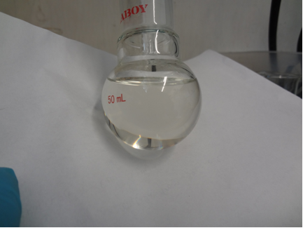

The acetophenone after the first distillation. It's hard to see but it has a light tan colour

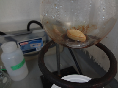

The residue left in the flask after the first distillation

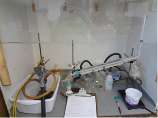

The distillation set up

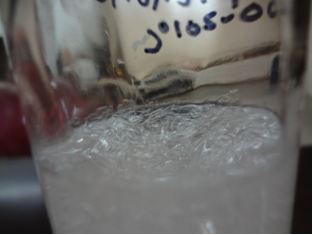

The acetophenone after it's second distillation, it crystallized into a beautiful mass of crystals. The liquid before it solidified was a perfectly clear colourless liquid with a sweet cherry smell.
