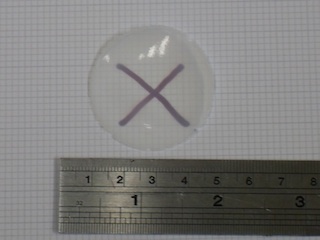

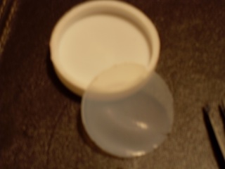

As I mentioned in another tread I have also started to work with boehmite sols in the hope of making Al2O3 freestanding membranes. So this is one of the things you can do with them. The attached image is of a free standing boehmite membrane made from aluminium isopropoxide. I not sure that you could maake these with pre made sols but you could certainly try. Apparently the morphology is a critical parameter. This one was made by adding about 5g of aluminium isoporpoxide to 30ml H2O with vigorous stirring at 70C. The isopropanol formed was then distilled out. 0.5g of acetic acid was then added to the hydroxide suspension and the whole lot transferred to a teflon hydrothermal reactor and heated at 160C for about 12 hours. The resultant sol was slightly opaque with a blueish tinge. About 5ml of the sol was slowly evaporated in a teflon boat (well really a teflo beaker cut down to size to ease removal of the membrane after drying) of the course of several day.Next week I calcinate it and hopefully it will still retain its shape. A very interesting paper with the original method is: Naofumi Nagai and Fujio Mizukami

That is really cool. Please report back on the calcination. May I ask, what is the ultimate goal of this project?

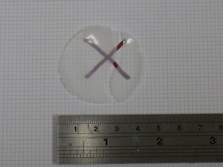

So the calcination seemed to go well. The images below show pre and post annealing at 750C for 1hr heating up at a rate of 10C per minute. There was a slight increase in opacity but this is probably not noticeable in the images. The membrane had to be broken to get it into the tube furnace that I was using and wasn't a result of the annealing. After the membrane seemed more robust and didn't require as much care in handling.

Thank you for sharing that! I would assume the heat up and down rates would need to be carefully controlled so as to not heat it asymmetrically, or create stresses in the membrane.
There's a lot of room for experimentation. I hope these guys perform as you expect. Good luck!
