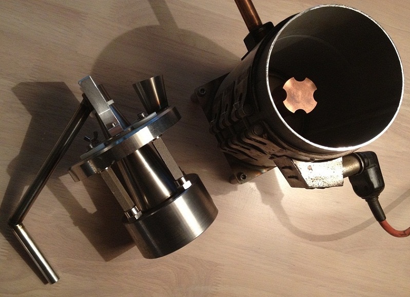

Cell type: Castner Tiegel
Anode: Copper
Cathode: large iron ring
Cell capacity: 2400ml
Cell container stainless steel
Heat source: old heating element from a injection molding machine
Voltage: ?
Amperage: ?
Never had a run at it. As you probably can tell, Im more the machinist than the chemist. The idea was to produce large amounts of sodium continuously.
Na Cell 1.JPG - 166kB
Na Cell 2.JPG - 161kB

@Broken gears Are you planing to run it someday?

Broken Gears
Posts: 96
Registered: 7-8-2005
Location: Northern Europe
[*] posted on 29-6-2012 at 12:23
Yeah someday. I know that there are 2 well discussed subjects on that matter in the Technochemistry forum, but I haven't read it all and I still kinda uncertain about the power supply and settings. I'll be sure to let you know and post some pics on the day of launch :)

Broken Gears, fire that puppy up! I like it, very neat and well constructed.
