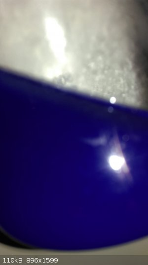

Edit: attached a picture of the wonderful blue color of nickel acetate dissolved in ammonia
The tiny supernatant is composed of 50g of acetophenone, about to be aminated.
