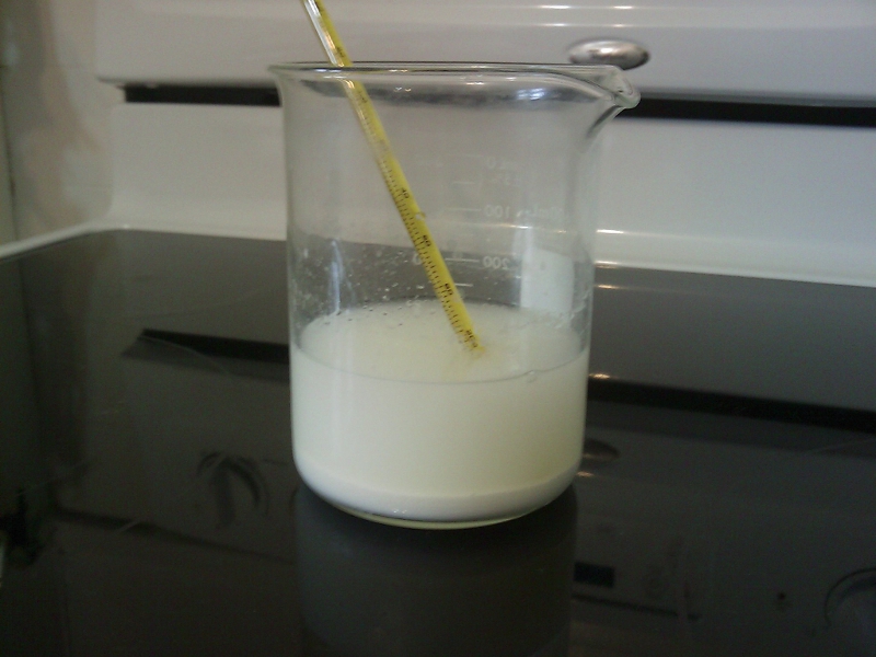

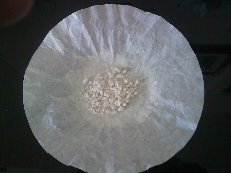

In my second last post I mentioned making another batch of Sodium Azide. I got another yeild very close to 50%, about 1.6g from 6.5g of Hydrazine Sulfate.
I decided I was going to purify the NaN3 this time, so I dissolved the ~1.6g NaN3 in a minimum of water. I found an old gallon jug of methyl hydrate, partly full out in the shed. I started adding it, quickly realizing I was getting no precipitate. I examined the jug and noticed the cover didn't fit or seal quite right, so I am assuming it sucked up a lot of water. I cursed for a while then decided to look up the solubilities of Lead Nitrate and Lead Azide in methanol. As it turned out Lead Nitrate is quite soluble in methanol, and Lead Azide is not. So adding a slight excess over stoichiometric quantity of Lead Nitrate dissolved in water and precipitated my azide as Pb(N3)2. Yeild was 3.44g of almost white Lead Azide.
A Lead Azide synthesis doesn't appear to be nearly as sensitive to NaOH, whereas Silver Azide would end up full of Silver Oxide. This is no surprise really.
I was wondering if I should be boiling down the alcohol that was used to make the Sodium Azide after collecting the primary/first precipitate of Sodium Azide. I have been just tossing the alcohol, but maybe I shouldn't be. The last batch had over 250 mL of isopropyl alcohol as waste, for a yeild of NaN3 of only 1.6g. I haven't found solubility information for NaN3 in isopropyl alcohol, but I bet I am throwing some good stuff away.
Pictures of the Pb(N3)2 precipitate in methanol and water, and the dry yeild (3.44g, from 1.6g of NaN3). I figure I lost at least 0.2-0.3 g in the filter paper.
Lead Azide precipitate.jpg - 274kB Lead Azide yeild.jpg - 322kB

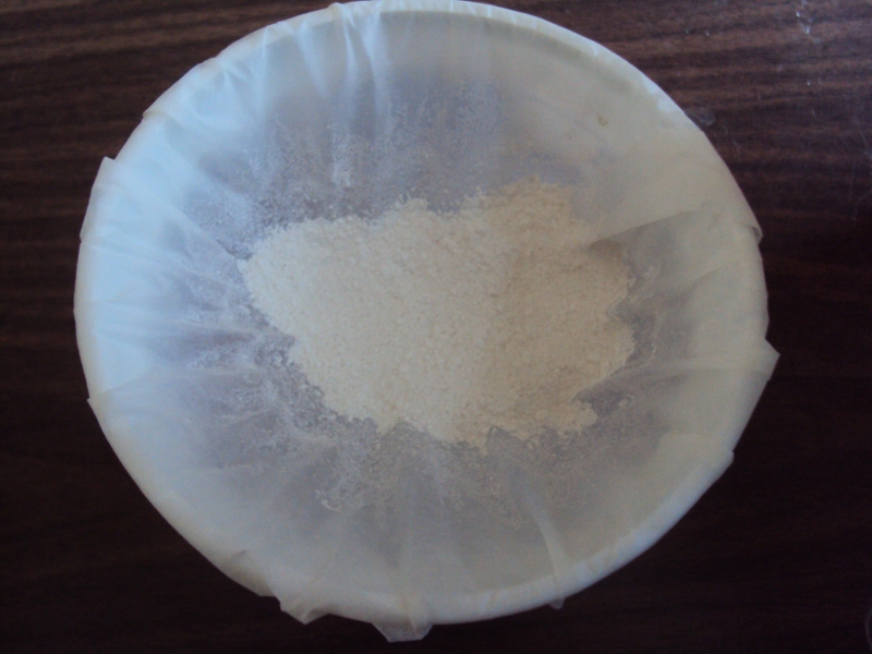

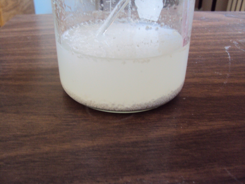

Silver Azide experiment:
On a more positive note, I followed Microteks advice and adjusted the pH of the NaN3 solution before adding the AgNO3 solution to it. It was hard to tell exactly where neutral was, but I think I got it pretty close and the results speak for themselves. I was using some of those broad range pH test papers.
I kept the solutions fairly dilute as suggested, using 1.3g of homemade NaN3 in 100mL of water and 15% HNO3. I added a couple drops of HNO3 with swirling then checked the pH, by the time it was neutral I had added 8 drops. It maybe could have used another 1 or 2 drops.
Look at the nice white powder.:D
It actually picked up a tiny hint of grey just form the bit of light it was exposed to during filtering, etc.
Compare these pictures to the picture of my first attempt at AgN3, (half way down page 6 of this thread). White vs. dark grey.
I will use this routine the next time I make Pb(N3)2 as well.
Silver Azide precipitate.JPG - 203kB Silver Azide filtered.JPG - 210kB

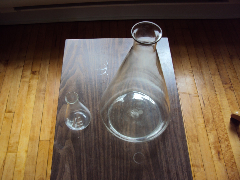

BTW, over on the Hydrazine thread I saw people saying that large glassware was not available to everyone and such and such. I looked around on the internet a while back and I found several sites selling 5L erlenmeyers. Apparently 5L erlenmeyer flasks are very popular with the beer brewing crowd to start yeast cultures. I think they normally went for around $40-$50, and were borosilicate glass.
Here is a picture of my large 5L erlenmeyer next to a 250mL erlenmeyer. Mine is older than the hills and was given to me. Since it is my largest piece of glassware it gets a pet name, "Big Earl".
Big Earl.JPG - 251kB

I just realized I left about 30g of Hydrazine Sulfate out on a filter paper for about 3 weeks. I actually meant to put it away about twenty times, but somehow the time was never right. I am in the process of making some NaN3 with some of it, and I have to say it seems to perform quite normally. Will have a yeild tomorrow which will probably tell the real story.
From what I have read Hydrazine Sulfate is a very stable and oxygen resistant form of Hydrazine. I have seen sources say that it is still degraded by oxygen, but they never said to what exact extent, just that it was much less.
I will let you know what kind of yeild of NaN3 I get from the Hydrazine Sulfate that was exposed to the air for 3 weeks.
[Edited on 18-5-2011 by Hennig Brand]
