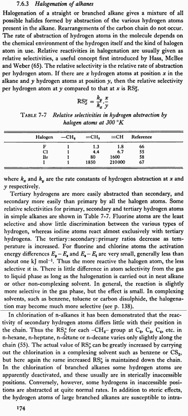

Quote: Originally posted by weiming1998
I did not claim that it does not require free radicals. Cl2 spontaneous breaks down into Cl. radical under UV light, which can be provided by the sun.
Hmm... Read Lithium's first post and then read my previous reply again. Perhaps you will see a certain discrepancy between what you just said and what was already said. That certain discrepancy is what I was already pointing your attention at.
The free radical then attaches itself to small amounts of C8H17. radicals (not sure if these exist, but CH3. radicals do exist in dilute CH4) in the gasoline, producing the desired chloroalkane.
Nope. The reaction mechanism is quite different. The chlorine radical formed by the homolysis of Cl<sub>2</sub> first abstracts the hydrogen from the alkane thus forming the alkyl radical. This is then chlorinated by another molecule of Cl<sub>2</sub> forming an alkyl chloride and regenerating another chlorine radical (which reenters the radical chain reaction). See http://en.wikipedia.org/wiki/Free-radical_halogenation for a step-by-step representation.
What you described above is actually a so called chain termination reaction which is a side reaction that can inhibit the radical chain chlorination. Luckily, it is kinetically poorly relevant as the chances of two radicals coupling is very small due to the statistical improbability of such an encounter. If it would be a relevant reaction, then radical chain reactions would simply not work, at least not preparatively.
This links proves the existance of a longer-chained chloroalkane. http://www.sigmaaldrich.com/catalog/ProductDetail.do?D7=0&am...
I suppose that if it isn't formed by chlorination, then you are right.
Nobody expressed doubts about the existence of 1-chlorooctane. It is thus sad that you post a link to Sig*a's catalog instead of posting a reference relevant to the topic. Anyway, to bring this on topic, radical chlorination of n-octane does not selectively give 1-chlorooctane, not even remotely so. The reaction step which determines the reaction selectivity depends mainly by three factors, C-H bond homolysis energy, statistics (number of different C-H bonds) and sterics. The first two factors work against the formation of 1-chlorooctane (6 methyl's C-H against 12 methylene's C-H bonds and about 4-fold selectivity of chlorine radicals toward methylenes). Only sterics very slightly works for it. For a more comprehensive review, see the attached excerpt from Free-radical chemistry; structure and mechanism (1974, by D. C. Nonhebel, J. C. Walton; also available as googlebook preview):

Ok, now I understand the reaction mechanism. I thought the chlorine radical joined with other radicals. Now I know that it did not. Thanks for helping!
