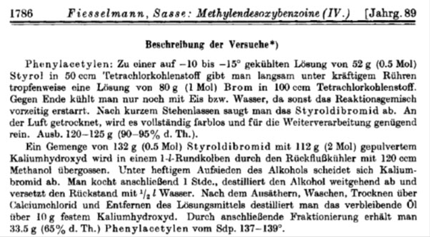

I have also performed the third step (styrene dibromide/(1,2 dibromoethyl)benzene to phenylacetylene) using potassium hydroxide in methanol according to:
Fiesselmann and Sasse, Chem. Ber., 89, 1775 (1956).

What did you use the phenylacetylene for? Some of my batch is destined for a small (<50mmol) prep of 9,10-bis(phenylethynyl)anthracene. I want to try out the Sonogashira coupling. Or maybe I'll attempt rubrene. Either way, it's going to glow.

So that's what you were going to use the dibromostyrene for! I didn't realize acetylenes could be prepared so easily - going from plastic cutlery to a very interesting synthetic intermediate which opens for some even more interesting reactions! A very nice write-up, and I'm looking forward to seeing the results of the coming syntheses utilizing the phenylacetylene. Will you post a video of the synthesis? Also, how's your synthetic capsaicin project coming along?
Quote: Originally posted by plastics
Great post
What was your yield? It seems weird that people choose to carry out this reaction at 200 degrees and etching their precious flasks if it can be carried out in refluxing methanol. Seeing as I am emotionally attached to most of my flasks, this route would be desirable... :)
