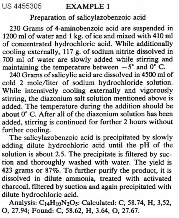

Today I synthesized 3,4'-dicarboxy, 4-hydroxyazobenzene.
![](http://img607.imageshack.us/img607/2161/dicarboxy4hydroxyazoben.jpg)
By louf11 at 2011-08-28
It was made by coupling salicylic acid and para-aminobenzoic acid. No procedure in literature was followed. The synthesis was made on a 1/15
mol scale.
The purpose for synthesizing this azo dye was to make colored smoke with it. This did not turn out well.

Procedure:
A basic solution of para-aminobenzoic acid (9.13 g) was made by adding granulated PABA to a solution of sodium hydroxide. All dissolved.
Approximately 100 mL of 31.45% hydrochloric acid, a large excess, was then added. This gave a very fine acidic suspension of PABA, which would allow a
quick reaction with nitrous acid.
![](http://img851.imageshack.us/img851/4908/img0958t.jpg)
The suspension was cooled in a NaCl salted ice bath. Ice cubes were added to the beaker. The temperature was -4C. An aqueous solution containing 5
grams sodium nitrite (4.6 grams required) was added slowly, keeping the temperature below 0C.
The NaNO2 solution was added until the solution turned potassium iodide-starch paper blue. Granular urea was added until the KI-starch paper was no
longer blue. Urea reacts with excess nitrous acid generating gaseous products.
9.2 grams of salicylic acid was dropped in the beaker.
![](http://img33.imageshack.us/img33/9070/img0959fe.jpg)
The salicylic acid seemed to dissolve to an extent. A saturated solution of sodium hydroxide, NaOH, was added.

The putative product is a known compound. SciFinder gives 32 references (output attached bellow), lists a number of commercial sources and gives the
mp of 223 °C. It is referred by a trivial or by partially rational names such as benzalazine, salicylazobenzoic acid, [(carboxyphenyl)azo]salicylic
acid. It was investigated and claimed to be useful for the treatment of gastrointestinal illnesses. I would tend to believe that it is only a prodrug
for 5-aminosalicylic acid.
Attachment: salicylazobenzoic acid.pdf (104kB) This file has been downloaded 1881 times
