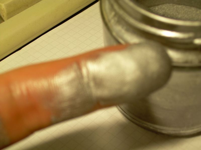

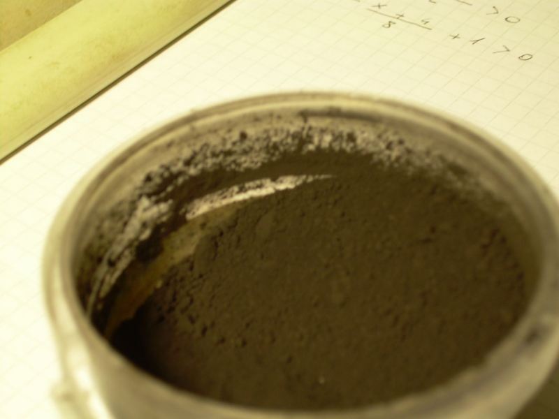

I've tried to make thermite, using a VERY fine aluminium powder (unknow mesh) and an similary fine iron oxide powder. Those materials come from painting industry and I think too fine to made thermite.
I've mixed it with a 1/3 weight ratio for Al/oxide (it's Stoichiometric ratio) and ignited with a magnesium wire.
The mix ignite and burn but producing just some brown dust, not melted iron, as expected.
Maybe the aluminium/oxide dust are too fine ?
What about your experience ?
Attach some image
Dscn0286.jpg - 37kB Dscn0287.jpg - 36kB Dscn0288.jpg - 31kB Dscn0289.jpg - 37kB

smaller size of particles better and faster they react..

Seems like it's burning so fast that the reagents are thrown around before they can react.
Your Aluminium seems to be "Aluminium Bright".
IMHO it's to fine to make thermite, it burns to fast.
You should use atomized or granulated aluminium >100µm.

Your aluminium looks like pretty fine flake, which is really reactive. I remember making thermite the first time with ballmilled Iron oxide and 600 mesh flake Al, it behaved more like flashpowder than regular thermite. :) 50 micron, spherical (Atomized) aluminum gives much better results...

Wrong iron oxide. I've seen three types; black, red, and yellow. Black and red works in thermite. Yellow doesn't. All it's good for is a nice tan color in your concrete stain.

Using the red type. It's fairly fine already, not on the level of powder but more like extremely small granules/crystals. Difficult, but not impossible to grind into powder with a mortar and pestle.
(I was using a yellowish-orange type before, thanks for letting me know.)

i know this type of aluminium, aluminium bright as stated earlier.. it has a sweet smell (or well usually)
its pretty much around 325 mesh
it cannot be too fine to react.. trust me
the wax coating on the aluminium can be the problem and you need to start the reaction perhaps at the core, also using too little thermite might ruin it all aswell

I suggest that you grind your Fe2O3 if it's granular. You could ball mill it if you have one. How fine is your aluminium? And is it coated or not? Thermite with Al over 50 micron is quite hard to light but it should be possible with both magnesium ribbon and Al/S mixture.

Fe2O3: Reagent grade, Caroline Labs (don't recall exact name), dark red granular powder
