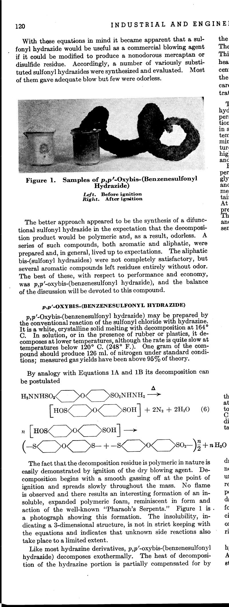

A Snake your mother never told you about
p,p'-Oxybis-(benzenesulfonyl hydrazide)
Industrial and Engineering Chemistry 44 [1] 120.
January 1952
Benzensulfonyl-Smake.jpg - 766kB
