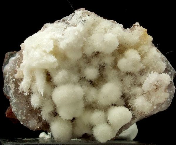

Hello,
I recently acquired several rocks containing Aragonite. Aragonite is a specific crystallized form of calcium carbonate (CaCO3) and a close cousin to
Calcite. I thought it would be interesting, as an experiment, to try to separate the CaCO3 from the surrounding rock. I will accept all tips on
separation, purification, and things to do with calcium carbonate.
Yes, I know CaCO3 is cheap and readily available! Currently this is my only source of CaCO3.
More info on Aragonite:
http://en.wikipedia.org/wiki/Aragonite
http://www.mindat.org/min-307.html

To tell you the truth I have no idea what the surrounding rock is. All I know is that it is a grey crumbly rock. If you look closely you can see the
matrix rock in the background of my original picture. I have heard Aragonite forms in metamorphic rocks formed at high pressure and low temperature
(glaucophane shists) and in sedimentary environments.
[Edited on 15-6-2011 by David1Keller]

I started to crush the rocks, but after I got to .5 cm rock size I realized you could just pick out the CaCO3. I ended up with small chunks of about
95% CaCO3, which is good enough for me!
