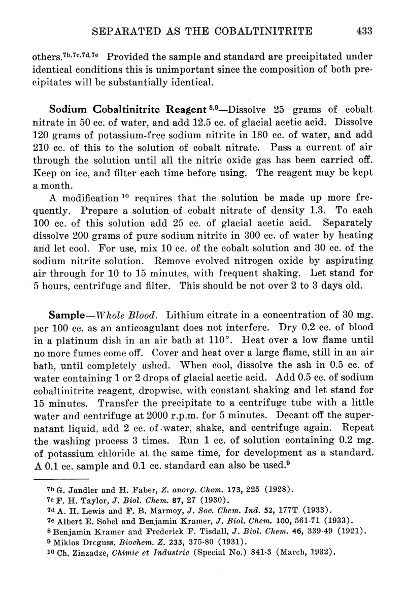

Cobaltinitrite was used by hospital labs in olden times to measure the amount of potassium in blood.
The solution is not stable. It can be stabilized by the addition of a few drops of methanol per liter of solution. Reference in J Chem Ed.
