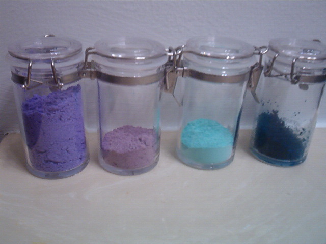

Hello all
I've been playing around with making various copper compounds and have photographed a few so far.
In the photos below I have copper (II) acetate, copper (II) Fluoride, Copper Cyanurate and an amethyst colored copper cyanurate ammonia complex. Does know of any other really neat copper compounds to make. I have also made CuCl2, CuCl, CuI, CuBr2, copper carbonate, hydroxide, and the oxide, I'm thinking about trying to make the trifluoroacetate salt also.
I'm also looking at making potassium Hexafluorocuprate.
IM003250.JPG - 71kB

and how exactly did you make the copper fluoride, HF + copper carbonate?
Yep! I kept adding HF untill the Fizzing stopped and the color of the precipitate changed. I also made this in a plastic container.
I have read that Copper (II) Fluoride can react with potassium fluoride to form Potassium Hexafluorocuprate. Which I shall be trying to make sometime soon now.

I made the Copper Cyanurate/ ammonia complex by reacting copper carbonate with ammonia to form the tetraamine complex; then powdered cyanuric acid was added. The complex can also be made from Copper Tetraamine sulfate and cyanuric acid but it doesn't seem to work as well.

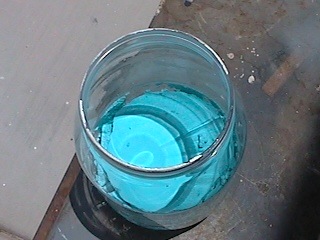

Here is some Copper Phosphate, made by mixing correct molar proportions ofCuSO4.5H2O and Na3PO4. It forms a very pretty turquoise precipitate, but doesn't settle out. I let the jar sit for a few days and siphoned off the supernatant , and added fresh distilled water and mixed. I repeated this over 4 times. The final mass is very light, and was allowed to air dry slowly by covering the plastic jar mouth with a paper towel and a rubber band.
The material was to prepare an artificial turquoise when mixed with AlPO4, but other projects took over. What would be the best way to make a soluble Aluminum salt from household materials. I don't have access to Alum, which would be convenient.
CopperPhosphate1_2.jpg - 31kB
I have some TSP I might have to try making Copper (II) Phosphate.

[*] posted on 31-5-2011 at 20:18
THat copper phosphate is pretty!
