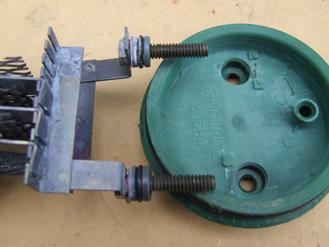

Yeah, that sounds about right. Here's how they do it on the commercial units:
![Chlorinator.jpg - 62kB](http://www.sciencemadness.org/talk/files.php?pid=207940&aid=13756)
I've used this same procedure for chlorate cells (a far more hostile environment) and never had any problems. Note the "O" ring is fitted around a
small piece of PVC (grey colour) which is screwed and "lok-tited" onto the bolt. The PVC - "O"-ring assembly fits into the counter-bore on the inside
of the lid. This may be more sophisticated than you may need (at least initially).
