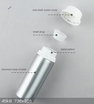

so, with radical scavengers such as BHT, or perhaps hydroquinone? you can pretty much keep the ether peroxide at bay. what is tricky is storing it, but there are some tricks i have found.
On aliexpress there are these things called "leak proof essential oil bottles", its an aluminum cannister with a very firm push-insert plug of sorts, followed by a PP screw cap, its the same bottle youll find high-end or just especially noxious epoxy/fiberglass resins come in. this combination provides a pressure-tight seal preventing ether from escaping.
if you buy 10 at a time or more they can get rather cheap, i think i paid no more than $3 or 4ea for the 250ml ones.
Otherwise, a close second is cheap "fuel bottles" which i dont really understand, their application is camping, and they connect to gas stoves, but, they are meant to contain gasoline? certainly not butane/LPG, i dont know. but they have a screw cap with a rudimentary gasket and while they leak enough vapor to smell, they barely lose a gram of mass per month if you use teflon tape to improve the seal. ether and DCM however soften the cap so you want to be rather conservative with how often you use it. i dont use them anymore except for long term storage of my DCM.
Ether is very difficult to keep contained, and if even a trace is escaping you pretty much cannot refrigerate it at all then, through various mechanisms, it causes refrigerators to blow up.
what i have heard is the ether condenses on icy coils, where it oxidizes and can form ether peroxide, eventually resulting in combustion, though its the fumes that fill the fridge that actually do the damage, the ether peroxide on the dry evaporator coil ice just potentially provides some form of ignition eventually, assuming this fridge doesnt have the thermostat inside the cooling compartment. especially small bar fridges, will have the thermostat inside, resulting in there being a periodic arc as the contacts connect.
My workaround has been to simply keep my bottles which barely leak as it is, inside a 12v peltier cooler with no fans or anything, the lid is super leaky and moisture is constantly flushing any residues out as it dissolves into condensation, which can drain away. its inefficient but i dont lose any tangible amount of ether even during 40C days, and i can keep it outside of the house too. though the place i keep it could be defined as a barn i suppose, or car shed, which is why the sweet-water that dribbles on the ground doesnt make a smell. indoors in an enclosed space it could be a problem. During winter the fridge doesnt need to run at all so i leave it open and off, but spring and summer, i think my bottles would explode. without cooling i had the issue of ether just freely boiling if i opened the bottle.
Note: ether diffuses rapidly through teflon and silicone, the more of either you use, like, the thicker it is, the worse diffusive leakeage becomes.

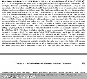

Ether purfication
See the attached graphic

[*] posted on 29-3-2025 at 03:14
oh i need to try that, my ether contains something, and if aldehydes for example dont just distill out normally, or wash out with water, i would assume that means they are quite difficult to remove by any means of seperation.
How reliable would permanganate be for this? like to totally eliminate, if that fails ill try that copper-zinc stuff. Some of my ether comes through the reactor with this strong odor attached that no amount of distillation can cure, nor soaking with acid, base, charcoal or just water. i thought it was some polymer of some kind which is why it could have virtually identical physical properties, based on something i read somewhere
