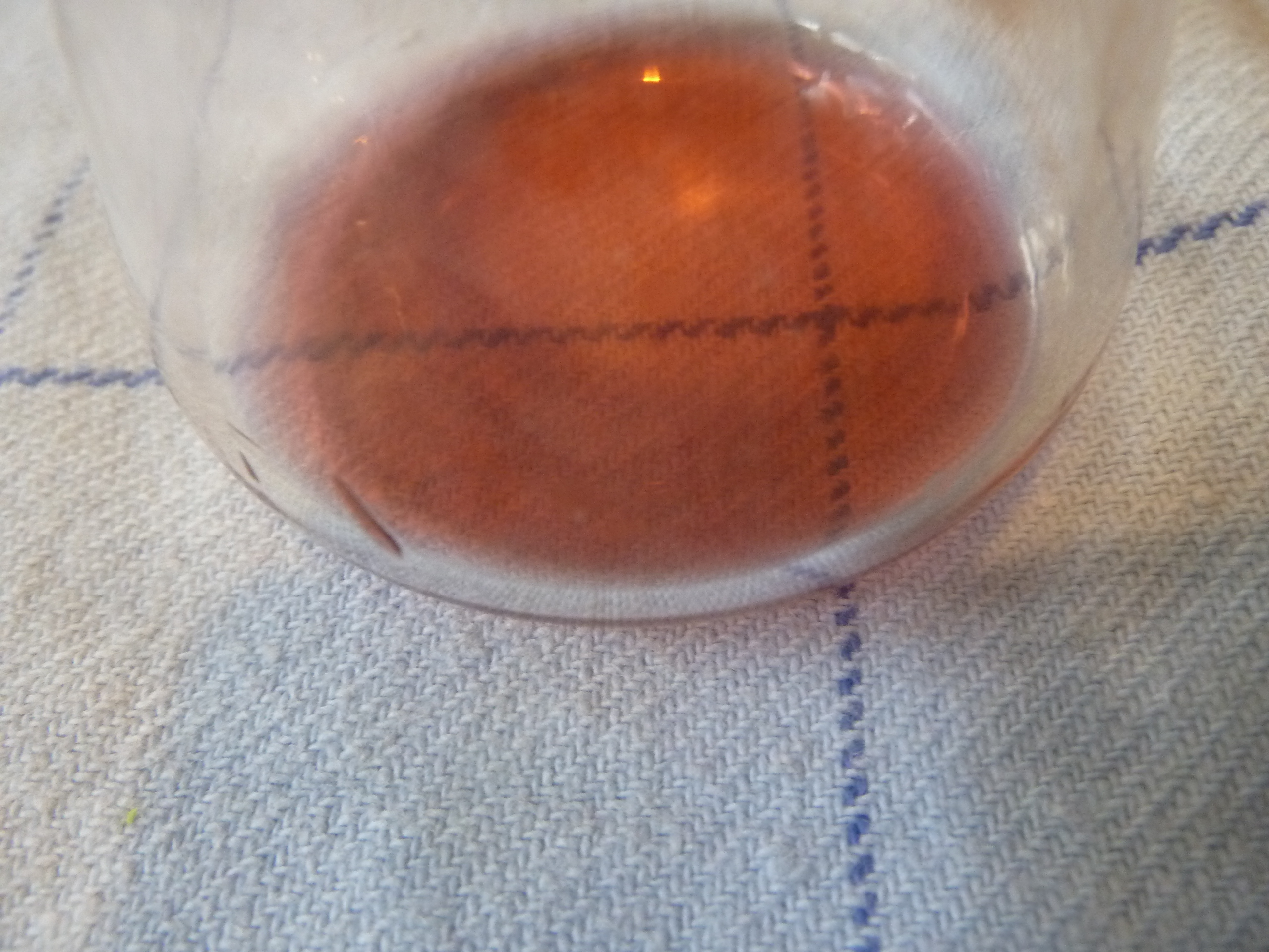

[*] posted on 20-3-2025 at 15:03

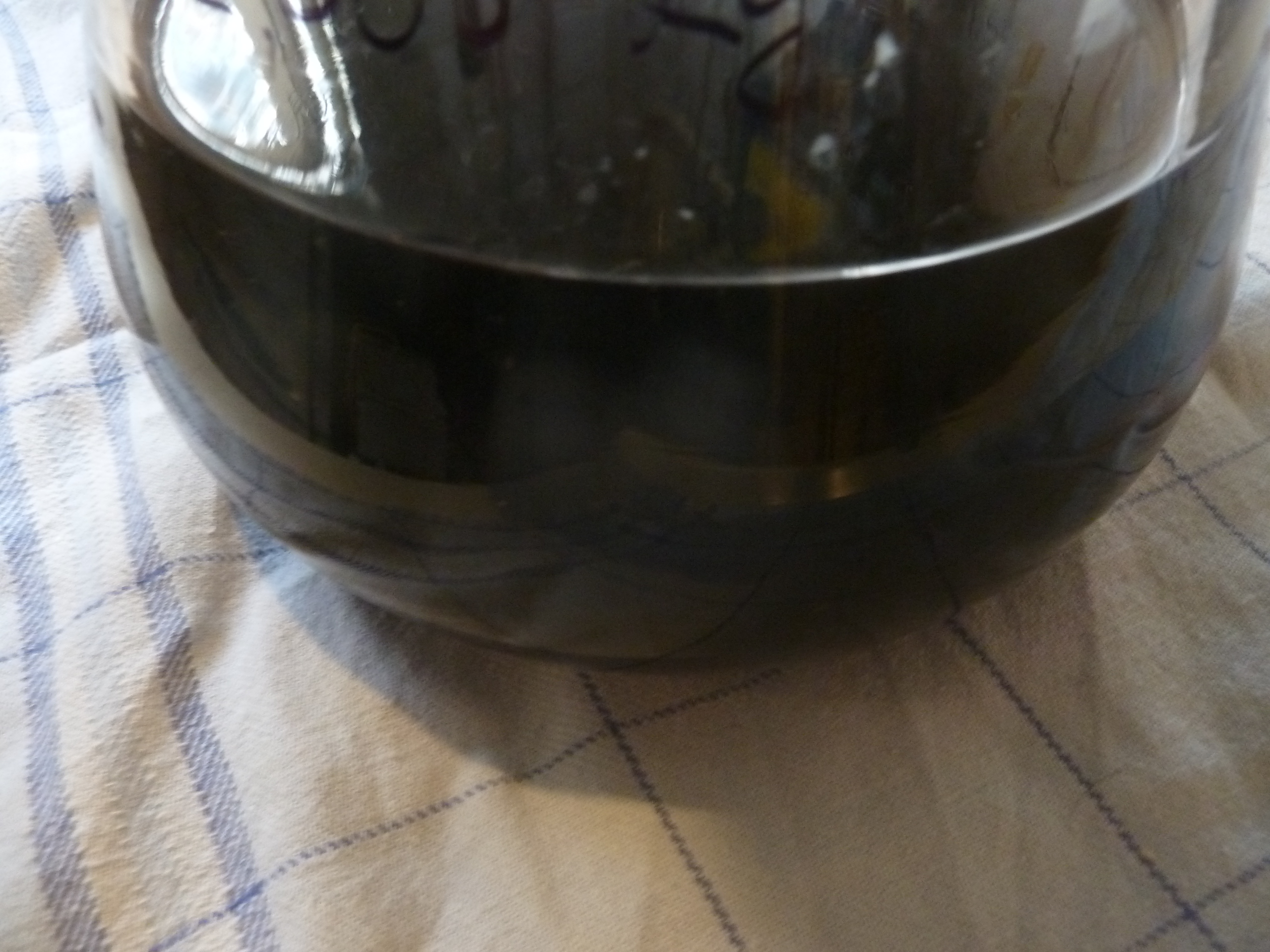

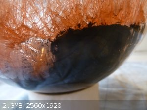

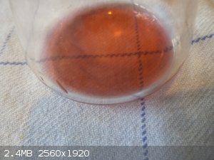

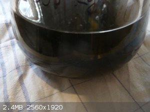

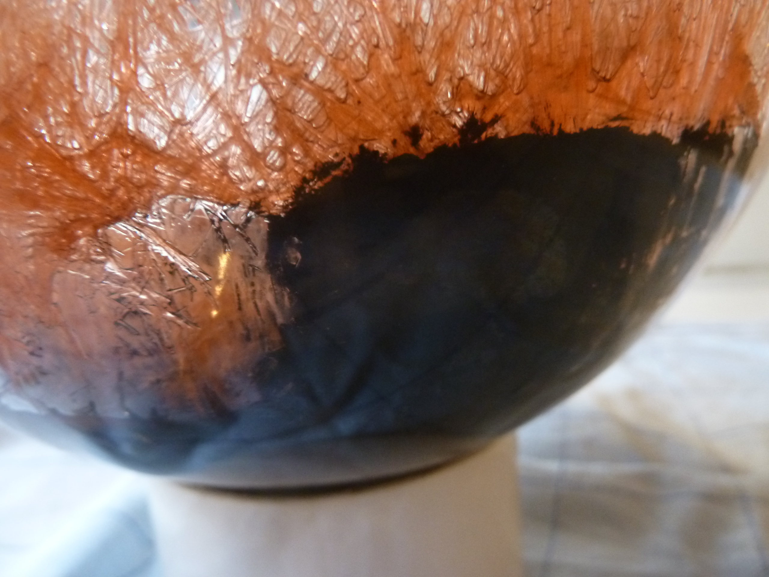

Update
After about two days refluxing and cooling down to room temperature (which is at the moment between 8 and 10 degree centigrade) the undissolved black cobalt oxide settled down followed by crystallization of assumed cobalt perchlorate as long needles.
The supernatant solution is really dark red, almost black, with a tingle salmon to brown colored. Even a thin layer is intensely colored.
After suction filtration I´ve recovered about 260 gram Cobalt oxide, that means about 90 gram went into solution. But the cobalt oxide is still not completely dry, so maybe a few grams more went into solution.
I´ve placed the filtrate in the freezer for several hours which lead to additional crystallization of long needles. Tomorrow I´ll filtrate the cystals and try to dry it . It seems that the dissolved cobalt perchlorate has a much more intense coloration compared to the needle-shaped crystals.
Then I intend to reduce the volume of the filtrate under reduced pressure (vacuum distillation) and put it in the freezer again to get a second crop of crystals.
I do not dare to evaporate to complete dryness. Cobalt perchlorate hexahydrate is heat-sensitive and I doubt that I could get it dry without at least partial decomposition. There must be a large quantity of unreacted perchloric acid in the solution. The complete separation without partial decomposition is the next challenge for me.

Posts: 8079
[*] posted on 21-3-2025 at 00:34
Good to see that you get some cobalt(II) perchlorate from your oxide. It does dissolve, but you need a lot of patience. I did not have that patience, when I experimented with Co3O4 ;-)
I would not worry too much about decomposition of the cobalt perchlorate on drying. Perchlorate ion really is stable, certainly up to 100 degrees. Only covalent perchlorates (anhydrous acid, organic esters) are prone to decomposition, or even explosion. But if you dry your material at 50 C or so, you'll never get anhydrous acid (the acid forms an azeotrope with water at 72%, which boils a little over 200 C).
Another mode of decomposition is possible at elevated temperature, and that is internal hydrolysis. If you heat it too much, then water of crystallization will combine with perchlorate ion, giving free azeotropic acid, leaving a basic salt behind (mixed perchlorate/hydroxide/oxide). I myself once had this, when making copper nitrate. On heating, the deep blue solid turned lighter blue/green and the dry powder was insoluble in water, it was something like Cu(OH)NO3. Water and HNO3 vapor boiled off. In your case, with perchloric acid, this is less likely to happen, because the azeotrope boils well over 200 C, so if you keep the temperature lower than 100 C, no acid will boil off. At reduced pressure, some acid may boil off and then the combination of heating and reduced pressure may lead to internal hydrolysis.

The first crystallization crop was about 140 gram (wet crystals as I didn´t know how to remove better than with suction filtration). Then the still dark red (but not black) filtrate was vacuum distilled to concentrate it. About 500 ml ( almost pure water ) was distilled off in the temperature range 20 - 40 degree centigrade. At the end of the distillation suddenly crystals appeared in the still hot RBF.
Cobalt perchlorate seems to possess a much lower solubility in azeotropic perchloric acid than in dilute (about 40 %) perchloric acid.
Then the RBF was placed in a freezer over-night and next day I got a whooping scond crop (more than 300 gram after suction filtration, also still wet with perchloric acid). Now the filtrate was only pale red, indicates that most of the cobalt perchlorate crystallized out and only a minor quantitiy remained in solution.
Again, the filtrate was vacuum distilled for further concentration and a possible thirth crop of crystals. The vacuum distillation temperature for the azeotropic acid was between 105 and 106 degree centigrade.
The distilled perchloric acid wasn´t colorless but pale yellow with a distinct smell resembling a mixture of chlorine and bleach.
Some crystals appeared at the end of the distillation in the still hot RBF, but the quantity is much much lower. I doubt that it is more than a few gram.
The RBF is now in the freezer and I´ll perform suction filtration next week.
Two problems are still waiting for a solution:
1.) How can I purify the perchloric acid to remove the pale yellow color ? Vacuum distillation doesn´t help.
2.) How can I remove the perchloric acid from the wet crystals? I doubt that the perchloric acid is volatile enough at room temperature. It´s even more likely that the perchloric acid is hygroscopic.
Normally, I would flush the crystals, but I can´t use water (highly soluble) nor can I use alcohol (explosive mix with perchloric acid) or any other solvent I can think about.
Ideas/suggestions?

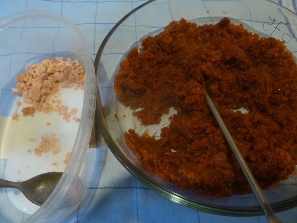

[*] posted on 25-3-2025 at 02:02

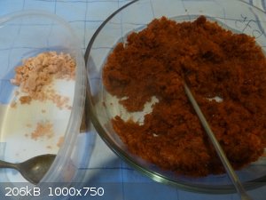

Thirth batch different
Today I worked the very small thirth batch up. It´s obviously different to the first two batches, much lighter in color.
See attached jpeg.
It´s just speculation, but could it be some cobalt chloride , chlorate, hypochlorite or the like?
If you prepare, for example, silver perchlorate by heating of a silver compound with concentrated perchloric acid, some silver chloride is formed as a by-product.
So my guess is that some cobalt chloride is formed as a by-product.
And, by the way, the combined first two batches (right part of the jpeg) attracted moisture from the air.
The adherent perchloric acid is no longer azeotropic, considerably diluted. So I think about a different way to remove the perchloric acid, dissolve in distilled water and crash it out of solution with plenty amounts of IPA. Wikipedia states that cobalt perchlorate is insoluble in ethanol. Therefore a higher alcohol with a longer unpolar carbon chain should further reduce the solubility, even if water is present in the mixture.
I´ll perform a small scale test with appropriate safety precautions (kevlar gloves, face shield, safety goggles etc.). I doubt that dilute perchloric acid (below azeotrope) is as dangerous as concentrated or even anhydrous acid, but I´m not sure.
Cobalt salts.jpg - 206kB
Posts: 8079
[*] posted on 25-3-2025 at 02:28
Diluted acid will not lead to explosion with organics. I have mistreated dilute perchloric acid with lots of organics and even made solid salts of them (e.g. all kinds of amine-HClO4 salts).
As long as the perchlorate ion is present as ion and temperatures remain below 60 C or so, you're pretty safe.
Osmiridium
