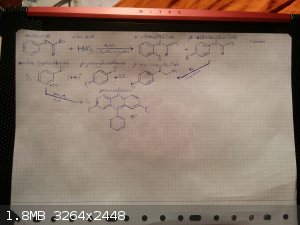

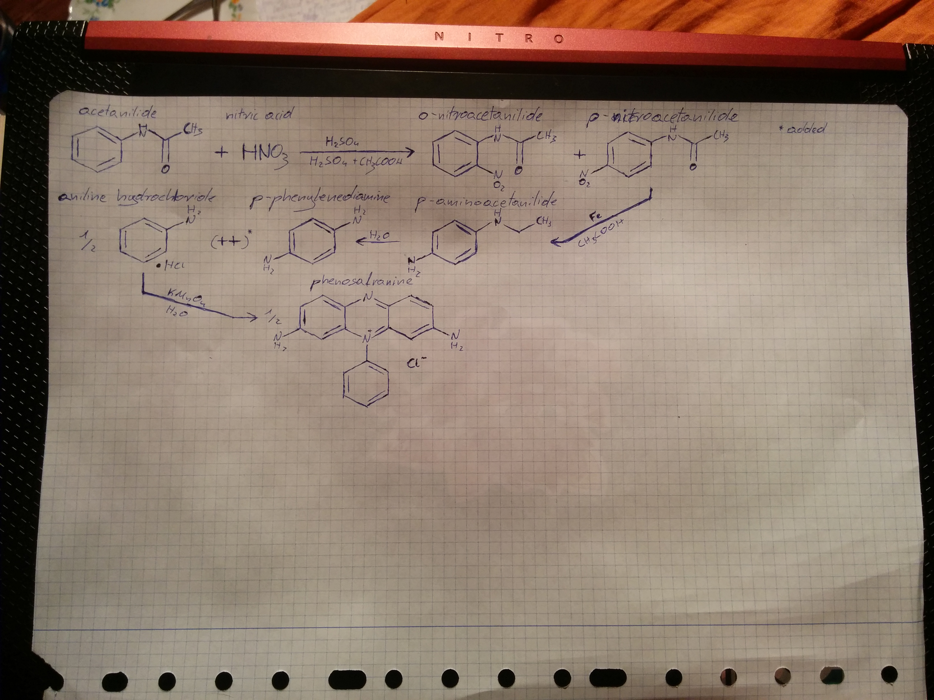

[*] posted on 26-2-2025 at 17:56
Phenosafranine synthesis and desensitization of panchromatic film
Heya! Below this message I attached an image of a ~probably correct~ synthesis of probably the simplest to make photographic desensitizer. As you can see, most of the path is just making 4-phenylenediamine which is a developer, so if you have it on hand feel free to go ahead with it. Desensitification can be achieved with concentrations as low as 0.005%, so you don't need much, and it can be used as a prewash or in the developer itself. As for the effects, it allows you to work on panchromatic emulsions on film and glass under normal darkroom light, so it can come pretty handy when you were shooting by feel ;)

Looks like a straightforward synthesis. For academic purposes, do you know how the o- and p- nitroacetanilides are separated, @NotANumber? It seems like this could present some problems, though I don't have experience with this.
I thought of a possible route to p-phenylenediamine with terephthalic acid (from PET plastic) as the starting material:
  1. Neutralization to the ammonium salt;
  2. thermolysis to the amide;
  3. Hoffmann rearrangement to the diamine. (Can NaOCl be used?)
I'd certainly like to know some thoughts of more experienced chemists on the viability and issues with this route.

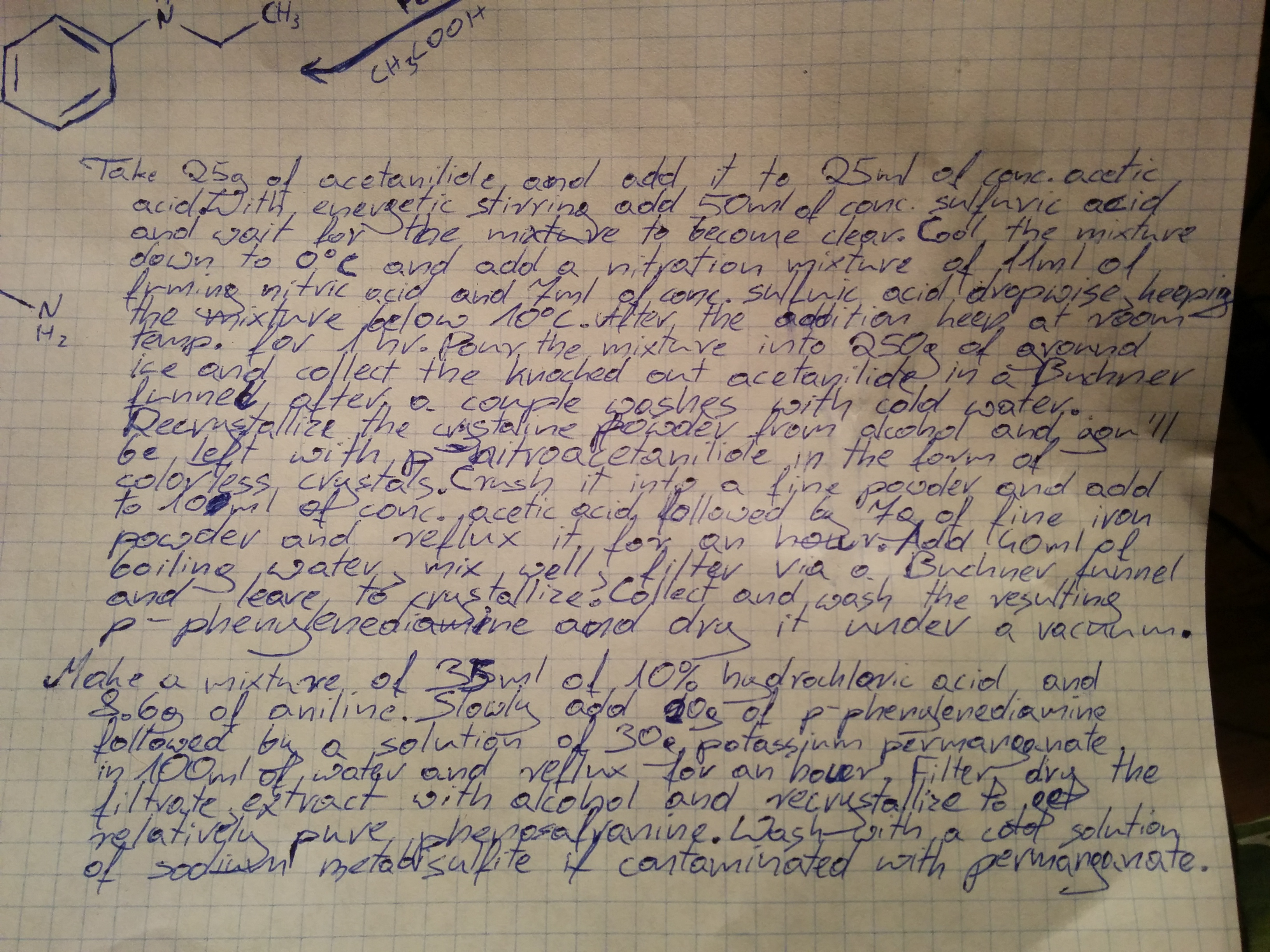

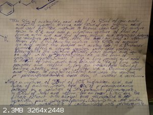

They're separated pretty easily as o-nitroacetanilide is insoluble in alcohol :]
I took some time to write down the entire procedure, the second paragraph is theoretical for now, the first one is from two procedures given by Vogel

[*] posted on 28-2-2025 at 19:51
It's unclear to me how you are planning to get from the 4-nitroacetanilide to p-phenylenediamine. In your drawn out plan, you show 4-nitroacetanilide being reduced with iron to 4-amino-N-ethylaniline, then reacting that with water to yield p-phenylenediamine. Neither of those reactions should happen.
Iron reduction of 4-nitroacetanilide should yield 4-aminoacetanilide. The amide will not be reduced. And the reduction may take more than an hour, as those heterogeneous metal reactions can vary in rate depending on the quality and surface area of your metal. It would be best to follow by TLC to determine when the reaction is complete, rather than assuming it's done after an hour. From there, you should be able to hydrolyze the amide by refluxing in aqueous HCl.

[*] posted on 2-3-2025 at 11:44
Thank you a lot for the input. I'm still a beginner and to be honest access to proper chemical education isn't too easy, so mainly I'm scrambling for pieces of information I can find on the internet or on my bookshelf. The procedure of making 4-phenylenediamine from 4-nitroacetanilide was merely mentioned by Vogel so I tried to find what I could. None of the sources I found mentioned reaction times so I came up with an estimate I could extend as I go. Unfortunately I don't have access to TLC plates, being pretty much jobless so I'd have to come up with something else to track the reaction, probably taking a sample and using a biurette to test for amine groups. As for the hydrolysys my teachers in the past decided to completely skip the topic and any of the books I have merely mentioned it as reacting a substance with water, and not having anyone to ask I took it at face value. Also I forgot to draw one oxygen, my bad, I was drawing it out at 5am :c
