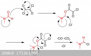

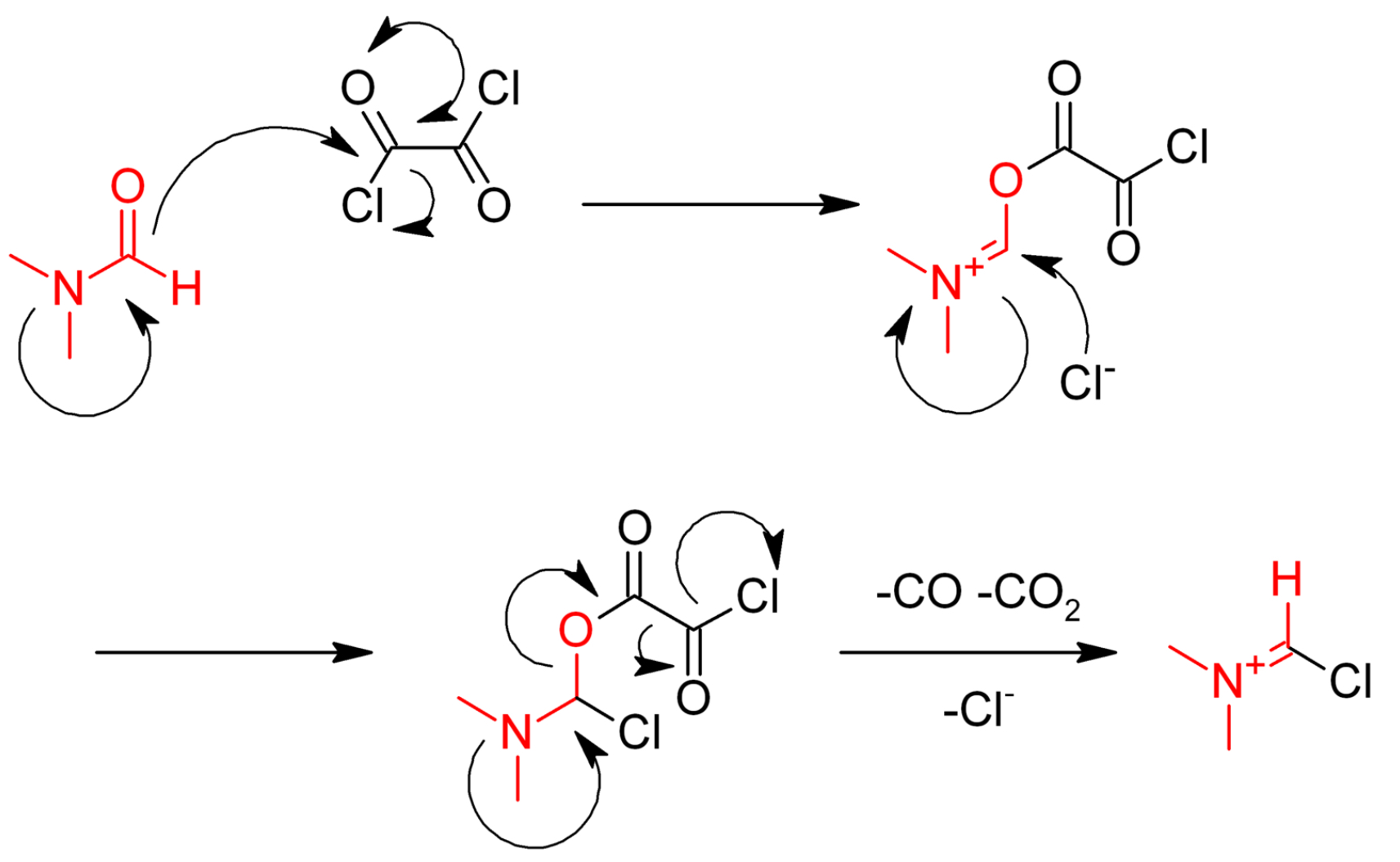

Quote: Originally posted by davidfetter
Do we have some idea of how this catalytic cycle works, or is it a thing people have noticed but don't yet have a mechanistic explanation for?
The mechanism first proceeds by formation of a Vilsmeier reagent in either case.
With oxalyl chloride:
IMG_8484.jpeg - 208kB

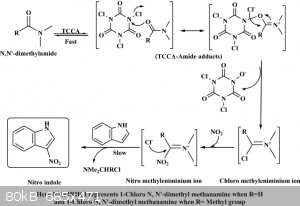

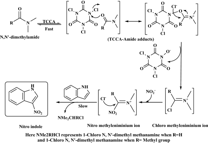

With TCCA (according to https://link.springer.com/article/10.1007/s42452-019-1023-1):
IMG_8486.png - 80kB

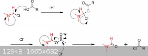

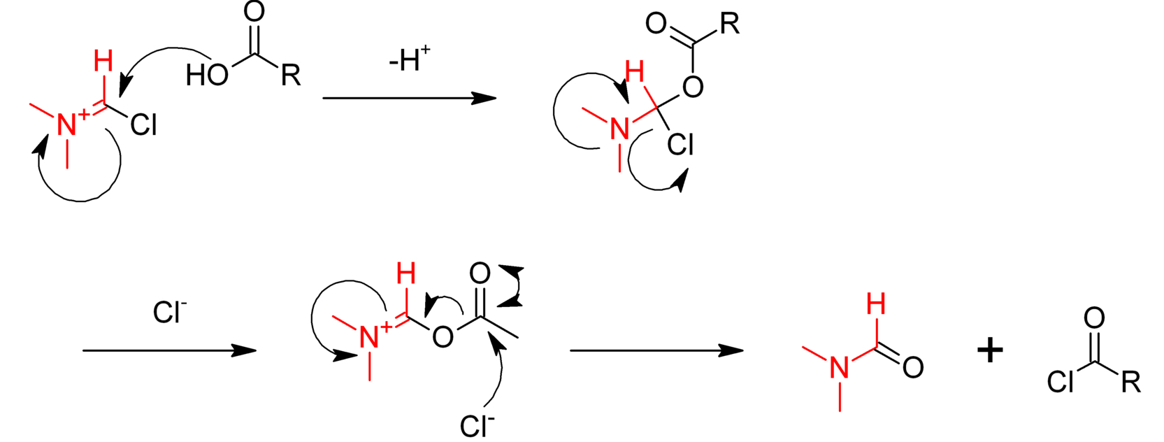

Which can then chlorinate the carboxylic acid regenerating the DMF:
IMG_8485.jpeg - 129kB
