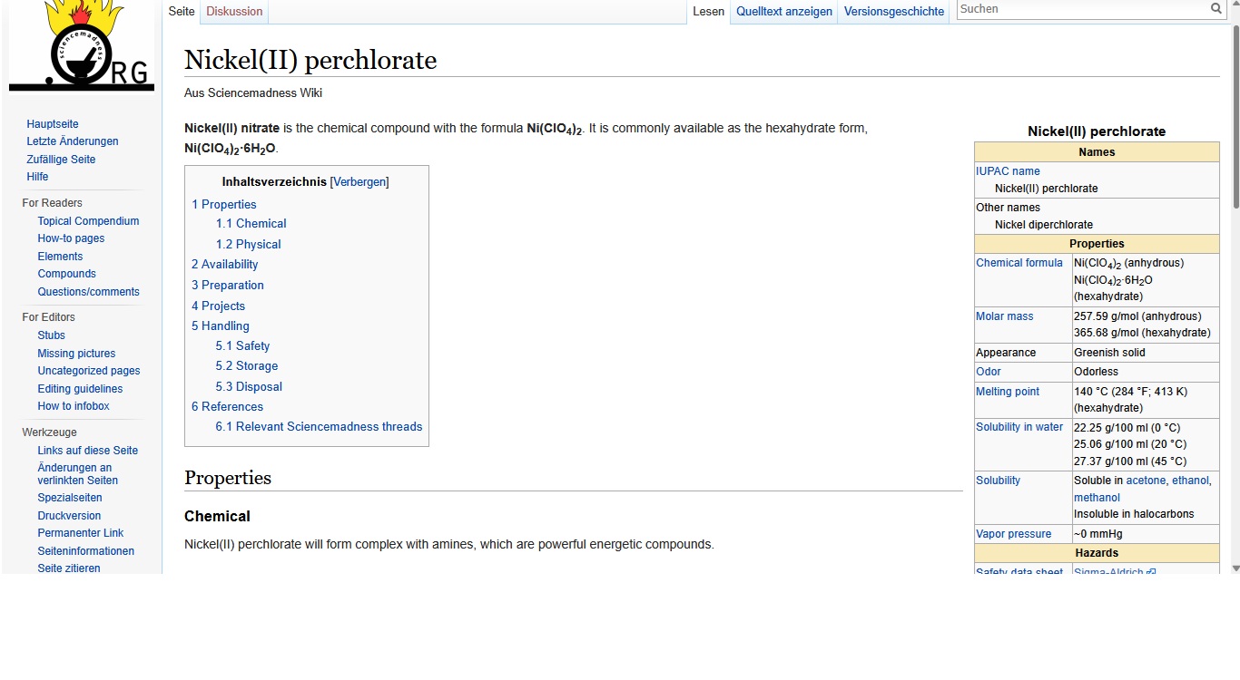

@woelen I think there´re some typos in the corresponding sciencemadness wiki article, see attached screenshot.
"Nickel(II) nitrate is the chemical compound with the formula Ni(ClO4)2."
I doubt that the solubility data is correct. From my experience, a nickel perchlorate solution with a concentration of more than 60% by weight is possible even at 7 degree centigrade. So even if the solubility is calculated as the anhydrous salt , it´s too low.
Wiki entry.jpg - 201kB

Nickel perchlorate is extremely soluble in water. I have a wet slurry of nickel perchlorate 6-hydrate. It is a wet mass of green crystals under a layer of dark green solution. Never tried to dry it further, I only use this stuff in aqueous solution, so no need to first dry it.
It is good that you used excess nickel oxide. You don't want excess acid in the solution. But even with the excess nickel oxide, I can imagine that the solution still is quite acidic. You could try testing it with pH-paper, or with a little solid NaHCO3.

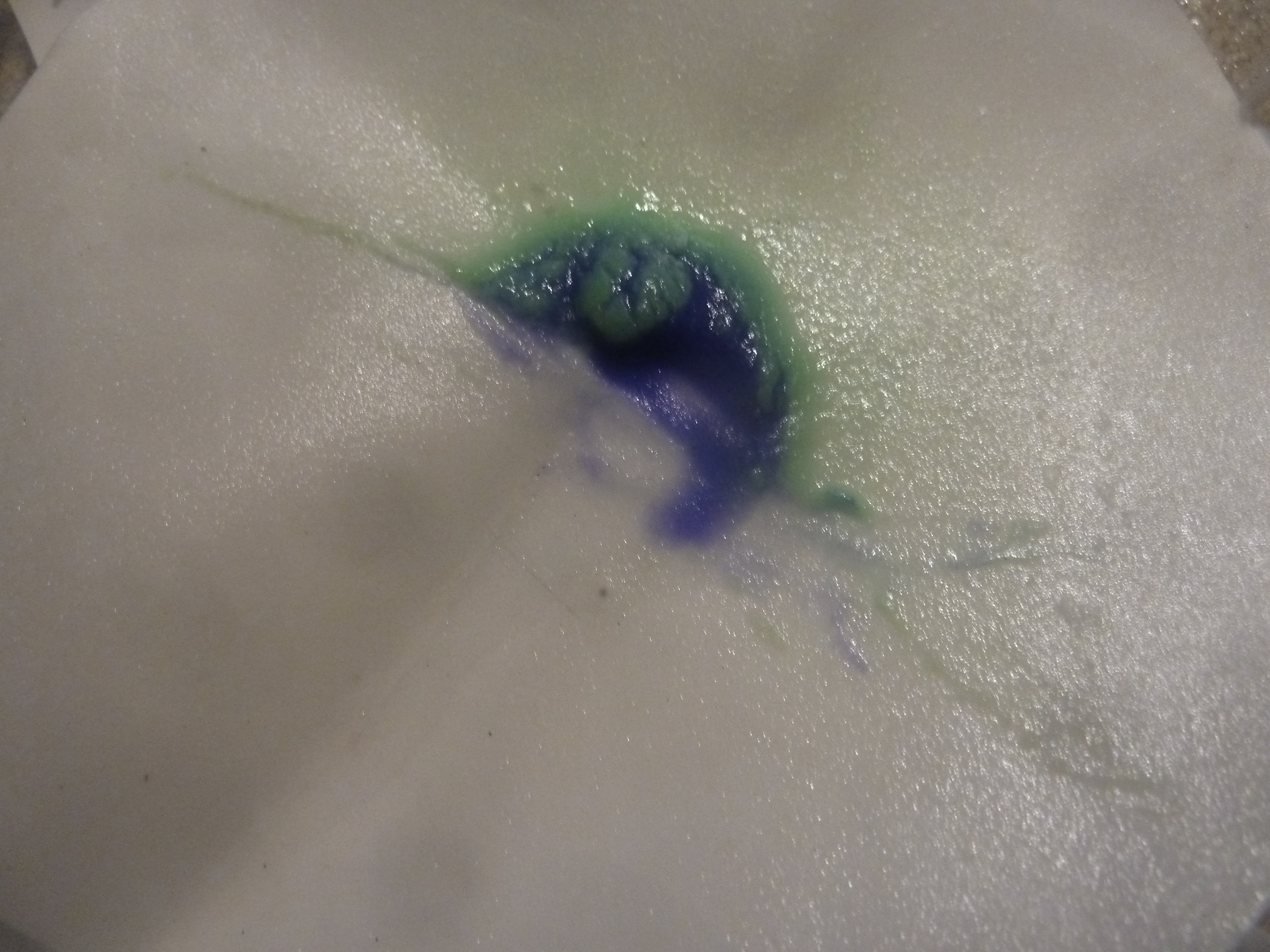

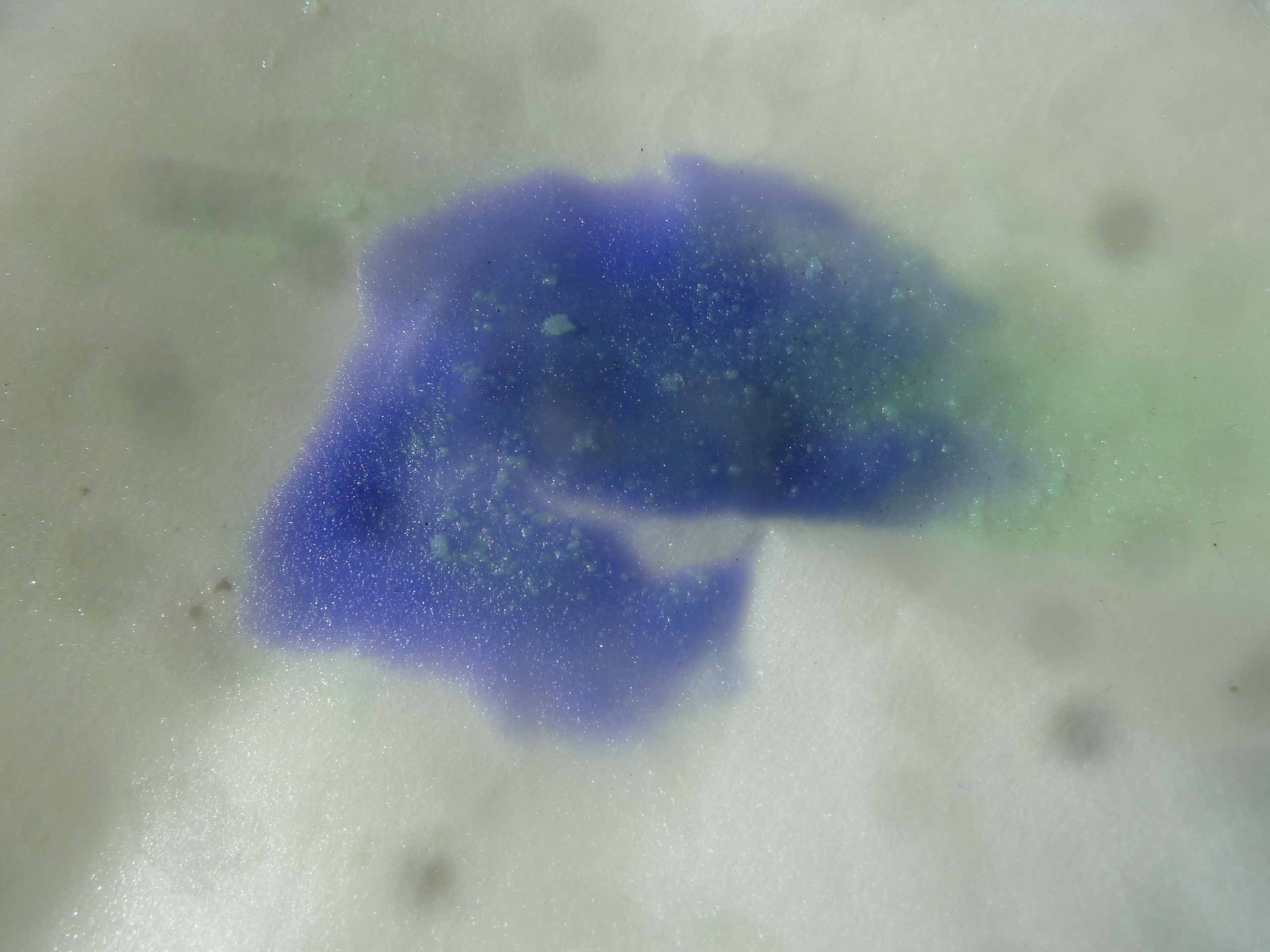

By the way, do you know if the hexammine complex of nickel perchlorate is labile? I´ve dissolved the residue of my nickel perchlorate in the bowl and glassware with several milliliter distilled water and added excess 25 % ammonia water. Immediately a deep blue complex precipitated out and was filtered yesterday in the evening, followed by washing with distilled water (no more ammonia smell was detectable) and I let it stand outside in the cold.
Today the precipitate wasn´t dry (that´s no surprise as the temperature outside was somewhat below zero degree centigrade), but it was partially discolored back to greenish.
See attached jpeg.
I also noticed some weak ammonia smell.
Is it possible that it loses some ammonia? I have no other explanation for this oberservation. I guess (pure speculation!) that the ammonia loss was only partially, not completely, because otherwise the extremely soluble nickel perchlorate probably wouldn´t precipitate in such a wet environment.
