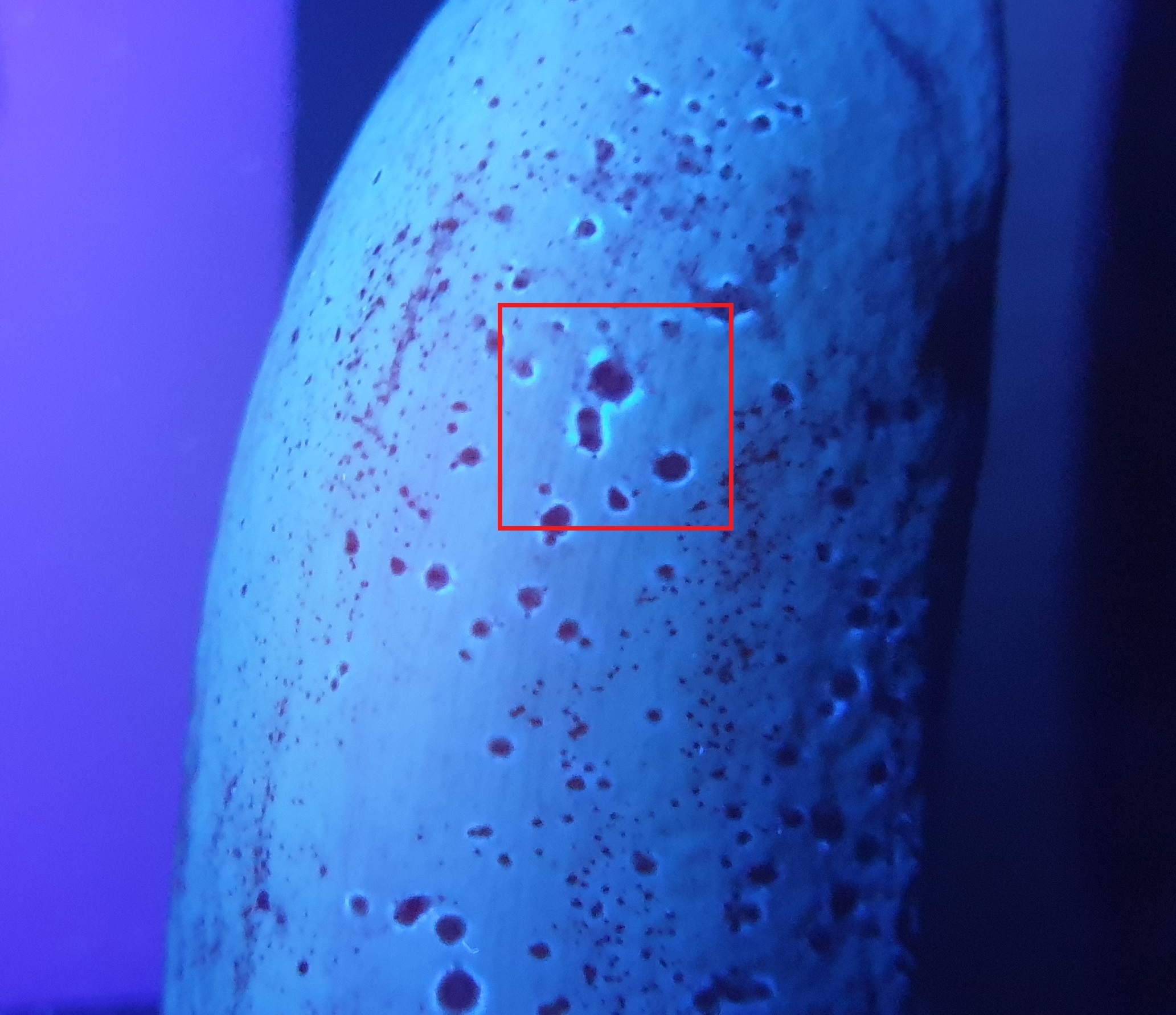

Many of you might know that as bananas overripen, dark spots develop on their skins. Around these spots, a narrow ring of chemical compounds forms, which exhibit fluorescent properties.
I have a couple of questions regarding this phenomenon:
Could these fluorescent compounds be stabilized and stored for future use?
Based on my research, these compounds appear to form as chlorophyll decomposes. If one were to extract chlorophyll from green leaves, would they observe a similar fluorescence effect? Additionally, would the compound be stable enough to store?

20241215_202158.jpg - 864kB

It's hard to say much about stability without knowing what the compound is. If it's an intermediate of the process that forms the spots, and the spots don't fluoresce, it seems like it doesn't survive very long in musa. If you want to accumulate enough raw material to have any hope of extracting a useful quantity (vs. just buying a truckload of bananas all at once) you'll need to find some way to inhibit that reaction because the browning process happily proceeds in a domestic freezer. Maybe try soaking in ascorbic acid before freezing? Honestly, this seems like a big pain :P
Chlorophyll is fluorescent, and you can see a photo of an extract fluorescing on that page. But I'd expect it to be red, not blue as in your photo. As far as stability goes, it's (unsurprisingly) light-sensitive and not known for being especially stable generally, but this paper reports that it can be fairly stable if if purified, crystallized, and stored in the dark.

I was thinking that banana skins might contain a significant amount of the precursor compound that transforms into the fluorescent material during the ripening process. If so, I wondered whether it would be possible to extract this precursor, convert it into the fluorescent substance, and then stabilize it for future use.
Unfortunately, I don’t know the exact identity of the compound responsible for the fluorescence around the dark spots on overripe bananas. From my research, it seems to be a product of chlorophyll breakdown. My guess is that it might be possible to extract this compound using chemical solvents, but of course, consulting experts in the field would be the best approach!

Oh, interesting! That first paper makes it clear that the entire skin is fluorescent, not just the rings. I thought that looked like the case from sarinox's pictures, but the post only mentioned the rings, so I figured it must have just been an artifact of the camera w/ UV light. If the whole skin is fluorescent that sure seems more practical to extract, at least. (Though the second paper looks a bit pessimistic on the prospects of that...)

It's really the whole banana that fluoresces. It is a good way to know if a particular banana is ripe and palatable, although it may seem weird to carry an UV flashlight and point it to bananas in a grocery.
