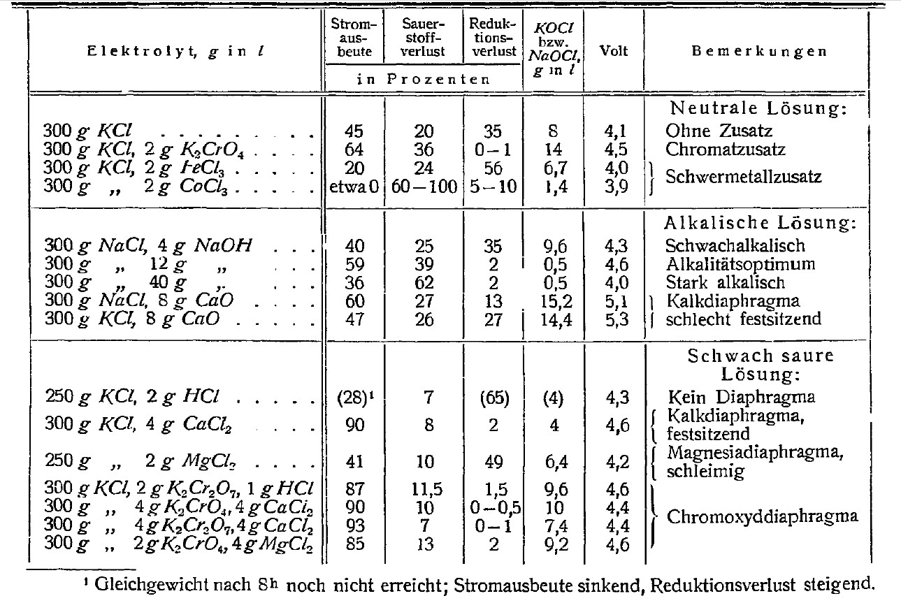

Calcium Hydroxide Diaphram
Hello metalresearcher,
To prevent reduction in a chlorate cell, you can add a little Calcium Chloride to the cell. This will create a Calcium Hydroxide diaphragm on the cathode.
The performance should be as good as Dichromate addition.
I have done this a couple times myself. I add 1g of CaCl2 for each 5cm^2 of cathode area (calculated as one side of the electrode). The cathode I used was titanium mesh, so the CaOH2 formed can grow into the mesh and connect both sides of the electrode. If you use smooth surface sheet metal it might not adhere well - but that I have not tested, so is a guess.
Here a table from some German electrochemical journal I found:
Calcium Hydroxide Diaphragm.jpg - 306kB
The second column which says 'Stromausbeute' translates to current efficiency.
Best Greetings!
P.S.: What I forgot to mention, if you use titanium mesh, make sure it is clean. One time i did this, I used an old piece of mesh which was dirty/oxidized, and the diaphragm did not adhere well.
You can place the cathode in ~20% HCl for half an hour for cleaning before use, that should do the trick.
Most of the diaphragm growth over the course of the 1st day of electrolysis and the whole electrode gets covered in a nice thick layer (~2mm on both sides) of CaOH2.
Voltage-drop for the diaphragm was something ~0,5 volts if remember it correctly - so not bad.
[Edited on 24-2-2025 by Mister Double U]
