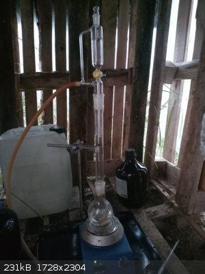

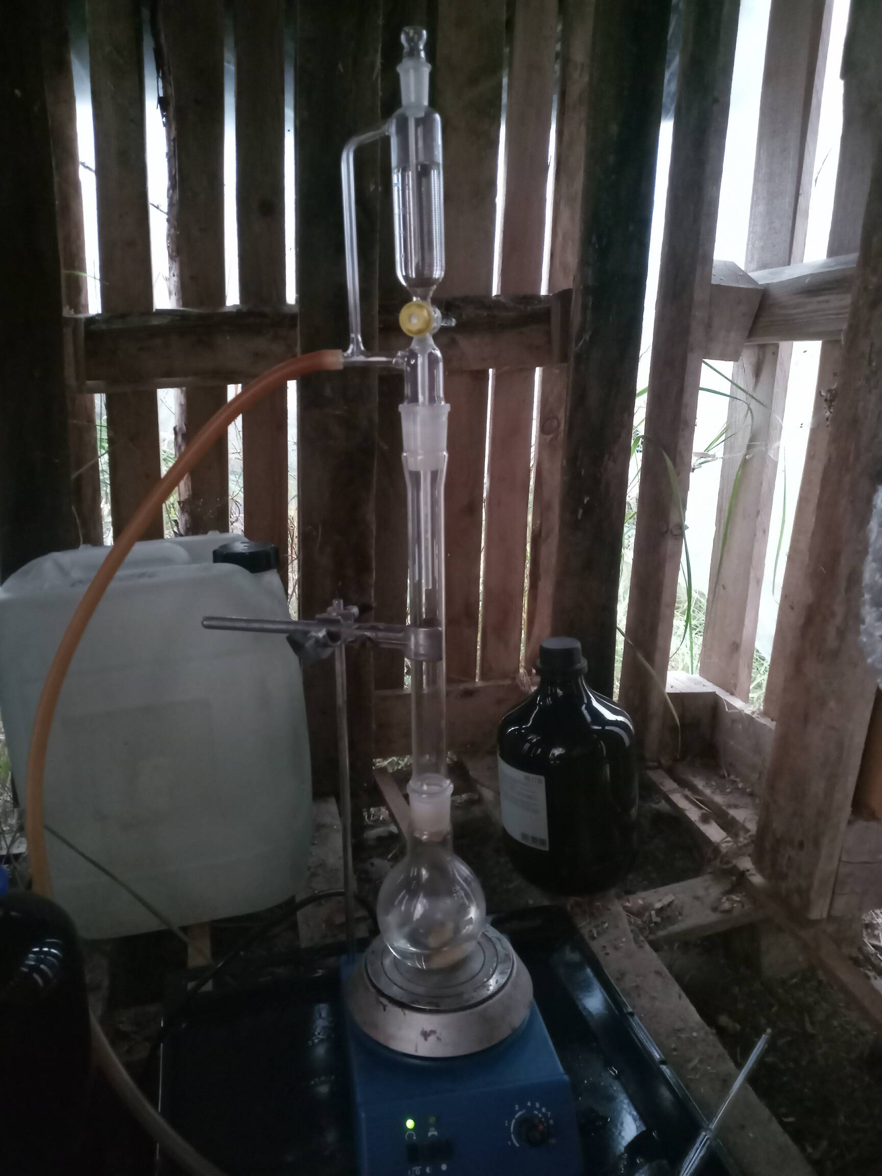

The method was: 0,50 mol of the alcohol was put into 250 ml flat bottomed flask, magnetic stirbar was added, air condenser attached (it was enough because I did the reaction outside during winter time with temperatures -5 to 0 C) and dropping funnel with 45 ml of acetyl chloride (26% excess, very likely only about 2-5 % excess should be enough but my acetyl chloride was quite old with unknown quality after years in plastic barrel and I did not want to redistill this nasty stuff). A hose was connected to the apparatus to lead HCl gas into water trap which was a beaker filled with 100 ml of water into which an inverted funnel was immersed with connected hose. The dropwise addition of acetyl chloride lasted about 1 hour (it could be probably performed faster) at the outside temperature, the reaction flask was quite cold when touching by hand. After all the acetyl chloride was added the reaction was heated until slightly boiling to expell as much HCl as possible and after boiling started the heating was turned off and let to cool down to 0 C outside temperature. 100 g of snow was charged into 500 ml beaker and the reaction was slowly poured onto the snow while stirring (to prevent some HCl and unreacted acetyl chloride hydrolysing to HCl to cause hydrolysis of the ester and then contamination of the product with long chain alcohol). The mixture was transferred into 250 ml separatory funnel, low acidic layer discarded and upper organic layer kept, washed 2x with 100 ml of ice cold water, 2x with 100 ml of 5% NaHCO3, 1x with 100 ml of ice cold water (organic was always the upper layer). Transferred into 250 ml flat bottomed flask, added stirrbar, dried with about 1,0 g of anhydrous Na2SO4 while magnetically stirred for 3 hours the capped flask. Then poured into labeled glass flask for storage.

apparatus and the reaction
IMG_20241122_150209_0.jpg - 231kB

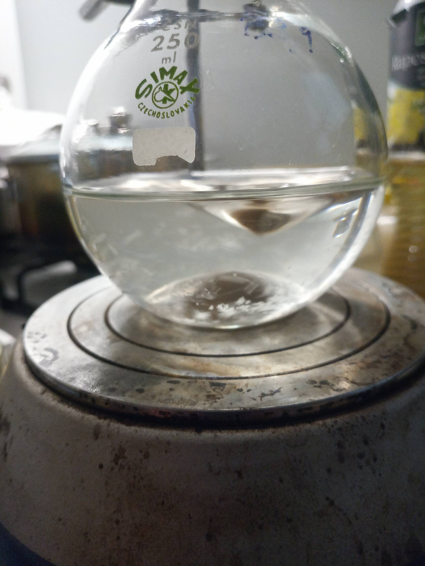

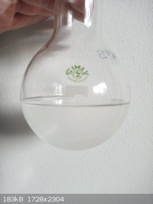

ester after washing
IMG_20241124_153046_1.jpg - 183kB

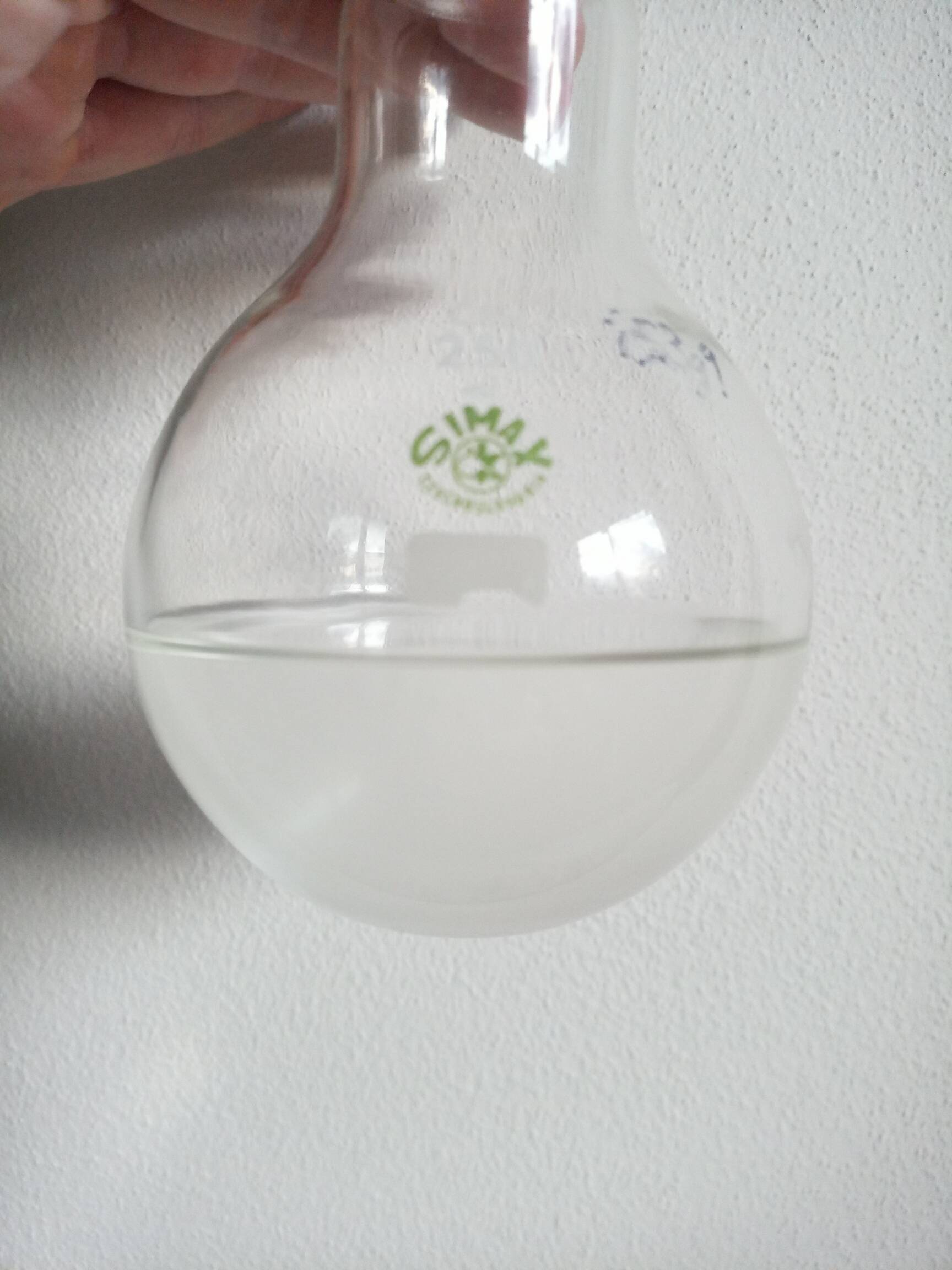

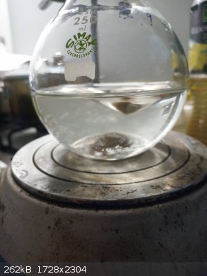

drying ester
IMG_20241124_153423_2.jpg - 262kB
