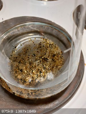

[*] posted on 26-11-2024 at 07:41
I tried silica gel and it works even better.
There is a bit of smell coming from it. Reminscent of new shoes and packaging in general.
20241126_162903.jpg - 875kB
Edit:
The silica gel only worked on the first test. After that the bumping got bad.
