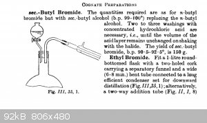

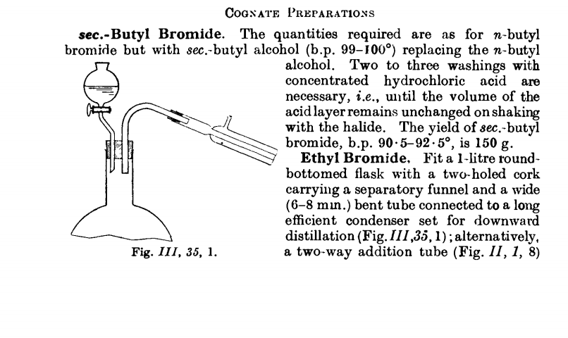

Ah, crap. I have just found the procedure in Vogel's Textbook of Practical Organic Chemistry (in the Library), pages 278-279. My PDF printer is a little sassy today, so I'll attach snapshots of the paragraphs.
If you haven't already read Vogel's, I recommend you do it.
etbr1.png - 92kB etbr2.png - 115kB
Edit: The procedure uses concentrated sulfuric acid. With bisulfate as replacement, it will probably take longer and require reflux. There will be a little ether along with the ethyl bromide, which is not easy to remove since their boiling points differ by 5 °C or so. Just take more care than usual.
