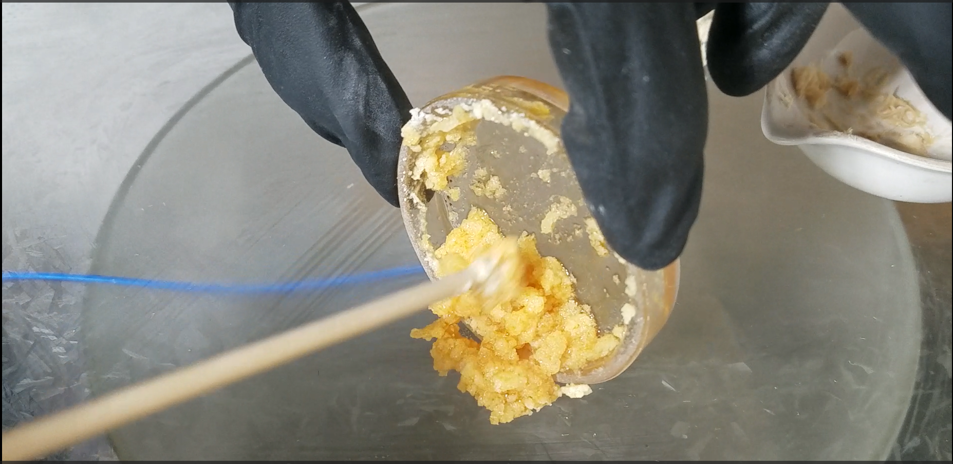

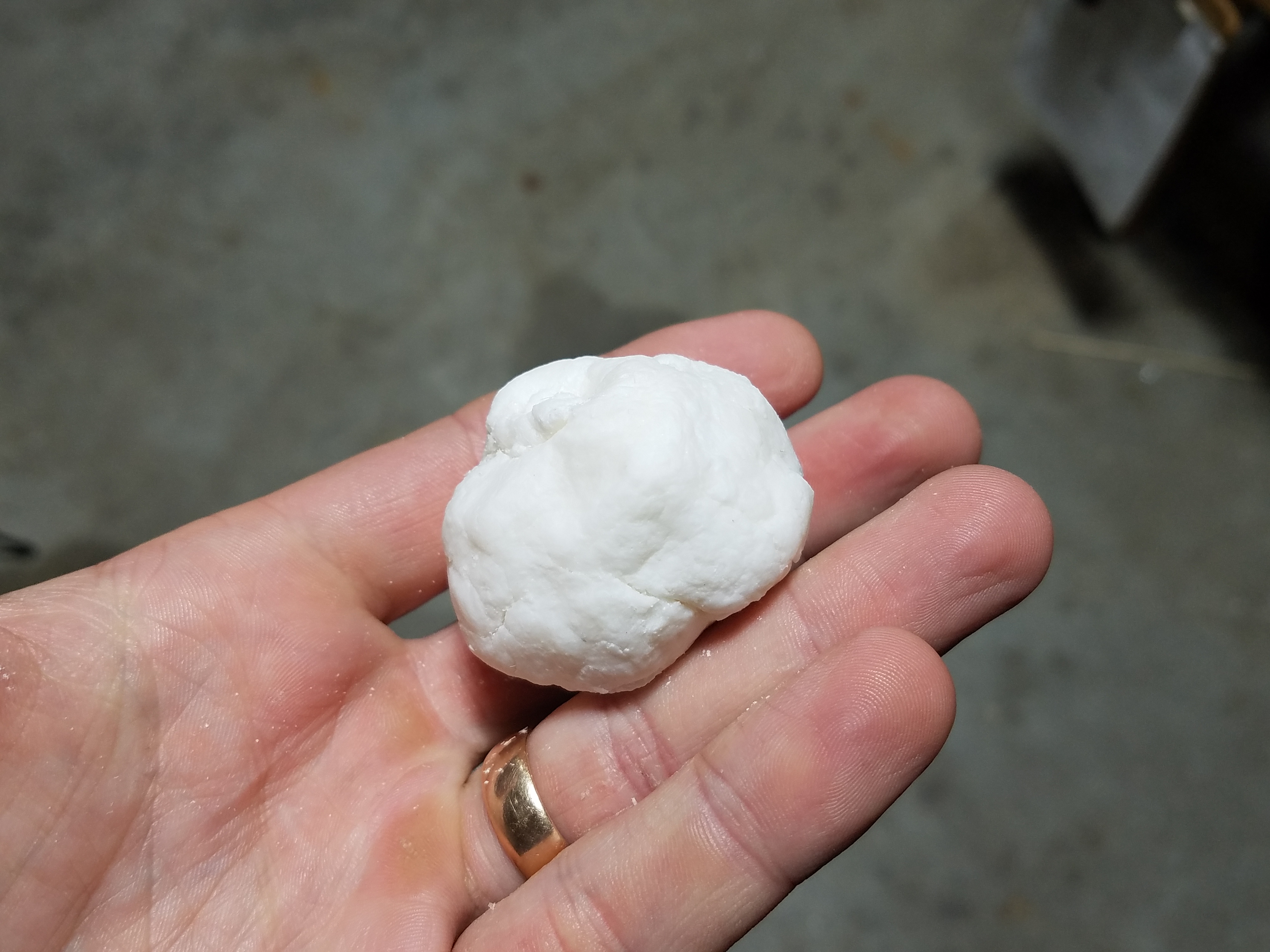

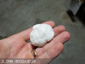

20 g of arginine was reacted with 2.1 mol equivalent 67.2% HNO3. HNO3 was put into a beaker and arginine slowly added with stirring. The arginine dissolves in the acid and the temperature increases to just above 50 C. This was stirred for at least 15 minutes. At the end of stirring, the material solidified and was then melted without drying on a hot plate at 125C. The material melts into a syrup and low density NQ needles were added with stirring until the mix became too thick to magnetically stir. Manual stirring was used to add slightly more than 1:1 w/w ratio of NQ into the melt.
The melt became quite thick and difficult to stir. The melt was removed from heat and cooled for a minute or two before being rolled into a ball. The consistency was approximate to a dense dough. The sample dried overnight and in the next afternoon was set solid like PVC or other cured hard plastic. The sample happened to weigh 50.01 g exactly. This wasn't intentional.
The sample showed no sign if hygroscopicity unlike other amino acid melts that have been tried in the past. It was dry and rock hard to the touch.
The sample was primed with a 1.1 g base charge PETN cap which failed to detonate the melt cast charge. It appears that a booster charge is necessary to detonate NQ when it is melted into higher density. Not surprising but noted.

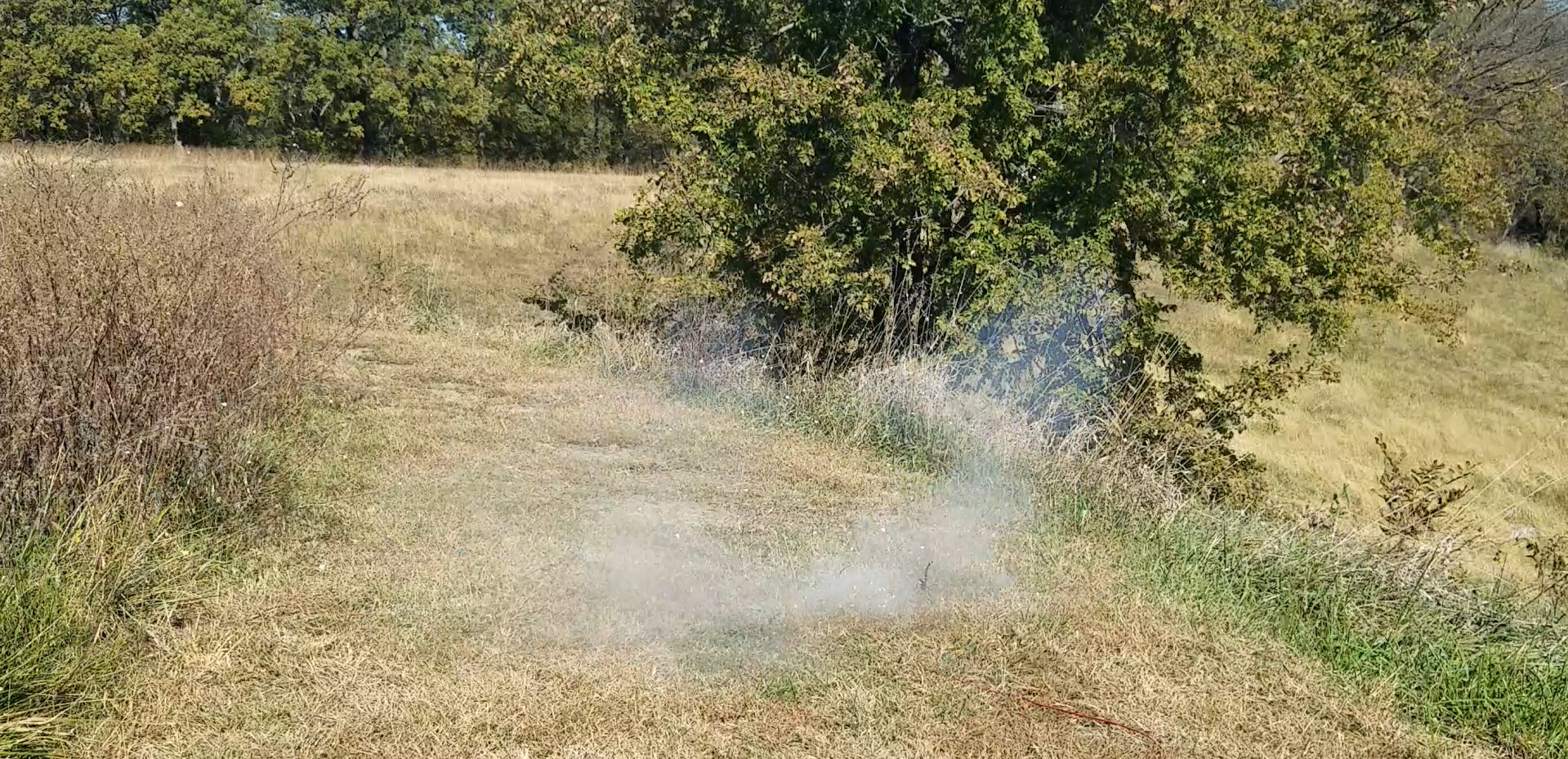

It does detonate on its own, if it were OB with ammonium nitrate I'm sure it would detonate too. As it is, its low velocity and gets fade out in small critical diameters. The first ball was even more insensitive, having melted nitro guanidine, it would require probably a 5 g booster, maybe even more. There is a very strong bad smell from detonation.

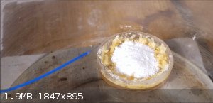

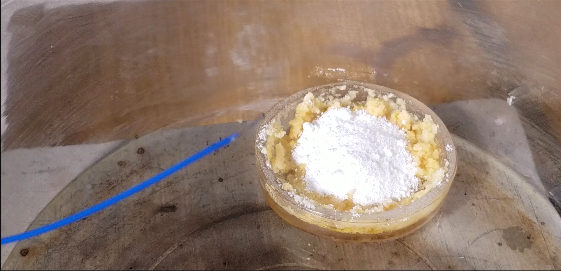

I have been experimenting more with ANGC, and I must say, for its simplicity it is quite effective as a melt cast carrier. I tested small melt samples, Nitroguanidine melts in a 1:1 ratio. PETN easily melts in a 4:1 ratio. Both materials form a brown paste on melt. This color appears to have nothing to do with destructive decomposition or loss of nitrates. Monitoring some samples for storability or decomp now over long term. I suspect the higher ratio Glycine ANGC formulations with lower mp would actually hold a greater mass of NQ or PETN.
