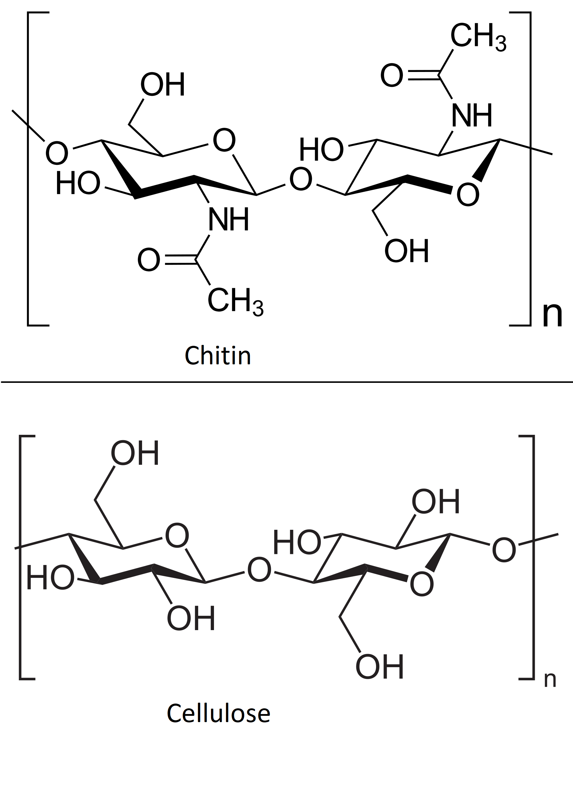

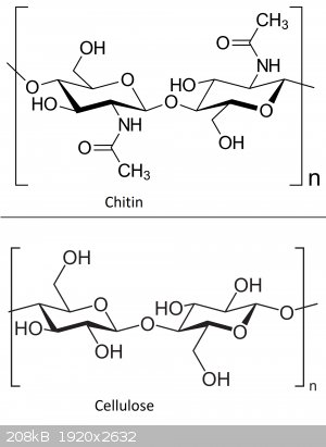

Hello Folks,
When I was a highschooler , I had the idea of synthesizing Nitro-chitin, knowing the fact that molecular structure of both Chitin and Cellulose looked similar to my highschooler eyes!
My questions are:
1-Has anyone already tried to synthesize Nitro Chitin?
2- Is it even possible?
I had collected nail clips and then put the nail clips inside a mixture of Sulfuric and Nitric acid ( not fuming Nitric acid just Nitric acid with concentration of 65% ish) the nail clips turned yellow but they did not burn like Nitro Cellulose - Yes they burn but like a normal nail clip would burn!-, my other attempts failed as well. Now after almost two decades I still am searching for the answer to this question that's why I reached out to you guys.
I think maybe I should first extracted Chitin from nail clips ( which I don't know how is it done till this day!) and then tried to turn it to Nitro Chitin.
So, if you know how to separate Chitin from finger nails I would appreciate it if u let me know.
-Sarinox
