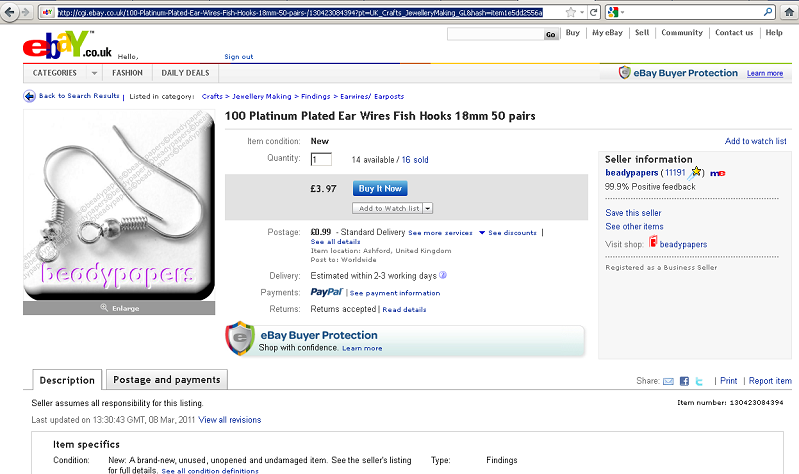

Checking on Ebay, it seems that one possible cheap source of Pt-plated items is cheap jewelry. E.g. see attached picture (put up as a permanent
screenshot rather than a temporary link so that it won't expire once the bidding closes).
The only problem with this is that it would be hard to construct a large surface area anode from a collection of these. The conductive joints between
discrete items would be subject to corrosion if they are made of anything but a noble metal.
Mixell
Posts: 449
Registered: 27-12-2010
It looks good, maybe too good to be true.
Even if its only plated, 50 pairs for less than 7 bucks?
Even if they were made from aluminium or stainless steel (and plated with nothing) I would consider 100 units of those for 6.5$ to be a bargain.
If we can get proof that this is really platinum plated jewelery, I would gladly order some myself.
And even more, maybe we could ask the seller if he can get his hands on some dirt cheap, platinum plated anodes (seems like he deals quite a lot with
platinum plated jewelery).

It may be so cheap because the plating layer is very thin. But thin is OK for our purposes, especially being so cheap as to be effectively disposable.
Beauty being skin deep, excuse the pun
But yeah, the price is very low. Their shape is awkward to use as anodes but I was thinking about either straightening them out using pliers, or
having quite a shallow cell running at a high starting pH to quickly absorb any evolved chlorine gas.

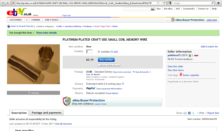

Here's some platinum wire for jewelry in a more suitable form. I've ordered some and will let you all know how my tests go . The titanium cathodes are being ordered from overseas so I'll try to use platinum
anodes/cathodes while waiting for the cathodes to arrive.

Quote: | I've ordered some and will let you all know how my tests go.
An anode for perchlorates for less than a quid???
It's pie in the sky . . .
Reading up on electrolysis might be more productive!
Last time I was looking for some platinum for an electrode in potentiometric titrations I saw these ‘Beadypapers’ allegedly platinum coated ear
wires and thought: ‘naff off, ain’t no Pt there!’
It’d be interesting to see your results. Try dissolving some in Aqua Regia, you’ll soon know whether there’s any Pt there…
I ended up spending £15 for for 3 cm of real platinum wire (not coated).

Hi guys, I just got the platinum coils today from Ebay and ran them in a saturated NaCl solution at 5V off an ATX PSU. They certainly looked platinum
plated as I've bought white gold jewelry for some close women before, and the white shine was just like how I remembered it.
Unfortunately within about ten seconds of using it as an anode, the white metallic sheen was lost very quickly and a greenish solution (probably the
Ni substrate being oxidised to NiCl2, as the wire was described as a shape memory wire which usually has nickel in it) started appearing around it.
The Pt plating must either be very thin or with lots of surface defects, hence allowing the evolved chlorine to attack the Ni base.
So it looks like these DIY anodes won't work
