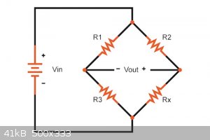

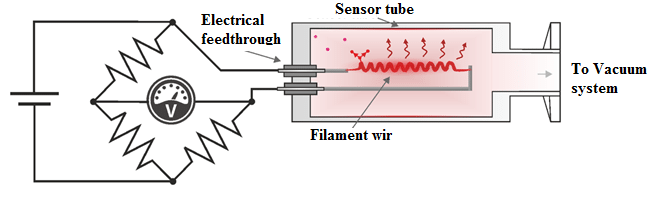

The Pirani Vacuum Gauge
3-A-schematic-diagram-for-Pirani-gauge.png - 19kB
A pirani gauge is essentially a heated filament exposed to the vacuum you want to measure. By feeding a small current to the filament, it will heat up. the amount of heating depends on the supplied current and the pressure of the environment. At higher pressures there are more molecules to carry away the heat from the filament due to convection. At lower pressures there aren't many molecules, and the temperature of the filament increases.
When the filament heats up, its resistance also increases, so we can correlate the increase in resistance with a lowering of pressure.
This resistance change can be very small, not easy to detect with a simple multimeter, so we use a circuit called a Wheatstone Bridge.

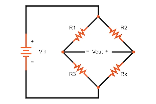

wheatstone_bridge_for_calculator.png - 41kB
When R1/R3 is equal to R2/Rx, Vout is 0V.
Any changes in Rx will cause a potential difference to be detected.

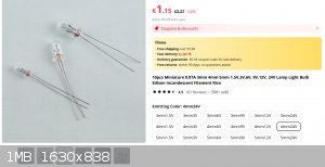

I tried different kinds of lightbulbs, but the best ones are these little miniature lighbulbs that can be had for super cheap.
I bought the 4mm 24V model, and I'll say later why
lightbulb.png - 1MB

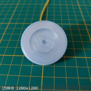

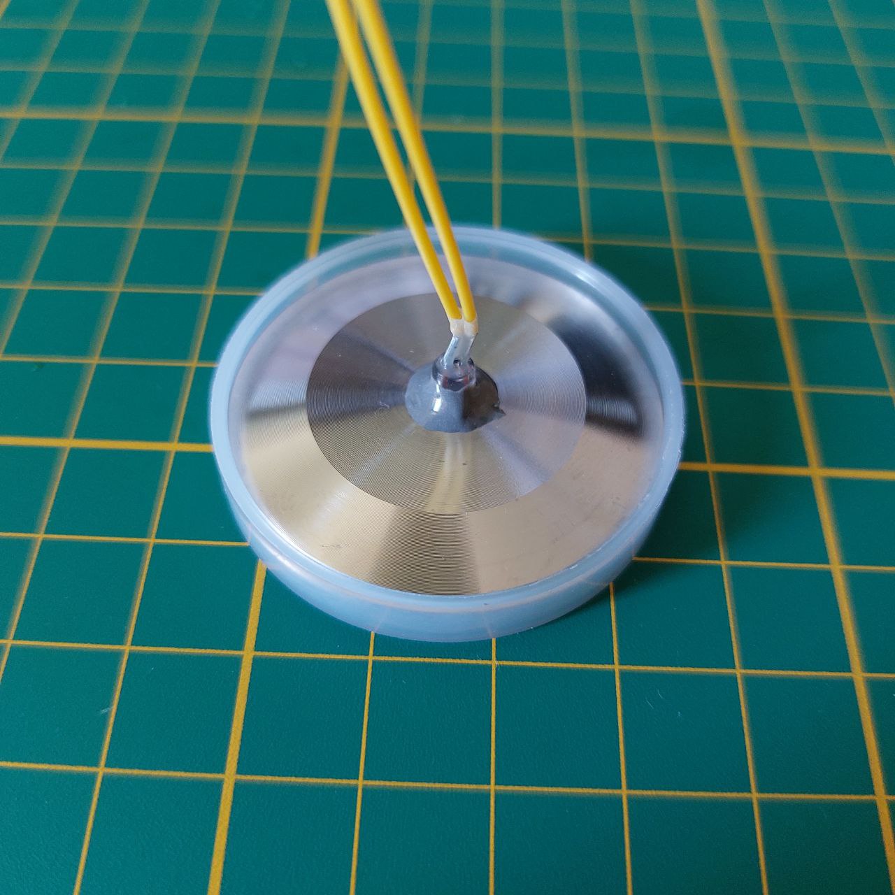

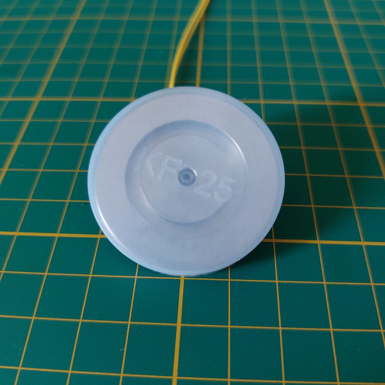

After gently sanding the tip with some not so fine sandpaper, I epoxied it in a hole I drilled in a KF25 end cap.
I'm using KF parts because my vacuum system is based on those, but if you are using glass or random copper pipes and jam jars, you can glue this tiny bulb wherever you like, just make sure it is a vacuum tight seal.
Some epoxies don't behave optimally under vacuum. JB-weld is apparently quite good for vacuum work, but I don't have that in my country, so I had to try a few out before I found this that degasses the least.
diy kf pirani gauge top.jpeg - 200kB diy kf pirani gauge bottom.jpeg - 158kB

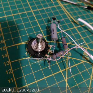

Now the electrical part of the project.
This are the components I used for the Wheatstone Bridge
- R1 100 ohm 1W
- R3 100 ohm 1W
- R2 220 ohm 1W + 100 ohm potentiometer
- Rx 4mm 24V incandescent lightbulb
diy wheatstone bridge.jpeg - 282kB
R1 and R3 can probably be normal 1/4W resistors, I went with 1W versions only to minimize the resistance change caused by joule heating.
I'm supplying the wheatstone bridge with 5V, so one may ask, why did I buy a 24V rated lightbulb if I'm feeding it with 5V though a resistor of at least 220 ohms.
Tungsten won't melt at 2000°C, but it will happily burn in a blink of an eye if exposed to oxygen.
A bigger temperature delta will give us a bigger resistance delta, and a bigger range of voltages between atmospheric pressure and "vacuum", but it will also shorten the life of our gauge, or instantly kill it as soon as we apply power to it.
The 220 Ohm resistor was picked to make the filament barely glow when under high vacuum, and be only a couple hundred degrees when at atmospheric pressure.
The 100 ohm potentiometer is there for us to set the 0V point at the vacuum lever we desire.
With this configuration the cold filament has a resistance of 60-70 ohm (varies from bulb to bulb) and reaches a max of 320 ohm when heated in a vacuum.
The voltage output goes from -1.2V to 0V.
If in your setup you start getting positive values, it is ok, the pressure is still going down, as i said, these values are arbitrary, their direction is more important than their absolute value.
Still, you can adjust the potentiometer to make your lowest pressure 0V.
If one is bothered by the negative voltage, swapping the leads of the multimeter solves the "issue" XD

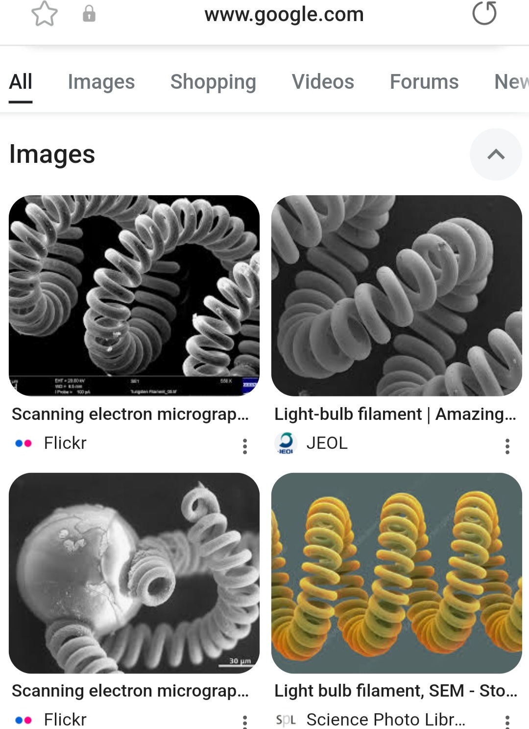

When the filament heats up, its resistance also lowers, so we can correlate the increase in resistance with a lowering of pressure
Raises
But spot on design.

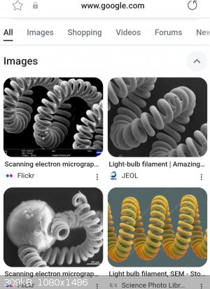

The light bulb filament is the only thing stopping you from calculating the exact pressure.
I would suggest nicrome wire. It is easier to get and more chemically resistant across your desired temperature range. More importantly, you can measure its length accurately. You can not do that with a light bulb filament.(its a spring, made from a spring)
Measuring the length, resistance, and weight you can characterize the heater. Them measure the thermal dissipation and compare it to a reference chart.
stolen from google
Screenshot_20240628_175306_Samsung Internet.jpg - 309kB
As you can see the area useful for radiant thermal emissions is.... more than difficult... to calculate. A stright peace of wire would be much more manageable
