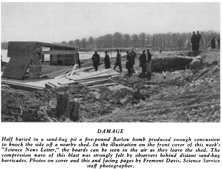

Some of the newspaper articles claim impressive results during the German bombing of Barcelona like bombs killing people located a quarter of a mile(400 meters) from the explosion.
Is there any evidence of those alleged effects or were those claims nothing more but rumors combined with the fear that Germany developed a wonder weapon with an enormous blast radius?
BarlowBombNewspaper_6.jpg - 206kB

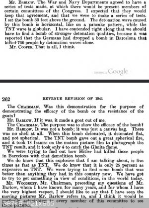

I think that your explanation is probably correct and that the Gran Via de les Corts Catalanes truck explosion(according to an article on a site that I found the truck carried about 4 tons of explosives) and the cases of fragmentation injuries somehow merged into a story about a non-existent "superbomb".
The content of the first attached image allows the assumption that Barlow read that warped story and truly believed that a new type of bomb was used in Barcelona.
What still remains unanswered is the question of why he believed that a few hundred pounds of a liquid oxygen containing explosive(his "GLMITE") could potentially flatten every building and kill everyone within a 1000 feet(300 meters) radius.
PS: I think it is crazy that in 1938 an explosion with a yield of a few tons of TNT managed to start a false story about a superbomb and that just a few years later it had become normal to regularly drop real superbombs aka High Capacity/Blockbuster bombs with a similar and sometimes higher yield(like the 12000lbs HC bomb).

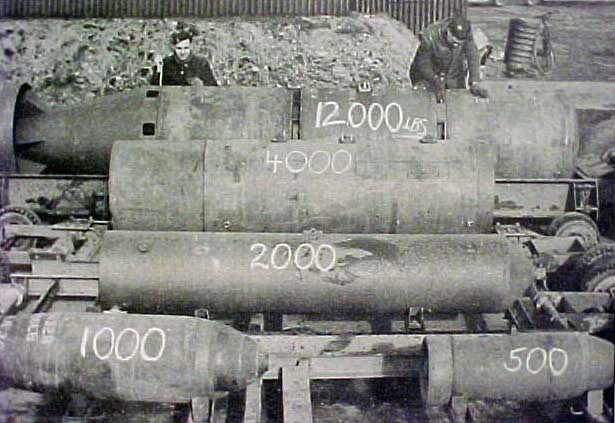

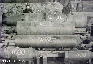

HCbombs.jpg - 41kB

Five times as fast as TNT? That’s 34,500 m/s!
Trashcanman
Posts: 25
Registered: 23-1-2024
[*] posted on 1-4-2024 at 14:52
I seriously doubt it.
I think the method used during the test to determine the detonation velocity of GLMITE was simply unusable.
Even Octanitrocubane only has a detonation velocity of around 10100 m/s.

Yeah, it’s undoubtedly completely made up. Also, his claim that it detonates “flat” as opposed to spherical makes no sense.
I am not sure what he meant by the bomb detonating "flat" but I guess that he could have meant that the fireball wasn't spherical.

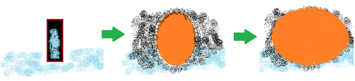

I made a simple image in Paint to better explain how the evaporated oxygen could have contributed to unexpected blast results.
[1]Liquid oxygen has evaporated and because oxygen is heavier than air it has accumulated near ground level and the bomb still contains liquid oxygen but not enough to oxidize all of the carbon.
[2]The bomb has been triggered and the unreacted carbon dispersed into the vicinity which is filled with more oxygen than would be normal because the evaporated oxygen has mixed with the air.
[3]The fireball grows to the dimensions of the carbon-(oxygenRich)air cloud and within it the overpressure of the explosion does not significantly decrease because the detonation reaction propagates throughout this cloud. Thereby the blast wave does not decay as fast with distance when compared to one caused by an ordinary high explosive.
In other words the evaporated oxygen increases the probability of the unreacted carbon forming an explosive mix in the air and this causes an unintentional volumetric explosion.
BarlowBombThermobaricEffect.png - 90kB

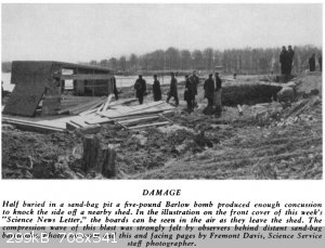

This is of course just a hypothesis but it could explain the result of a different test that is visible in the following picture.
BarlowBomb5Pounds.png - 299kB
