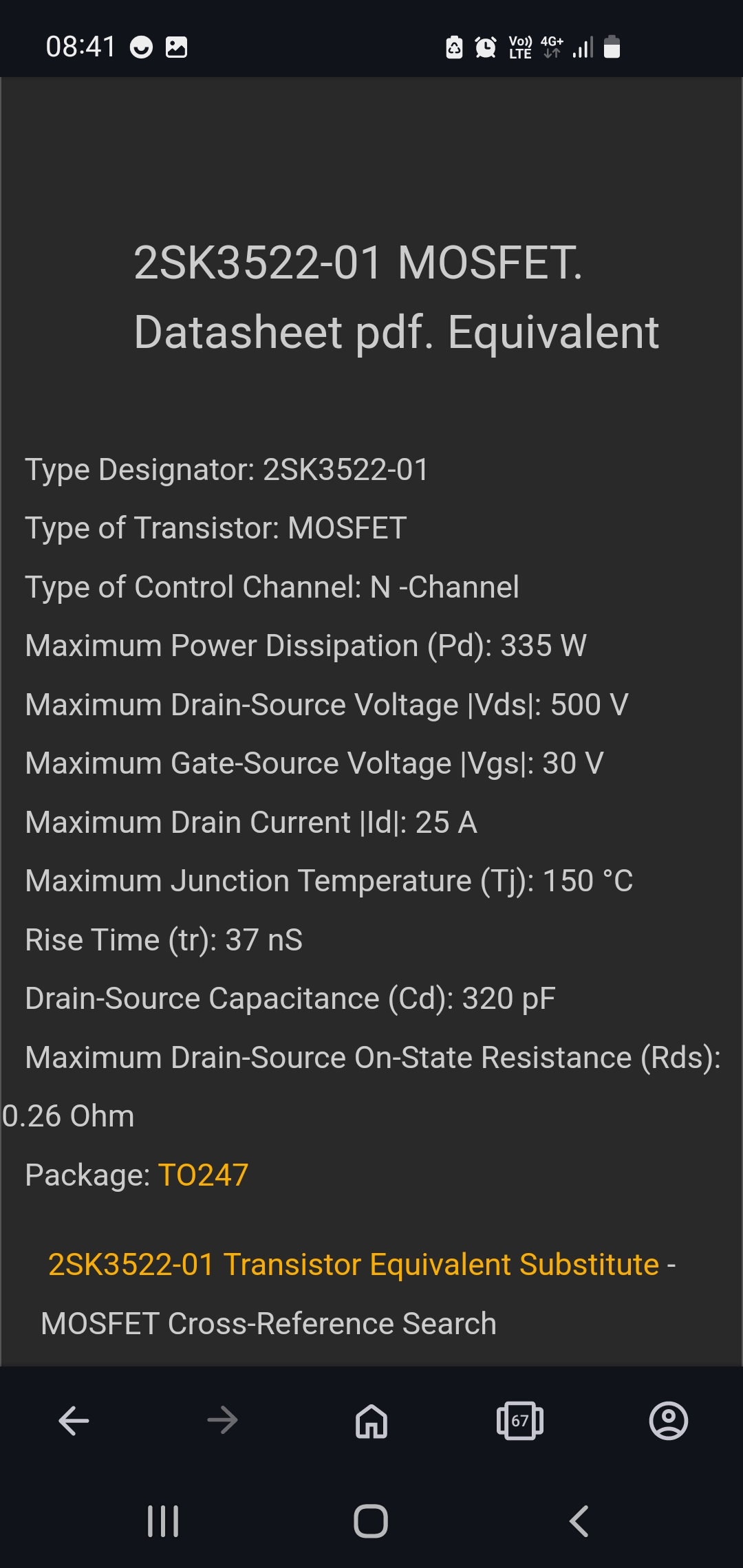

I have ordered a npn and pnp transistor kit and will try a slayer exciter with less current and an 2N2222 i guess and i also have a higher powered transistor in mind and found one laying around (Datasheet atteched), I would guess this one wouöd work in a circuit like the one from https://youtu.be/wWIeUsnqkRk?si=8dXwbloiED2jXQ8x
Screenshot_20240315_084139_Opera.jpg - 372kB
Posts: 3779
[*] posted on 15-3-2024 at 03:50
I have played with a couple of these
https://www.ebay.co.uk/itm/353994827404
Very nice, and cheap.
Easy to change airgap and/or replace primary winding.
As-is it should suit your needs.
PS I've not tried but I think that one of these
https://www.ebay.co.uk/itm/375304429891
may be even better.
but if you're in the mood to wind-your-own then ok
That mosfet is beefy - slight overkill ;)
(just check that the large gate capacitance will not be a problem in your design)
