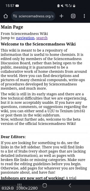

Recently my sm wiki looks like a unfinished html
Didnt change anything on my end.
Does anyone have an idea how to fix that?

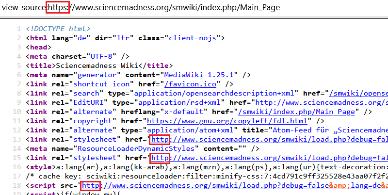

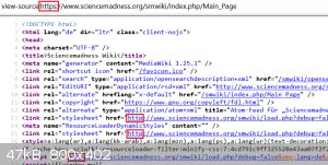

This is still broken. The reason is that the https site tries to load the http stylesheet. Keyword "Mixed content".
