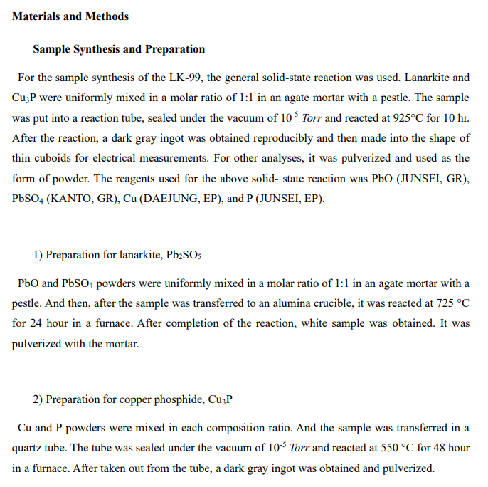

Waiting peer review. Their have been so many fake superconductors, not sure why
The synthesis process isnt that bad.
800c is moderately difficult on medium/large scale, easy on small scale.
But the 0.00001 torr. Thats not easy.
Have to break out a diffusion pump. That may not be enough.
Also phosphorus is illegal to own/handle/make/buy in my area.
So sourcing the CuP would be another issue.
Everything else is easy to source.
I don't think that such low pressures are required for these reaktions actually I think they had just this pump on hand and why use a worse one.
If the paper is legit I would be eager to try the synthesis of this material!

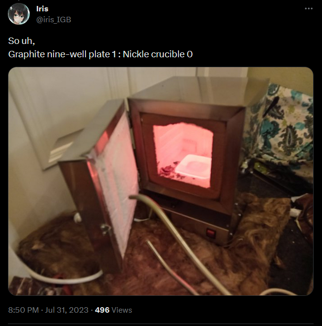

Sorry, first study in the post above is a repost from earlier, it was updated though. There's probably so much more I could post, but I didn't want anyone here to miss this one, a bit of comical relief maybe.
https://twitter.com/iris_IGB/status/1686071973011472406
cruciblevsbed.png - 334kB

The proposed chemical equations for this substance are all obviously wrong. It is not acceptable to show metallic copper or lead as a product; electrons will not be transferred from sulfur or phosphorus to these metals. Equations must be balanced.
It may be helpful to determine what conditions stabilize the necessary crystal structure if we start from an understanding of what compounds are actually present in the samples.
Here is one equation which is actually possible:
49 Pb2(SO4)O + 48 Cu3P >> 8 Pb9Cu(PO4)6O + 49 Cu2S + 26 PbO + 19 Cu2O
Notably, this comes very close to the "equimolar" quantities originally reported (off by 2.2%).
It appears that Cu2S or possibly PbO may serve as the critical support for "templating" the growth of sc-Pb9Cu(PO4)6O. Samples of "LK-99" produced by other methods are unsatisfactory even when the "correct" stoichiometry is obtained. It would be interesting to see if the material made by other methods can become interesting when it is mixed with Cu2S and melted. Substituting Cu2S with other similar materials like Ag2S may also be fruitful.

What's the catch? I don't suppose you could just grind those materials together with a mortar and pestle and have a working superconductor.
Of course not. Read the paper, it explains the procedure in decent detail. In fact, a screenshot of the relevant procedures is in the OP of this very thread!
