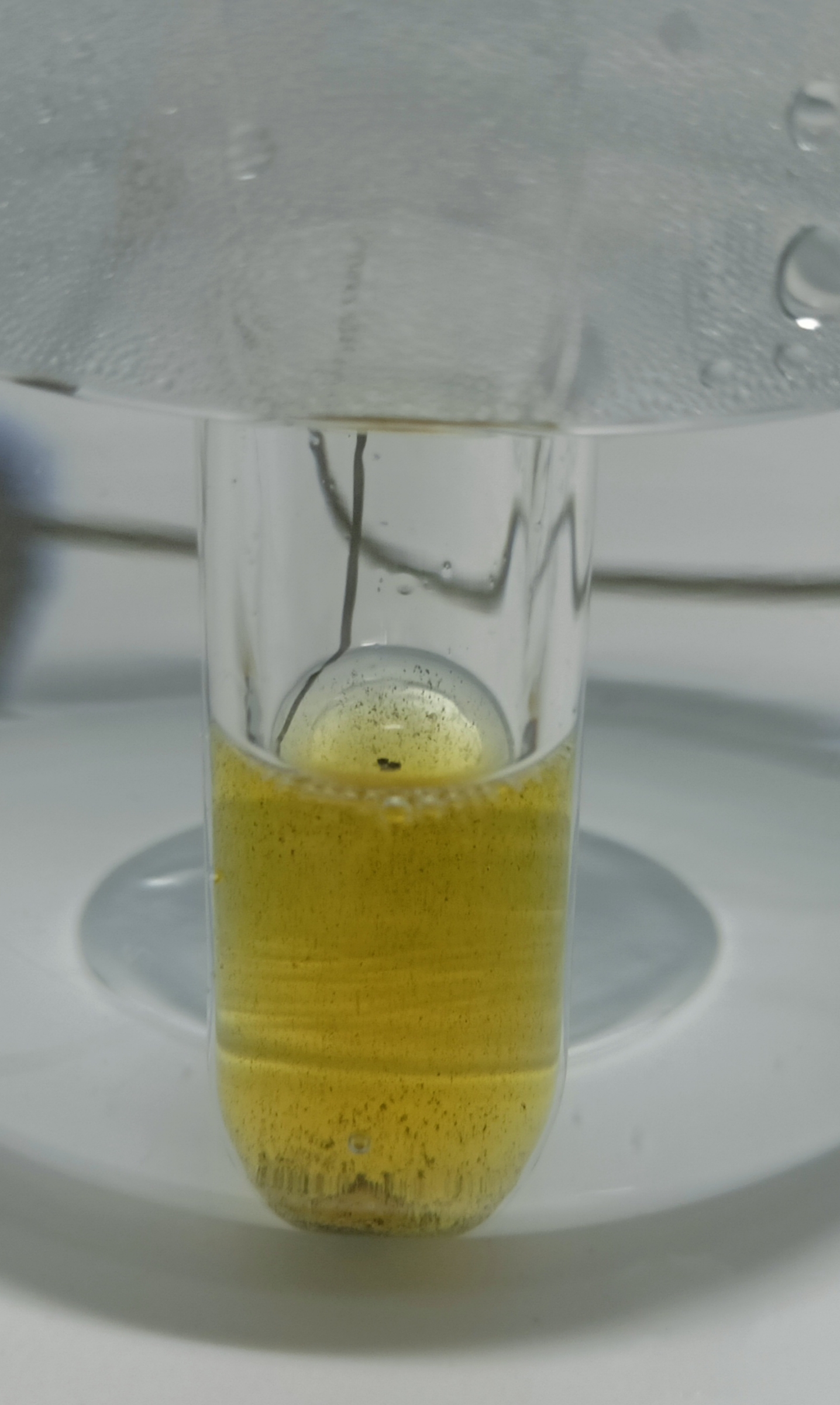

Today I tried reaction between sodium selenate and 48% HBr. This produce orange solution of SeOBr2.H2O.
Than I tried to bubbled HBr gas through solution. Solution darkened. I don't know if Se(IV) produce similar complexes like in HCl ([SeBr5]-) or if
this is just shift in equillibrium which favors formation of more SeOBr2.H2O. Part of coloration would come from bromine, because I use just quick
setup using KBr and 96% H2SO4, which produce bromine contaminated HBr gas. I dissolved some elemental selenium in this mixture - when I added water to
it, it separates in to two layers - the bottom layer was probably Se2Br2 formed by reaction of Se with Br2. When I tried dissolve selenium in fresh
solution of SeOBr2 in 48% HBr, selenium almost didn't dissolve. Maybe stronger heating is needed? I have two different results - in first try little
bit selenium dissolve, which later precipitated after dilution with water. In the second attempt nothing dissolve, but my water bath was colder than
before. Maybe I'll give this another try.
![IMG_20230723_124719.jpg - 1.6MB](http://www.sciencemadness.org/talk/files.php?pid=685958&aid=98896)
[Edited on 23-7-2023 by Bedlasky]
