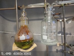

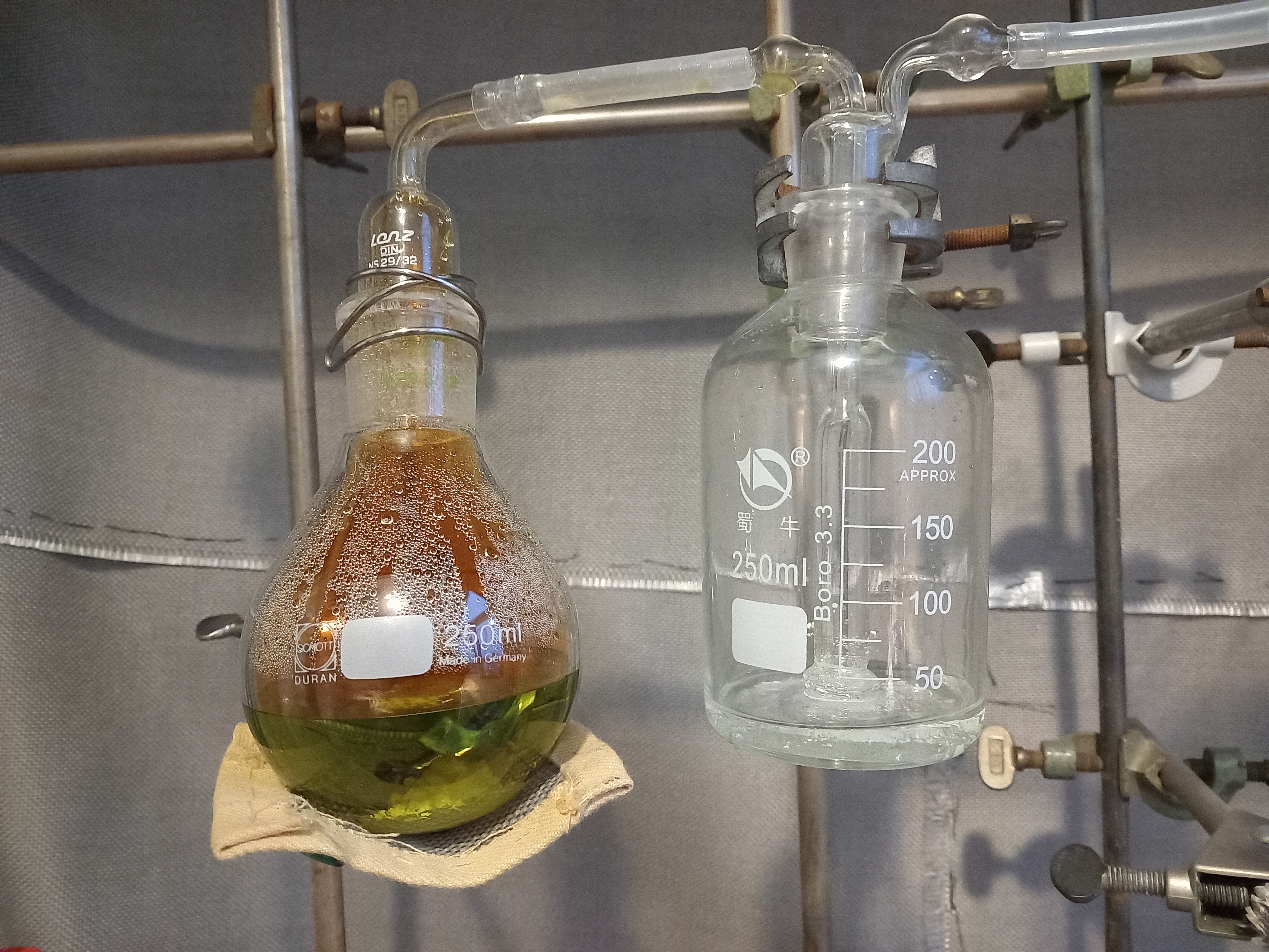

Absorption of NO2 by H2SO4
I didn't know that fact. Actually, my attempt of drying NO2 by passing through conc. H2SO4 was failed because almost no gas (0.2mol as the result of reaction) was leaving the wash bottle where 30 ml of 96% H2SO4 + ~130mg CuSO4 (mostly undissolved) were placed.
(I've added CuSO4 to detect NO presence - in this case the solution would turn the color to violet).
I didn't make the photo of the whole apparatus but even from this fragment you can see the difference between in- and out- tube. 15 cm after the outlet the brown color was totally disappeared, so the gas really can't pass the absorber.
Another evidence is the reaction of the liquid in the wash bottle with water. It results instaneously in a big NO2 cloud. But the presence of NO2 isn't noticable in the liquid - no color change, no strong smell.
What could be the chemistry of NO2 absorption by H2SO4?

[Update]
From the article "The sulfuric acid solvent system" by R.J. Gilliespie and E.A. Robinson:
"dinitrogen tetroxide gives a mixture of nitronium and nitrosonium hydrogen sulfates:
N2O4 + 3H2SO4 = NO2+ + NO+ + H3O+ + 3HSO4-
But I have a doubt about NO+ presence because I don't observe any color change of CuSO4 salt.
[Edited on 1-6-2023 by teodor]

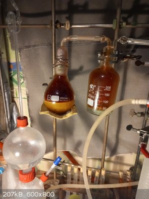

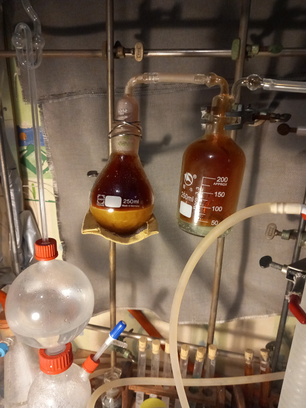

[*] posted on 1-6-2023 at 10:22
I think there is a difference between concentrated H2SO4 and H2SO4 + water in regard to NO2. This is about the old articles.
When I compare
KNO3 + 3H2SO4 = K+ +NO2+ + H3O+ + 3HSO4-
and
N2O4 + 3H2SO4 = NO+ + NO2+ + H3O+ + 3HSO4-
it really looks similar except in the second case there is only one H3O+ per 2 nitro[so]nium bases.
Well, I would say in both cases you have nitronium hydrogen sulfate in the solution which is decomposing in the first case during the heating.
What is attracted my attention is that NO+ ion is absent at the end of absorption because the color of the solution didn't changed comparing to the case when I pass NO2 + NO mixture.
