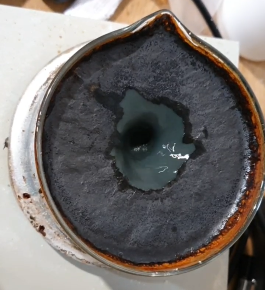

FeGlycinateAttempt.png - 1.2MB
Fe(II) will also oxidise even when citric acid or L-ascorbic acid are added into the solution. I prefer not to add compounds which might complex with the metal, but I saw this done in a patent and in a separate publication so I thought I'd try it out as well; unfortunately it did not prevent oxidation.
Additionally with ascorbic acid, the solution rapidly turned purple, which is a sign of the formation of Fe(Ascorbate). I suspect citric acid does something similar as the solution remained green, which is usually a sign of Fe(Citrate) formation as Fe(Gly)2 is yellow-brown in solution. However I'm not 100% sure if Fe(Citrate) was formed as Fe2+ is also green in solution.
