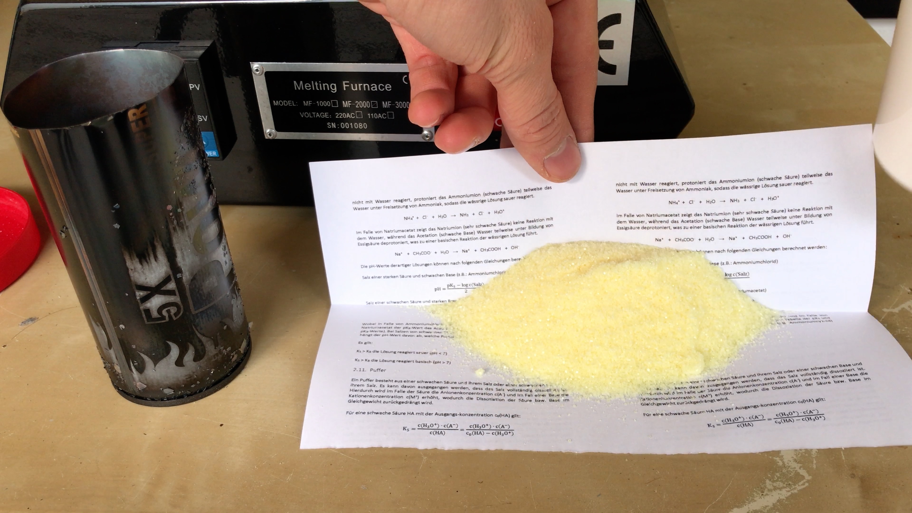

123,9g of Potassium FerrOcyanide Trihydrate (the yellow salt the red one cannot be used) were added to an iron crucible. Aluminium is unsuited due to its low melting point. The container was placed into an electric furnace capable of maintaining a temperature between 850-950°C. The furnace was switched on and the moment the target temperature was reached a 1 hour timer was started. Heating for exactly one hour is overkill and 30 minutes may suffice. The furnace used contained residual carbon which reacted with leftover oxygen. The lid was lifted occasionally to check on the reaction and the first three times we were greeted with a lovely fireball. The flammable gasses could have either resulted from the combustion of carbon monoxide or more likely due to the combustion of a product of the reaction. Cyanogen gas is formed as a side product. It is a highly toxic gas and it is the reason this preparation needs to be conducted in a very well ventilated area. At these high temperatures most of it should immediately be oxidised to harmless side products but you do not want to run the risk of being exposed.

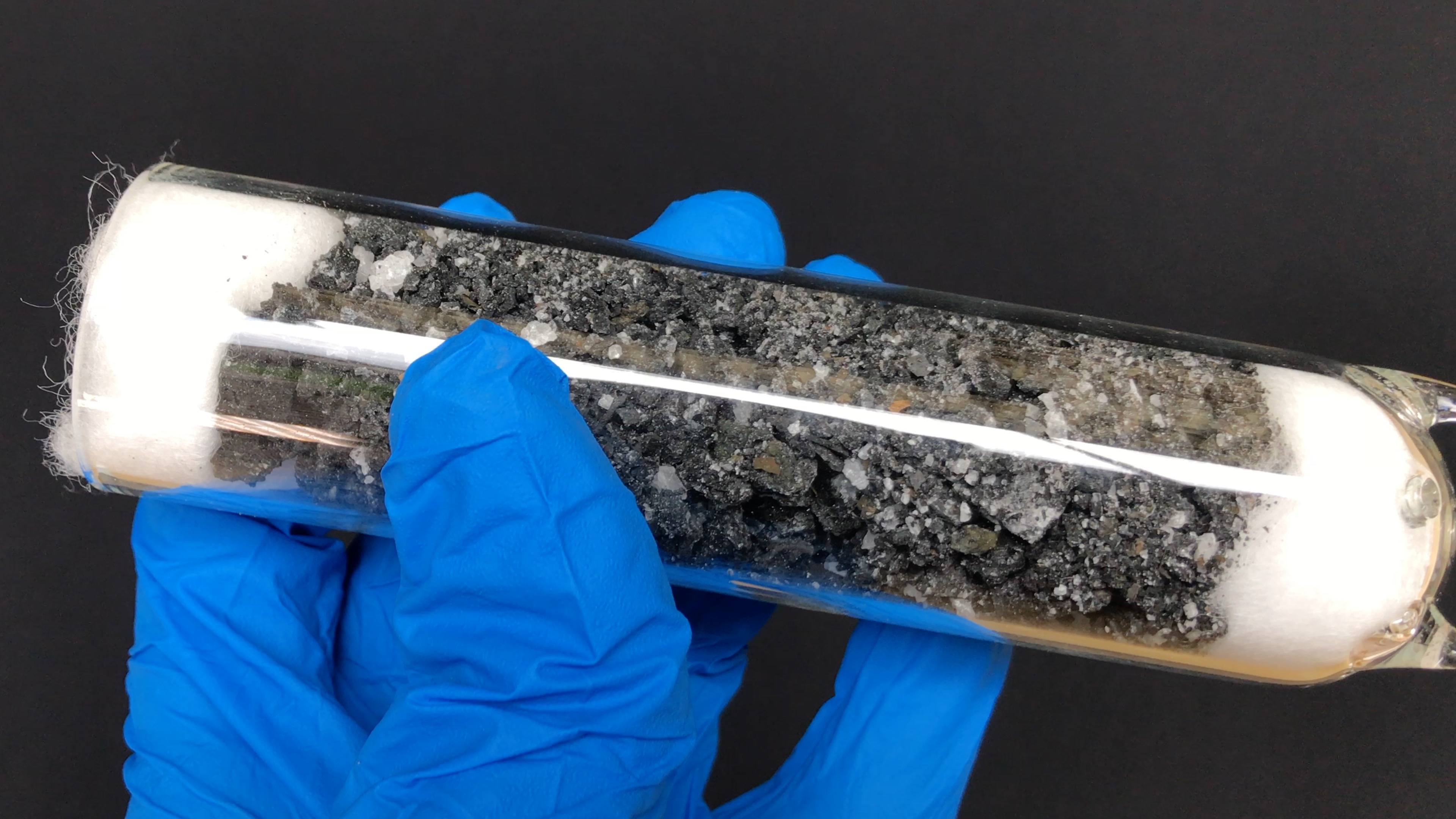

The crushed up, contaminated cyanide was placed into a glas tube plugged with cotton on both ends and a capillary tube was added to the top to allow air to leave. A soxhlet extraction was set up. We used a high efficiency soxhlet extractor (This is a form of soxhlet extractor where the heated solvent gasses do not pass trough an external tube but trough a glass mantle surrounding the extraction chamber. The solvent and the material to be extracted are thus heated and get to a temperature near the boiling point of the solvent). The soxhlet extraction was allowed to run for 10 hours. A few particles of the contaminants made it trough the cotton filter. With finer cotton this could be avoided.

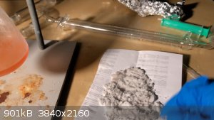

Pictures 1
crucible.jpg - 1.1MBextraction device.jpg - 1004kBsoxhlet extraction.jpg - 965kBsoxhlet leftovers.jpg - 964kBferrocyanide.jpg - 999kBcyanogen.jpg - 996kB

cool.gif posted on 18-3-2023 at 04:50
Quote: Originally posted by Thyzoid
Nice work!
What's the photo left/up?

[*] posted on 18-3-2023 at 04:55
@blogfast25
The picture on the upper left corner is the methanol after 10 hours of refluxing. It was slightly reddish due to what i guess was iron contamination. The next day when I did the vacuum filtration the MeOH was more brown than red but most of the brownish solution fortunately went right trough the filter.
