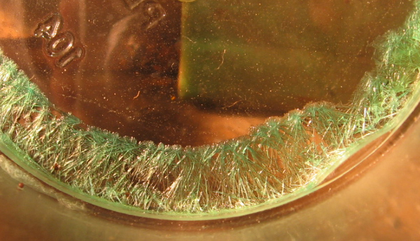

Tin(II) chloride crystals with copper chloride impurity from the leftover solder residue:
Edit: Corrected crystal composition.
[Edited on 4-5-2011 by m1tanker78]
Arthur Dent
Posts: 553
Registered: 22-10-2010
Mood: entropic
Looks good!
Tin chloride crystals and copper chloride crystals both develop into beautiful needle-like structures,
In the photo below, I prepared a solution of tin chloride, I put a few drops in a watchglass and let it dry at room temp for a day or two. They are
relatively pure tin chloride that show the needle-like crystals.
Copper chloride crystals are a very deep, intense green, so your crystals above might be a combination of copper chloride and tin chloride judging by
their pale color.
Robert
m1tanker78
Posts: 685
Registered: 5-1-2011
Robert, I'm a little envious of your tin chloride (for good reason)!
The crystals in my above pic are indeed a combination of Sn and Cu chlorides. I left 2-3 mL of tin liquor behind when I decanted. These crystals are
the dihydrate, right? I love how nucleation randomly takes place and can clearly be seen in your crystals.
Unfortunately, a few grains of crud wound up in my decanted solution so it's now turning green. I'll be more careful next time and probably filter
instead of decant and just accept a little loss in the filter paper.
