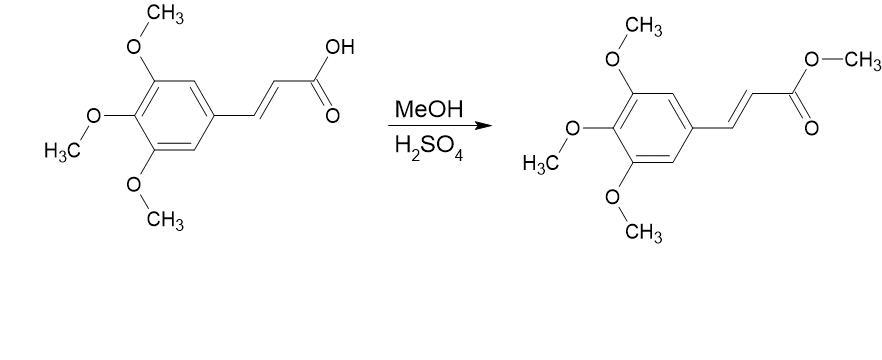

Fischer synthesis of methyl 3,4,5-trimethoxycinnamate
A straightforward Fischer methyl esterifcation of 3,4,5-trimethoxycinnamic acid.

2ml of conc. H2SO4 was added to 50ml anhydrous methanol.
4.73g (19.8mmol) of 3,4,5-trimethoxycinnamic acid (3,4,5-TMCA) was dissolved to the resulting mixture (it dissolved quite readily), and refluxed for
18 hours.
After 18 hours, the solution was allowed to cool to RT, after which crystals of the methyl ester precipitated.

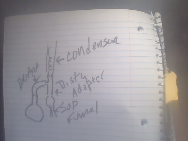

a dean stark can be rigged up if you put the tip of the 105 takeoff in your boiling flask, and change out the thermometer with a condensor, and a sep
funnel on bottom of disty head. forgive my terrible drawing skills!
