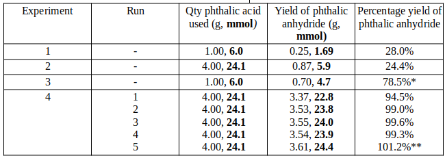

Summary of following experiments
In Experiment 1, the traditional RBF+beaker approach was used, resulting in a percentage yield of 28.0%.
In Experiment 2, an alternative apparatus (p.31 of [2]) was used, resulting in an even lower percentage yield of 24.4%.
In Experiment 3, a better apparatus was then devised, employing a glass dish wherein the phthalic acid was placed inside a nickel crucible, induction
heated from outside (the apparatus is described in more detail below), this resulted in a percentage yield of 78.5%.
In Experiment 4, Experiment 3 was repeated on a larger scale, five times, resulting in an almost quantitative yield (94-99%)

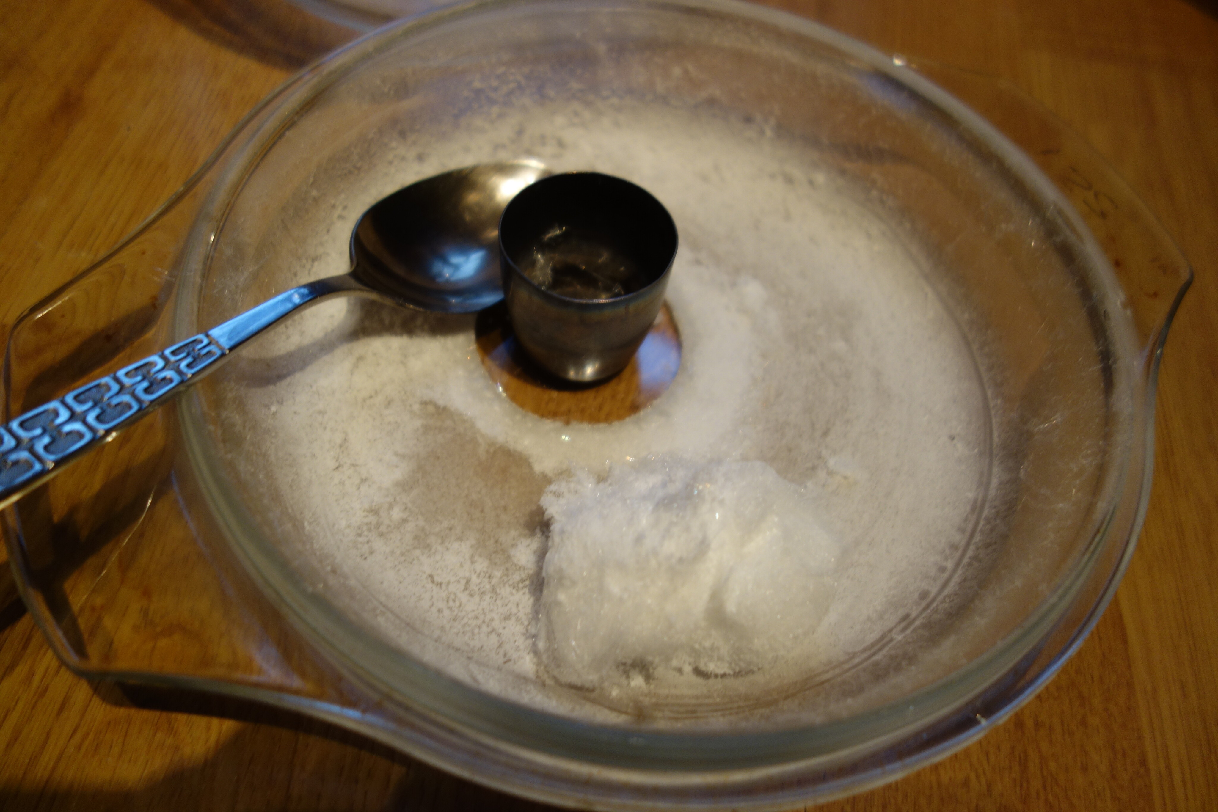

Experiment 3 (induction heated) (1g scale):
1.00g (6.0mmol) phthalic acid was placed in the nickel crucible, which was placed in a large glass Pyrex casserole dish.
The induction heater was switched on; within a few minutes, the glass became clouded with condensation, and the white solid began to melt and bubble,
with woolly crystals depositing on the glass above the crucible.
Shortly thereafter, small crystals began to swirl around inside the dish, eventually coalescing as woolly crystals which gradually filled the dish.
After a total of approximately five minutes, the crucible was empty, with a very small quantity of tarry residue remaining therein, the dish filled
with woolly crystals.
The induction heater was switched off and the apparatus was allowed to cool down, whereupon the dish was opened, revealing a large mass of light
woolly needle crystals filling the shape of the dish, these were readily collected into a wad of wool.
Significant quantities of fine white powder were deposited on the glass, quite different in form than the needle crystals.
Some of the product had melted onto the glass dish in a circle around the crucible, presumably due to radiation from the crucible, in addition to heat
conducted through the glass from the work coil of the induction heater (which was not water-cooled, so it reached a fairly high temperature due to
resistive heating).
All of the product (the woolly crystals, fine white powder, and melted material) was returned to the crucible and re-sublimated, exactly in the same
manner as before.
During the re-sublimation, the solids melted and began to bubble, however no condensation formed on the glass, because there was no reaction taking
place that released water, so it was easier to see what was happening in the dish.
In this case, much less of the product deposited as a fine powder, with the majority forming woolly crystals, this is suspected to be due to the lack
of water, compared with the initial reaction; perhaps the water caused some of the crystals to stick to the glass and form improperly?
Alternatively, perhaps the re-sublimation yielded a purer product.

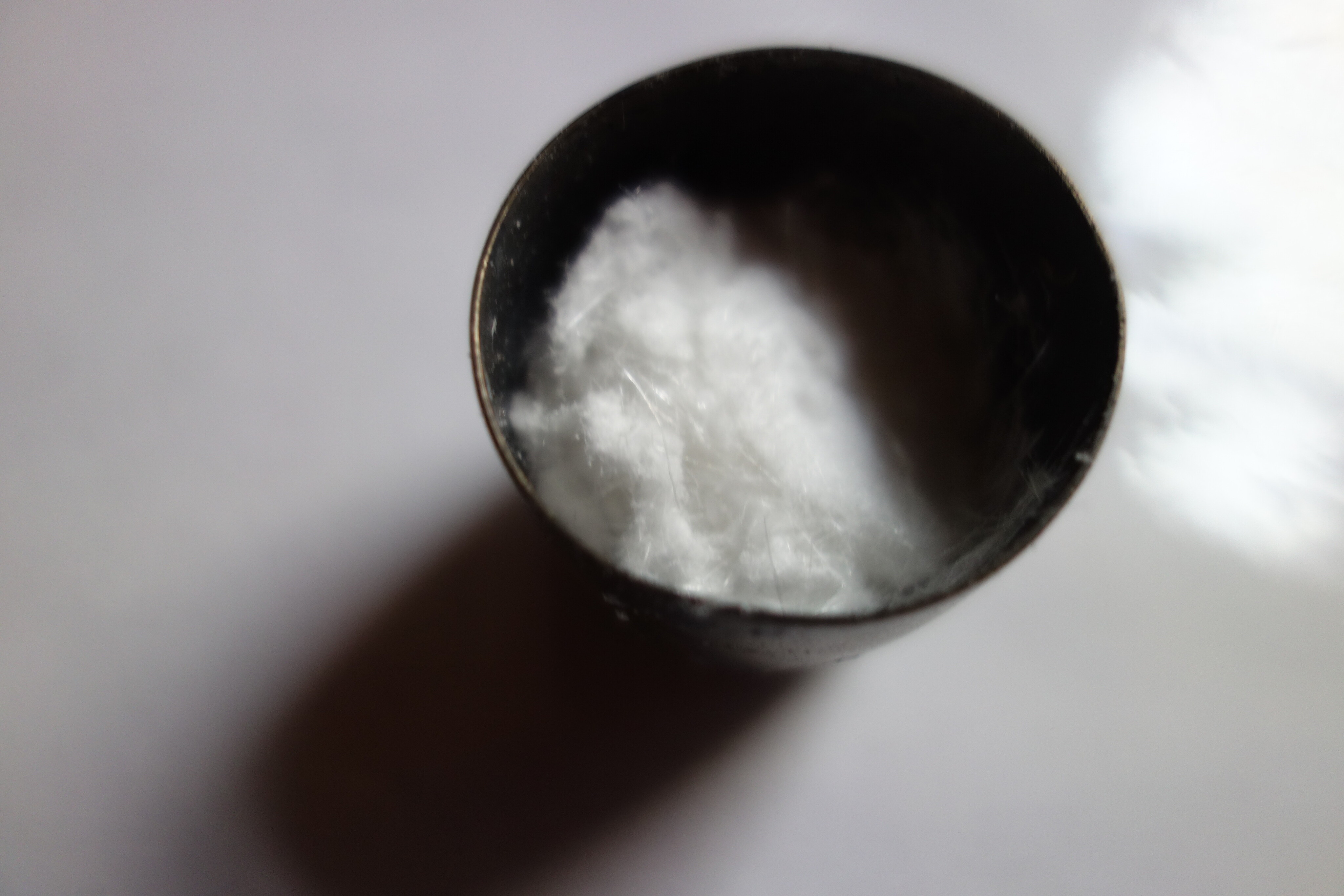

After the second sublimation, the experiment yielded 0.70g (4.7mmol) of woolly needle crystals of phthalic anhydride, this corresponded to a
percentage yield of 78.5%, around three times higher than the yield from Experiments 1 & 2.

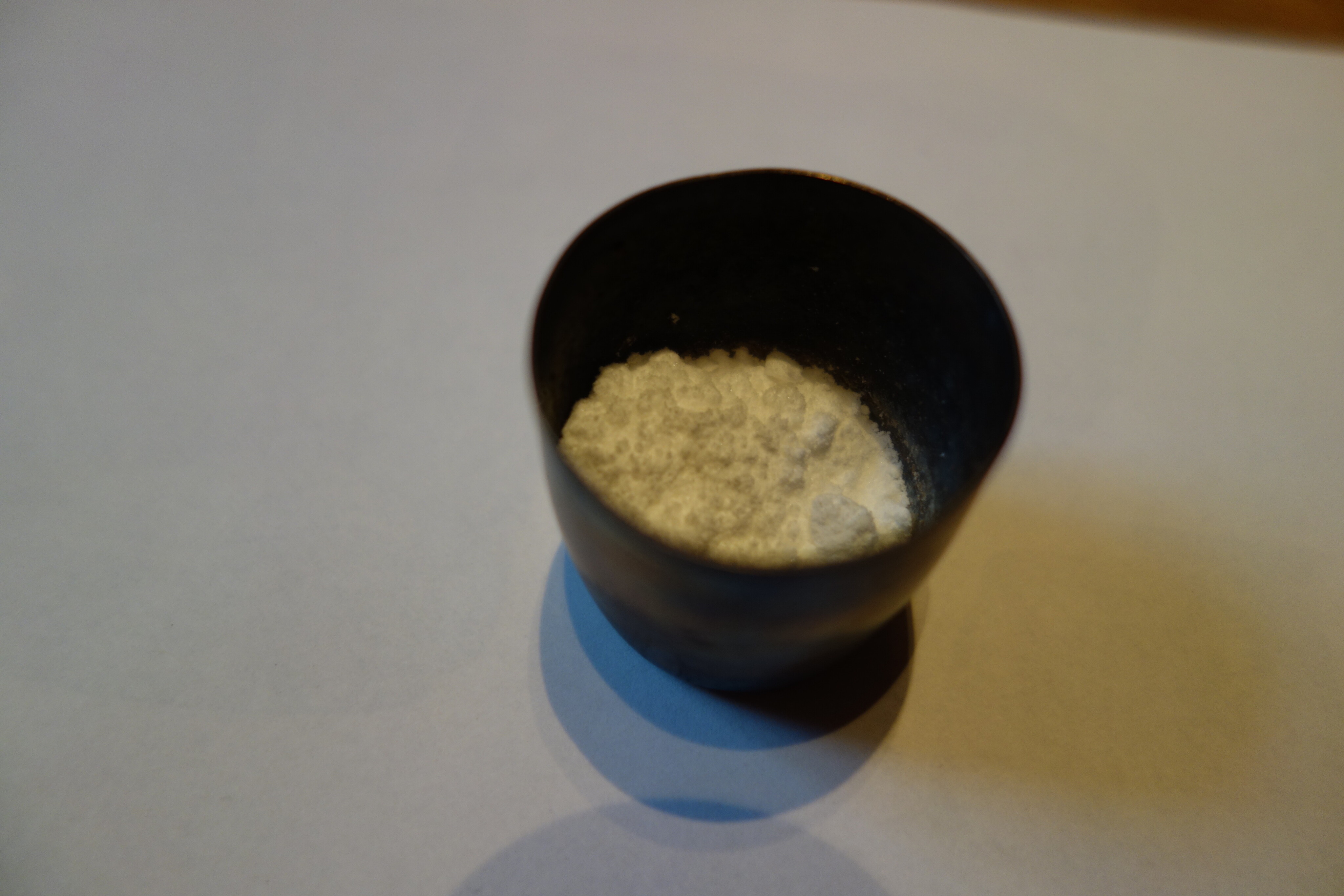

The same procedure, used in Experiment 3, was followed, this time using 4.00g (24.1mmol) of phthalic acid.

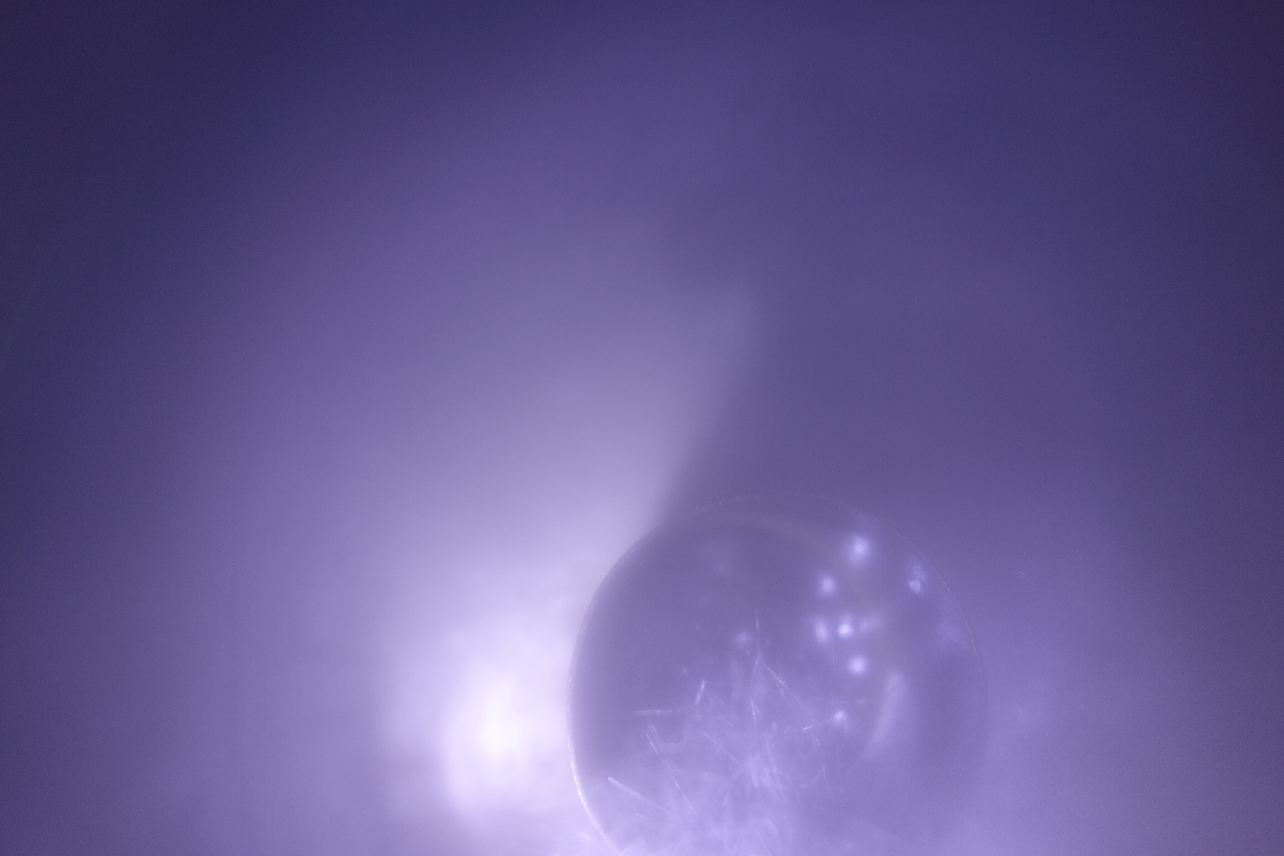

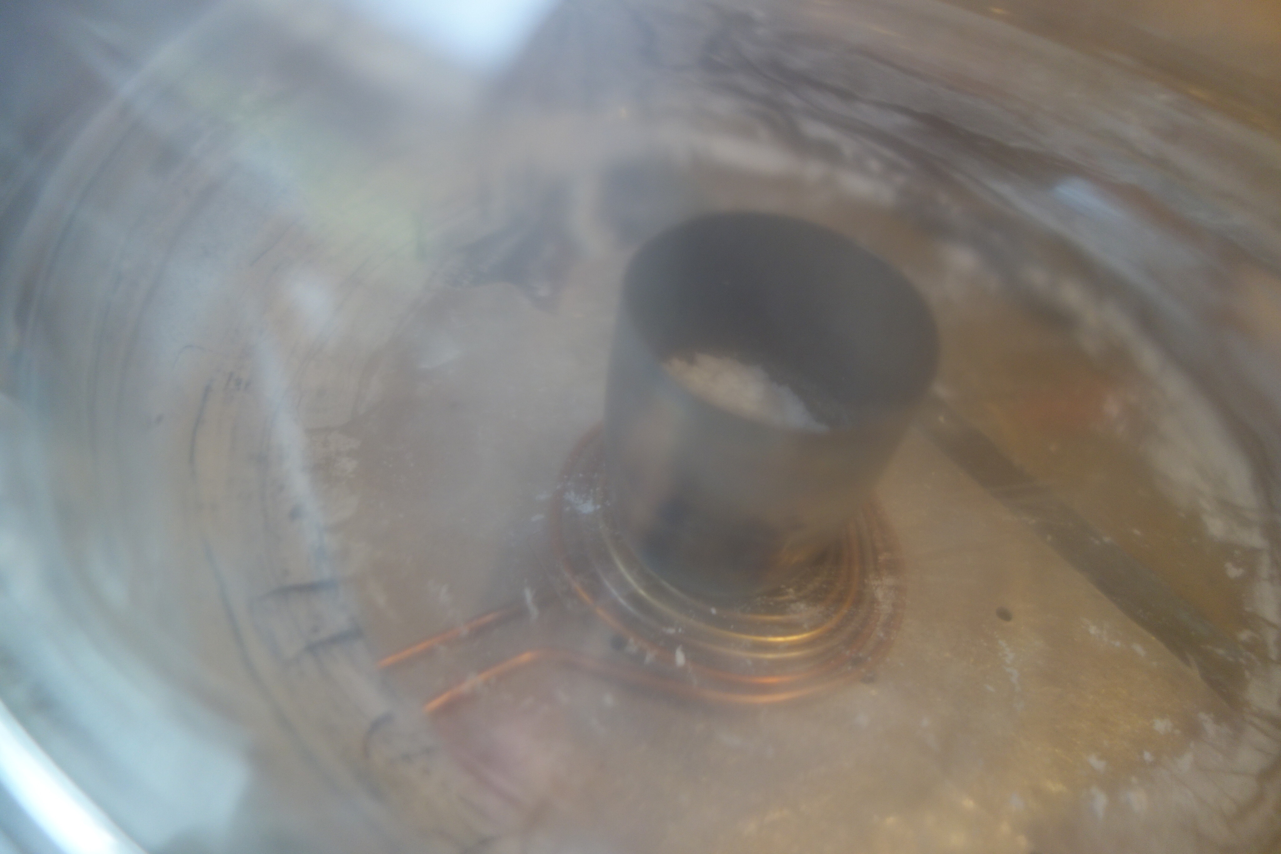

When the induction heater was switched on, the phthalic acid would first melt before sublimating.
Figure 3: Molten phthalic acid, sublimating:

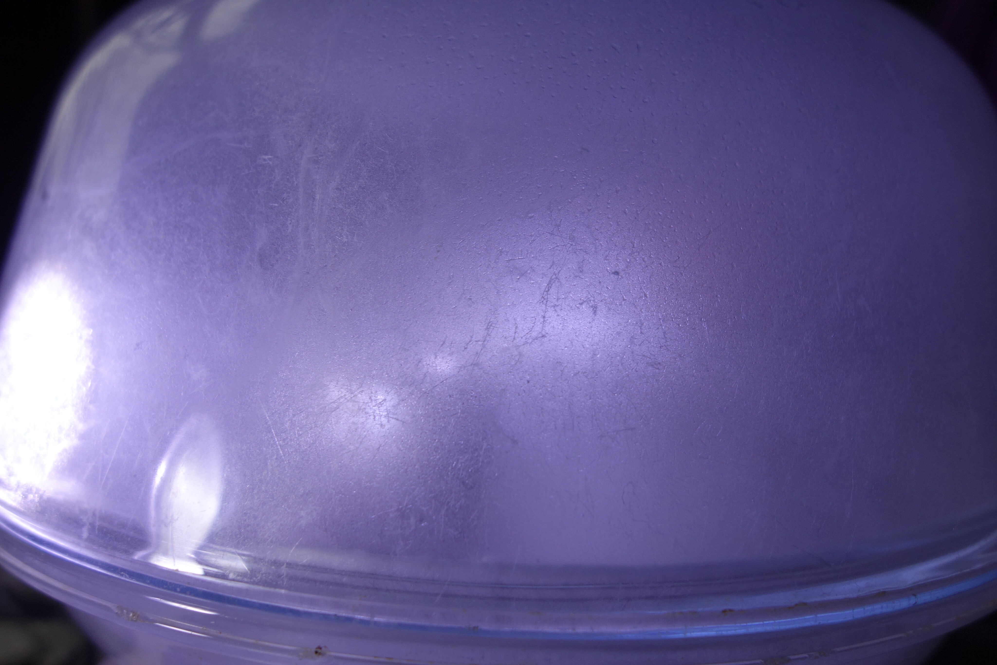

The glass would become fogged with water vapour, obscuring the view inside.
Figure 4: The sublimation in progress, with condensation obscuring the view inside the dish:
A short while later, vapours would be seen swirling around inside the dish, with a circle of white crystals on the top of the dish above the crucible.
Then woolly crystals would gradually become visible inside the dish, some of which would fall back into the crucible and re-sublimate from the
crucible in a puff of vapour.

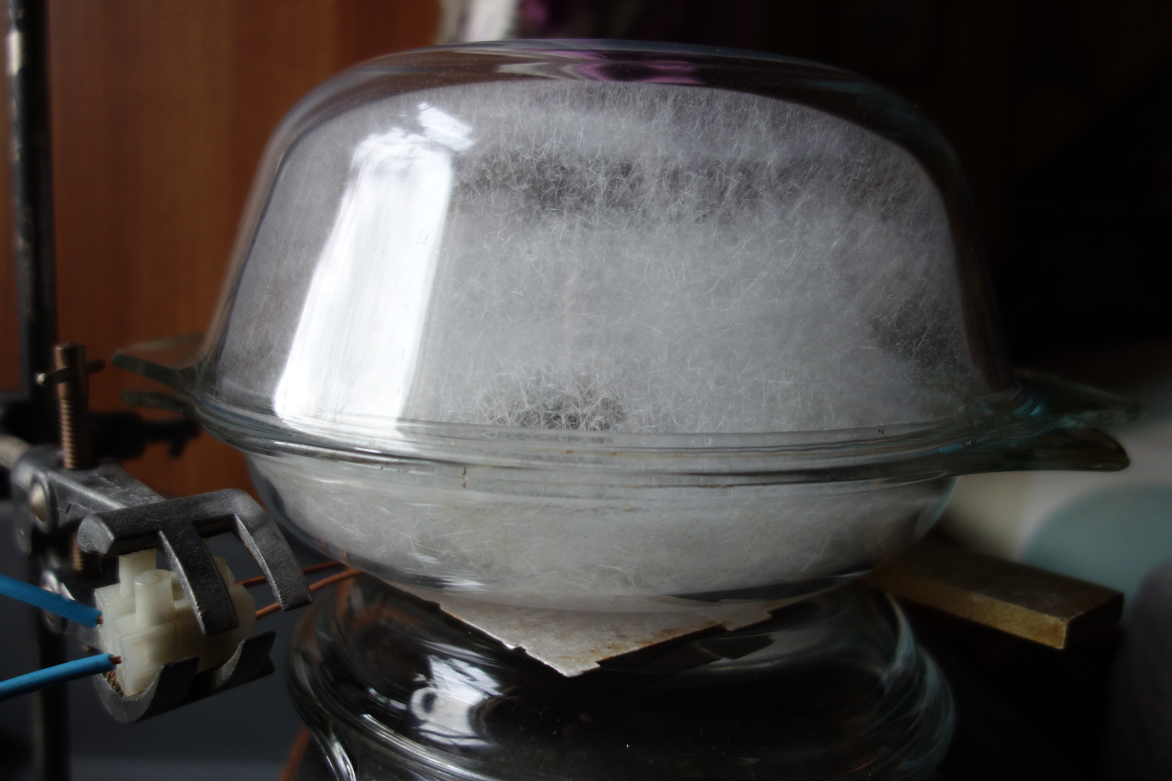

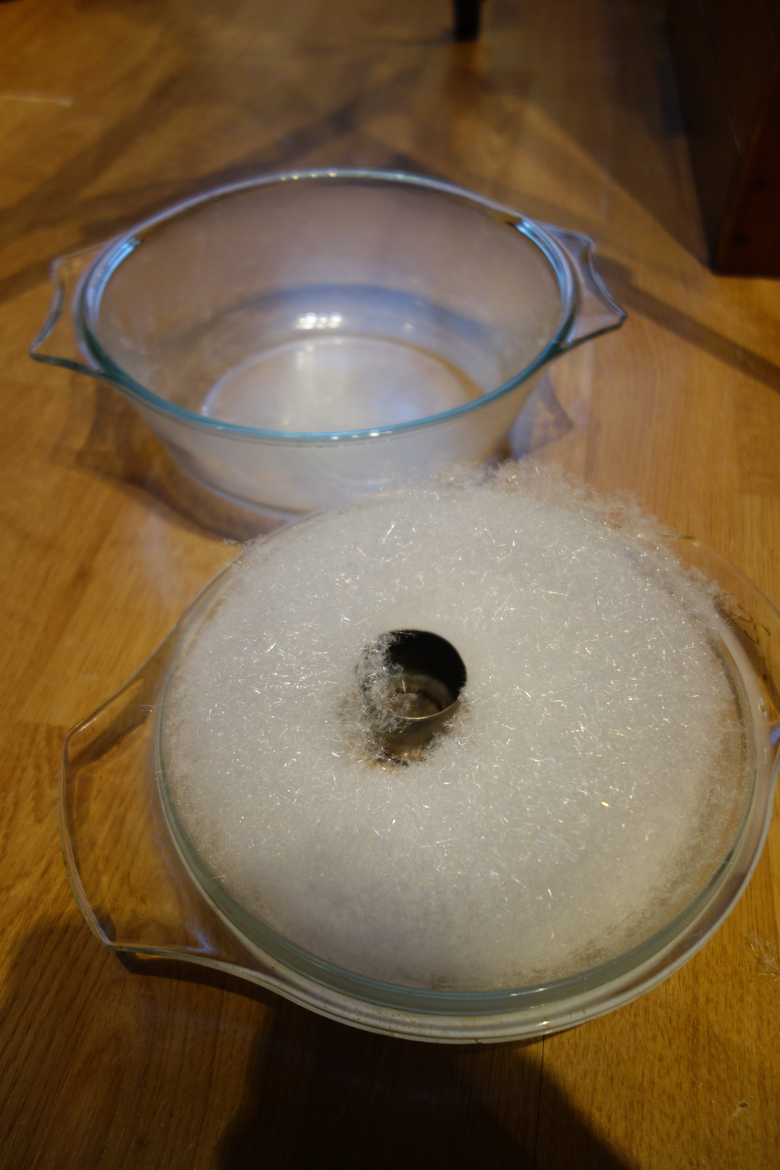

Eventually, the dish would be full of light woolly iridescent needle crystals, the contents of the crucible would be liquid and bubbling by this
point.
The end-point would be indicated by the observation that the crucible was empty.
The sublimation took only ~5 minutes for each 4g run.

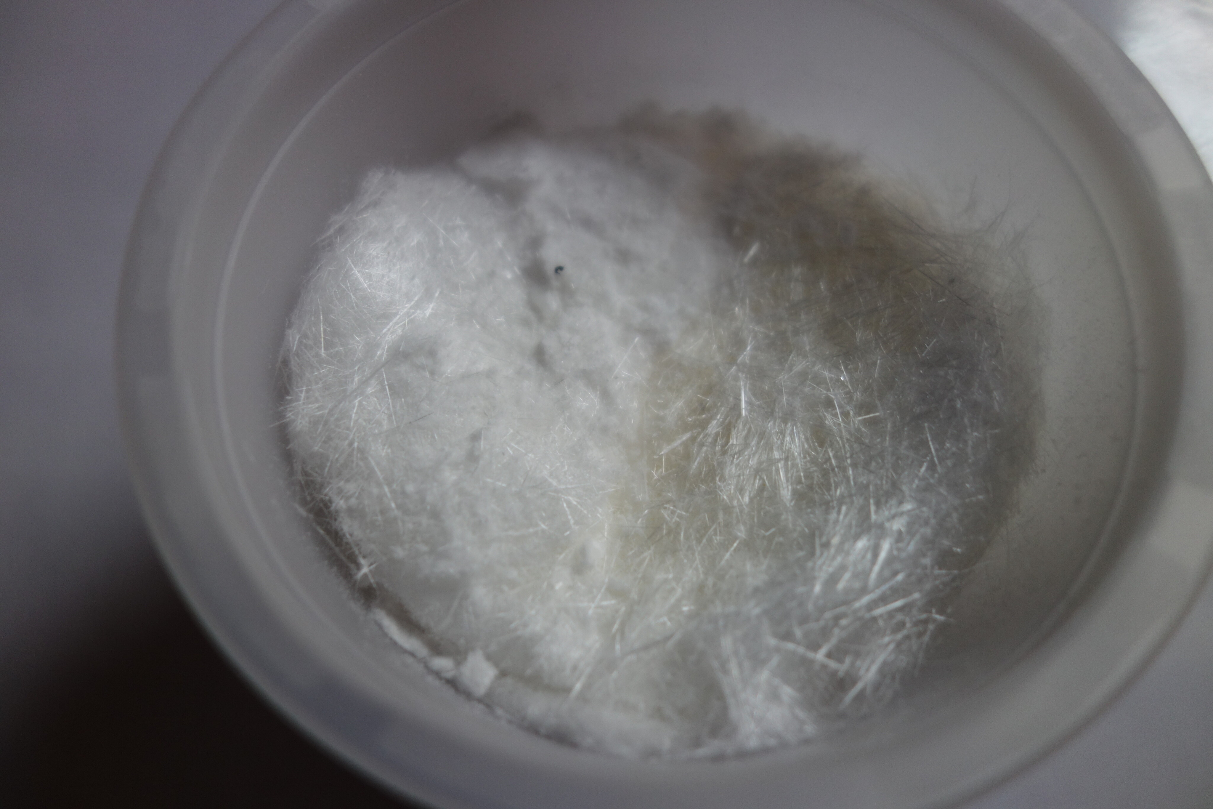

Figure 5: The mass of woolly crystals after the reaction was complete:
In each attempt, the sublimate crystallized both as wool and as white powder stuck to the glass.
The wool was loose and easily gathered, while the white powder had to be scraped from the glass with a blade.
The powder was much denser, a thin layer of the powder weighing more than volumes of wool.
Figure 6: The woolly crystals gathered up into a wad, with the fine powdery crystals and melted solids visible:
The product was not re-sublimated, instead, it was decided to retain the wool, powdery crystals, and melted product, separately, until a number of
runs had been carried out, and then re-sublimate it all at once.
The yield of phthalic anhydride after the first thermal decomposition/sublimation (no re-sublimation, as mentioned above) was 3.37g (22.8mmol), this
corresponded to a percentage yield of 94.5%.
Since 4g seemed to be a sufficient quantity of phthalic acid to fit into the crucible (it filled it to around half-way), and given that the yield was
almost quantitative, the procedure was repeated four more times, with 4g of phthalic acid each time, in order to obtain a sufficient quantity of
phthalic anhydride for future experiments.
All of the data is tabulated below:
*In this experiment, a re-sublimation was carried out prior to weighing the product, so this figure is probably somewhat lower than it should have
been, compared with the other data, all of which represent the yield without a re-sublimation.
**In the fifth and final run in Experiment 4, the yield was slightly higher due to more thorough scraping of the powdery sublimate from the glass, the
impossibly high yield being due to product from the previous sublimations.
Usually, around 1.45g of the product was collected as wool, the remaining ~2g being in the form of fine powder or melted solids.
In the fifth run, due to a problem with the induction heater, the process was stopped half-way and the wool was gathered into a clump before resuming
the process.
Although the final yield was much the same, a much larger proportion of the product (2.45g compared with the usual 1.45g) was in the form of wool,
with much less in the form of the denser powder.
The reason for this is uncertain, perhaps the glass was not allowed to become excessively hot, therefore less product melted onto the glass.
In total, 19.31g of phthalic anhydride, collected as wool and as fine powder and melted solids, was obtained.
Figure 7: 19.31g crude phthalic anhydride, as woolly crystals, fine powder, and fused lumps:
This entire quantity was re-sublimated, using the same procedure as before (using the induction-heated nickel crucible inside the glass dish).
Figure 8: 4.00g crude phthalic anhydride in crucible, for resublimation:
Figure 9: The resublimation in progress, with the woolly crystals clearly visible due to the lack of condensed water obscuring the view:
It was necessary to carry out the re-sublimation in 4g batches due to the small volume of the crucible, furthermore, numerous re-sublimations were
necessary, each time collecting the wool and returning the powdery sublimate and melted solids to the crucible.
This was done because it was desired to obtain all of the product in the form of wool, although this was probably unnecessary.
Eventually, 18.59g of wool was obtained, in addition to 0.14g of fine powder scraped from the glass after the final re-sublimation.
Final yield: 18.73g (126.5mmol), 97.0% of the mass of the crude product prior to re-sublimation.

The induction-heated approach was far superior compared with the traditional beaker + RBF approach, however the induction-heating was not strictly
necessary, an alternative approach would be to use small electric heating-elements.
The apparatus would work even better if a larger glass (or other material) dish were used, this would allow more space for the woolly crystals,
perhaps reducing the fraction that deposited on the glass as a fine powder.
