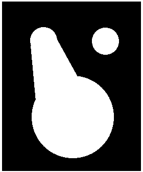

Membrane was non-woven polypropylene cloth - the type used for weed matting and cheap shopping bags. Gas extraction was via a manifold formed in the
the cell spacers, which were 6mm acrylic with cutouts as per attached image - alternating spacers were flipped left-right.
The whole stack was built up : ss plate | left spacer | membrane | right spacer| plate | left spacer | membrane etc.
There was also a small hole right at the bottom through the whole stack to allow the electrolyte level to equalize across all the cells.
Don't know the electrolyte concentration, I just tossed some NaOH in some water without measuring.

Clever and simple design. One thing that stopped me from trying a separated output cell like this was pressure. You'll be getting twice the volume of
H2 gas compared to O2 gas, right? That means the pressure between the O2 and H2 cells will naturally be unbalanced, and the O2 is at risk of being
contaminated by H2. Cloth will stop gas transfer, but not if there's any pressure behind it.
What with the VERY generous explosive limits of hydrogen concentration in oxygen, I feel like I'd never be able to trust the oxygen at least anywhere
near a flame.
Did you notice any such problems?
