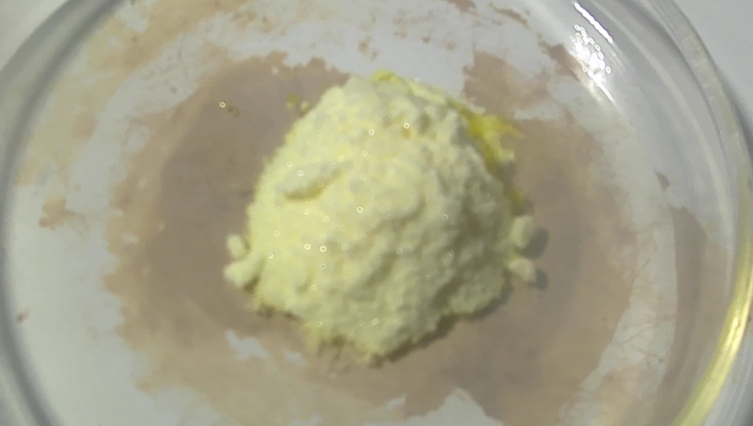

Below are images from lab video, it's a cheap chinese gopro so very grainy (sorry, i didnt intend for others to view it.)
The recrystallized product is on the left, you can somewhat see the sparkling quality to it. The right image is in melt phase @110c. It has no
decomposition at all in melt phase and at ~68C it reverts back to the original lighter color in a more-dense casted state

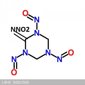

![NTNT4.png - 765kB](http://www.sciencemadness.org/talk/files.php?pid=678216&aid=95343)
[Edited on 4-11-2022 by Hey Buddy]
![NTNT5.jpg - 25kB](http://www.sciencemadness.org/talk/files.php?pid=678216&aid=95345)

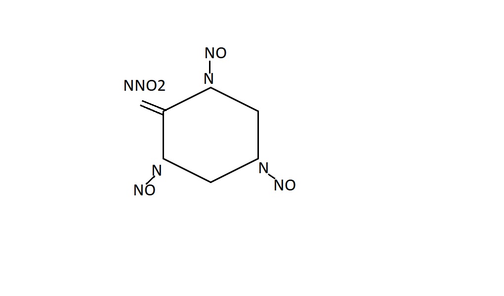

I did just realize I miswrote in earlier post, to clarify, NQ molar equivalent to hexamine controls monohydrochloride formation, if there is less NQ
equivalent than the remainder of hexamine, then that remainder should become TMTN upon addition of NaNO2. The molar qty of NaNO2 controls how much
monohydrochloride (2-nitriminohexahydro-1,3,5-triazine monohydrochloride) is produced. If there is not enough NaNO2, then not all of the
monohydrochloride is converted into NTNT. So a slight excess of NQ in molar ratio to Hexamine is a good measure, and an excess of NaNO2 is an
important measure to avoid monochloride in the final product because according to Yohngzung, the monohydrochloride explodes at 102C which is below the
melt cast temp of NTNT at 110C.
The picture below helps to explain sub-reactions taking place before the formation of NTNT. These compounds can be easily produced as well though they

I have attached two references for polynitro compounds for NQ. These papers are where my research started and after a lot of failed experiments with
strange derivitives I came to this NTNT compound and going through testing procedures found that it is very suitable as an explosive. I really need to
determine velocity and pressure, but for the simplicity of production it is hard to beat.
![NTNT6.jpg - 256kB](http://www.sciencemadness.org/talk/files.php?pid=678224&aid=95347)

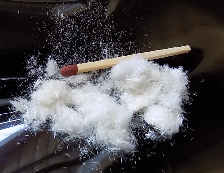

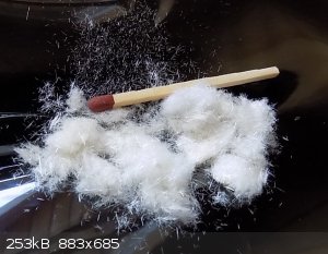

I hope, that on picture is Nitroguanidine - NQ
As Texium said. It’s to ensure that your results are unambiguous and reproducible.
![NQ.jpg - 253kB](http://www.sciencemadness.org/talk/files.php?pid=678242&aid=95353)
[Edited on 5-11-2022 by Laboratory of Liptakov]

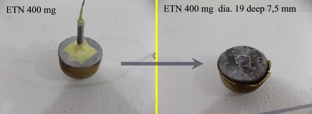

The test in a solid cavity and the depth of the crater in the lead block will be decisive for the attractiveness of your substance. Or perforating a
3mm thick steel sheet with 1g of your cast substance.

The cavity is always perpendicular. The steel sheet is a standard sheet, or a U or D profile, 2 - 3 mm thick. 2.45 mm is also OK. In the picture, the
lead block is 40 mm high and 65 mm in diameter. Which is suitable for the test of 300 - 1000 mg ETN, PETN, RDX. Pressed 400 mg ETN (50 kg pressure in
ID 6mm) gives repeatedly the same result as shown in the picture. If 400 mg of ETN is used, the result should be the same anywhere in the world. Or
very similar. Thread about standardized testing not exist.

Quote: Originally posted by Laboratory of Liptakov ![](images/xpblue/lastpost.gif) | The cavity is always perpendicular. The steel sheet is a standard sheet, or a U or D profile, 2 - 3 mm thick. 2.45 mm is also OK. In the picture, the
[Edited on 6-11-2022 by Laboratory of Liptakov] |

I assume structure is this, but have no idea. I drew a picture earlier but had forgotten double bonds of nitrosamine
