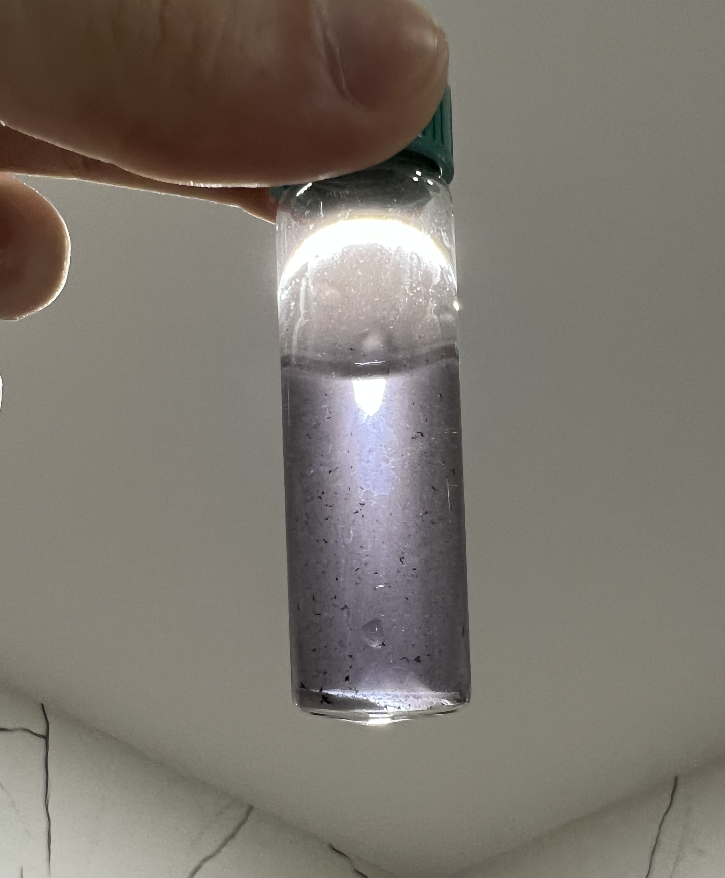

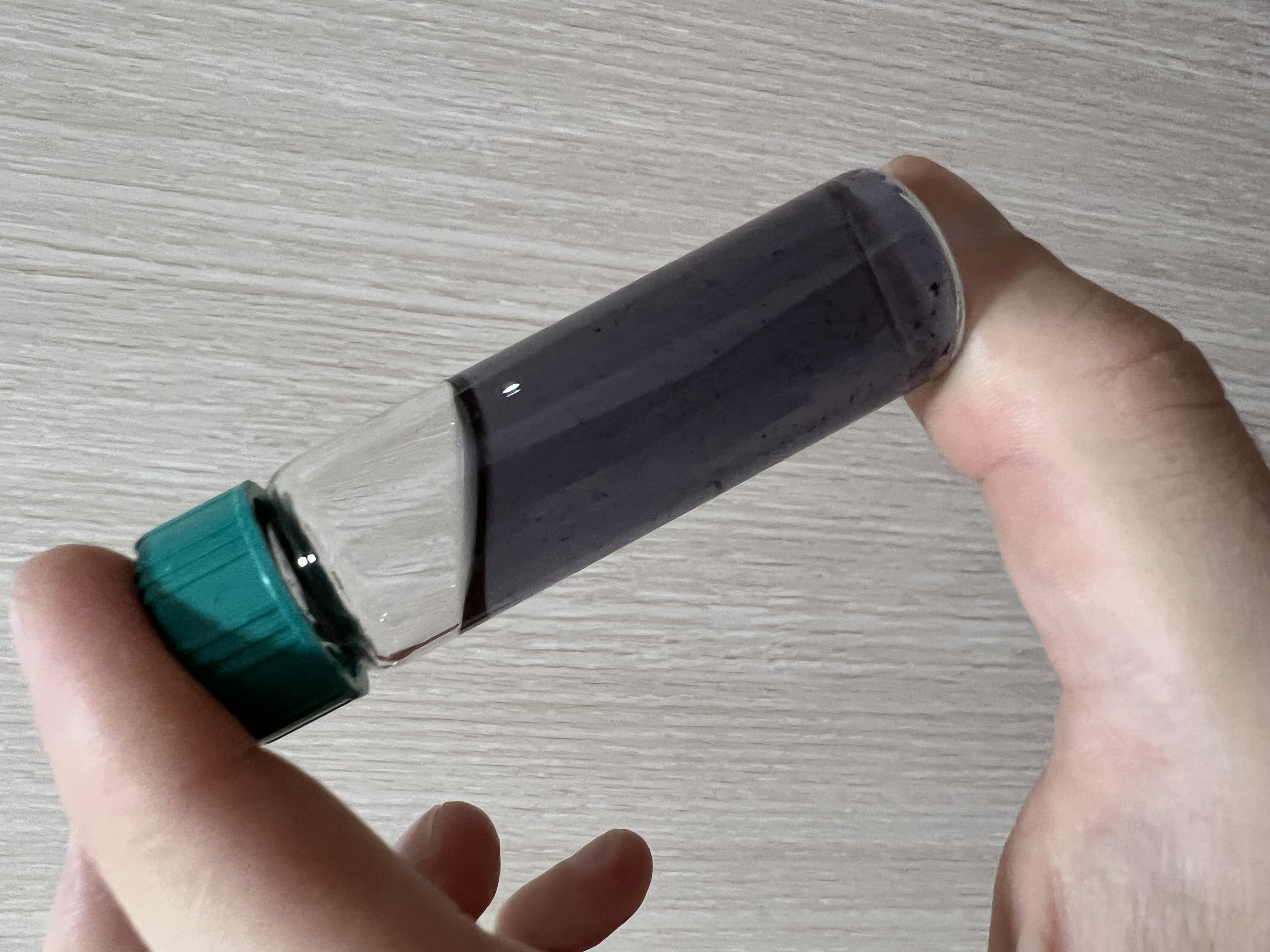

Hello! I made some colloidal gold solution. also very easy to make at home. it needs just acids and old electronics, but very small amounts are
necessary. first, I added conc. nitric acid to gold-plated components, as you see not much. then made gold foils and add less than one gram of
mercury, when I dissolved it in nitric acid I get this funny amount of gold(PICTURE 2).
![IMG-2229.jpg - 1.3MB](http://www.sciencemadness.org/talk/files.php?pid=676495&aid=94745)
then I added maybe less than 2ml aqua regia. I diluted the chloroauric acid solution and add carbonate at the same time I was heating it.
The solution got this color (PICTURE 4&5). I did this experiment on a plate because a large area is important. there are some gold particles
because I didn't filter it.

There was very small gold foils particles, polymers waste. So i collect all gold with mercury.
