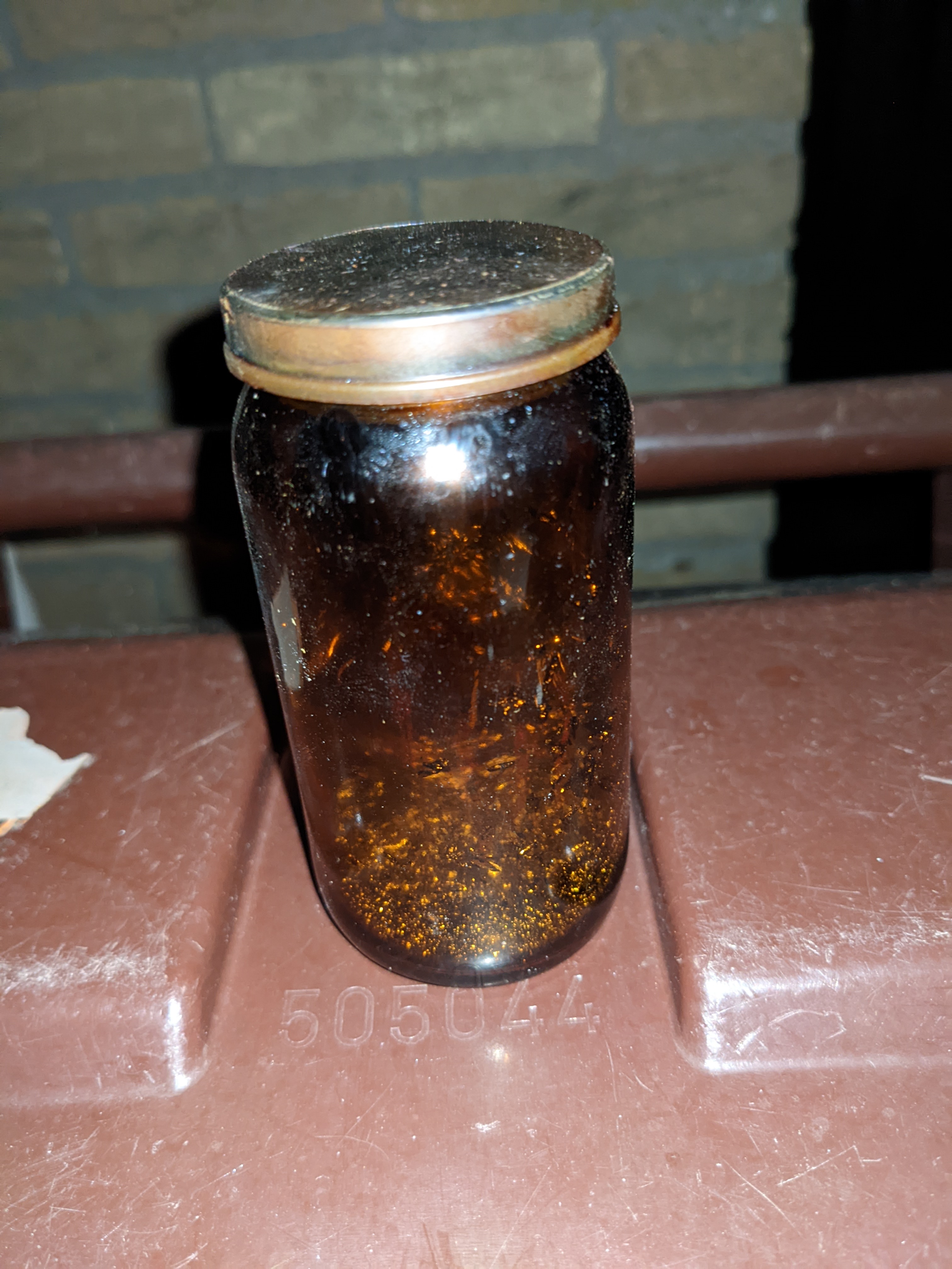

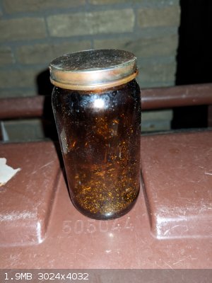

Posts: 3026
My iodine has been stored like this for 15 years, I haven't noticed anything leaking. I don't know what the cap is made off, but there is some grease
on the inside. Temperatures uncontrolled, between -10 and +30 I guess.
![PXL_20220716_223833994.jpg - 1.9MB](http://www.sciencemadness.org/talk/files.php?pid=675165&aid=93948)
[Edited on 16-7-2022 by Tsjerk]
