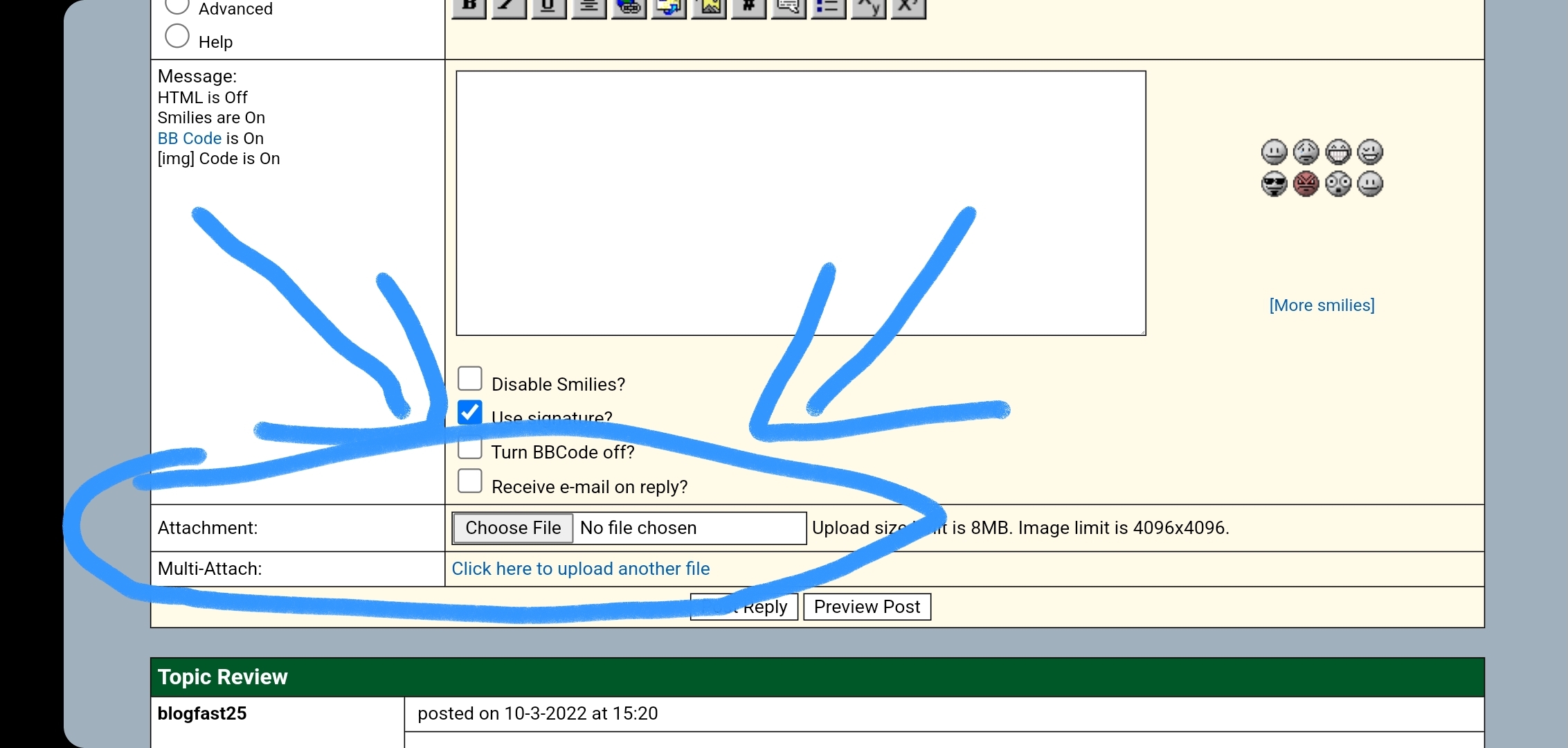

Images still work. Click preview post and add the file there

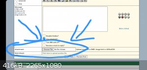

[*] posted on 10-3-2022 at 17:32
Screenshot_20220310-203144_Samsung Internet.jpg - 416kB
[*] posted on 11-3-2022 at 04:58
Thanks Rainwater! Old age and poverty have affected my memory...:(

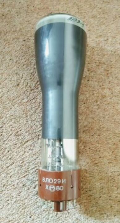

Here's the CRT (oscilloscope type) in question:
CRT03.png - 437kB

There is usually an inlet port on the bottom... a sealed glass tube... You have to drill it out, then attach another glass tube before it can be sucked and sealed. Yours may he different. They're usually a borosilicate type glass. But a jewelers torch will make quick work of it.
When drilling it out it is helpful to sand it flat first

Also, as soon as you open it there's a good chance that the getter will oxidise leaving a hygroscopic surface.
For best results, you will need to work out how to bake the tube, and re-fire the getter.
The good news is that, if you can work out how to do that, you can massively reduce your pumping problem.
Fill the tube with something like CO2 or O2 by repeatedly evacuating and filling it to flush out any other gases like nitrogen and argon.
Then pump it out as well as you can with a "not really good enough" pump and seal it, then fire the getter to remove the residual gas.
That should drop the pressure by a few orders of magnitude.
If you are planning on opening up the tube to put a diffraction "grating" in it the you might be able to find a suitable getter to put in while you are at it.

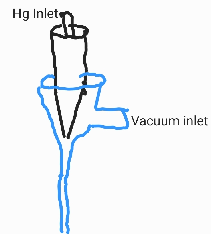

The general working principle is that each drop of mercury captures and forced a drop of gas down the pipe and out of the apparatus.
Dont know where you can source mercury but you will also need a positive displacement pump,
This is the basic design
Screenshot_20220311-184957_Samsung Notes.jpg - 76kB
Here is a good video
https://youtu.be/viJ3T-1KZqY
Take special note of your construction materials as even glass outgasses at these pressures, it will eventually stop, but if it sucks the gas out of glass any tipe of plastic will prevent you from reaching the vacuum you need

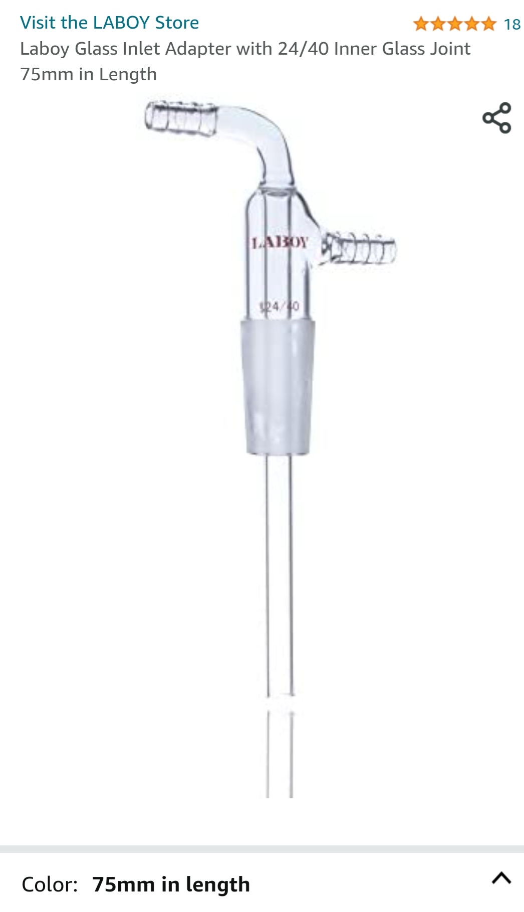

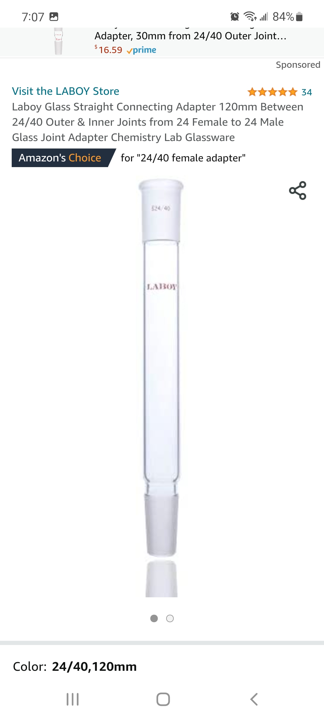

If it was me and i had a few days, i would use a 24/40 vacuum adapter. Like this
amazon link
Screenshot_20220311-190220_Samsung Internet.jpg - 90kB
I would draw that center tube out thin and long.
Then amazon link
Screenshot_20220311-190721_Samsung Internet.jpg - 249kB
Draw out the middle section thin and long.
Place the two together with grease and your a professional glass blower.
But the video shows an easier and cheaper way to do it.
