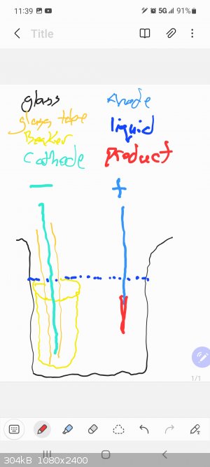

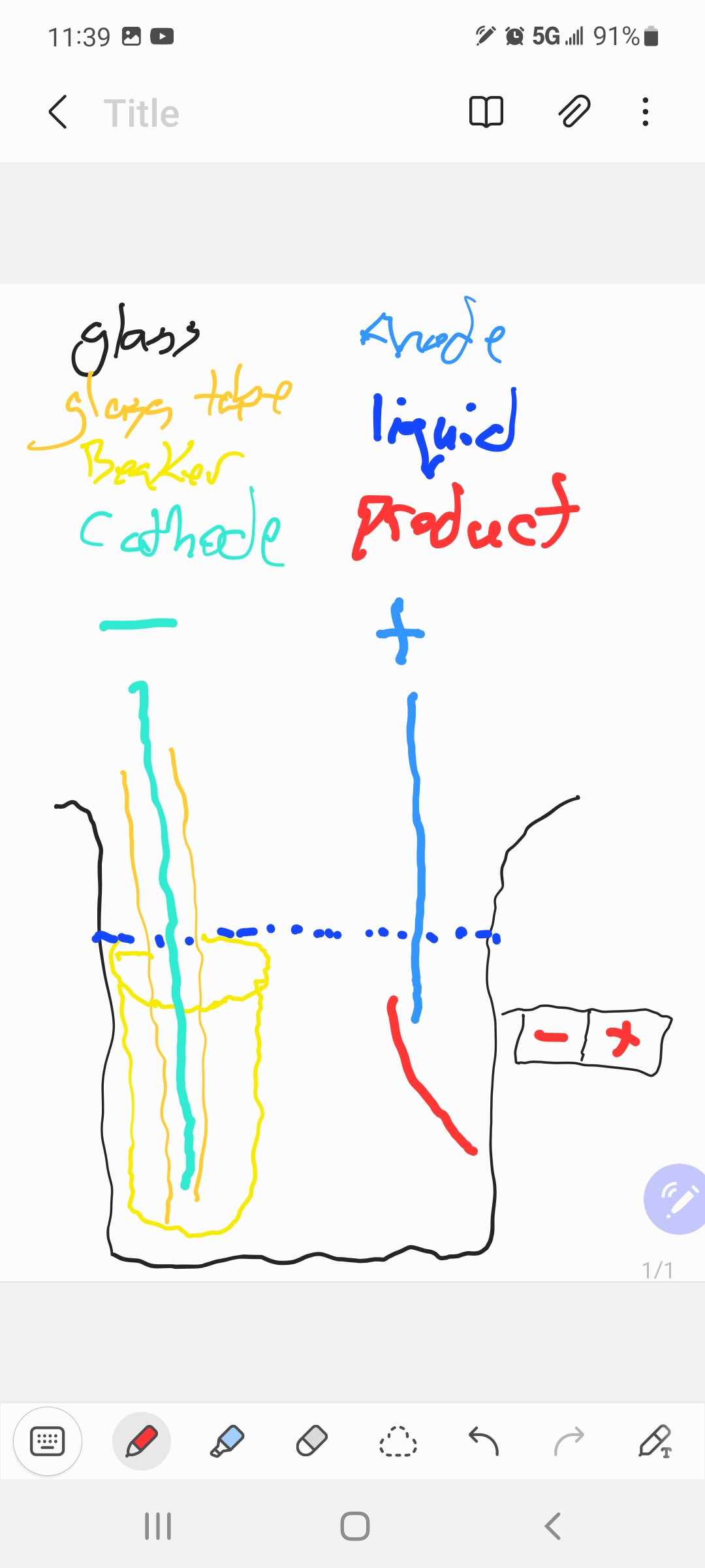

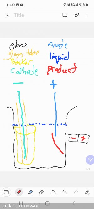

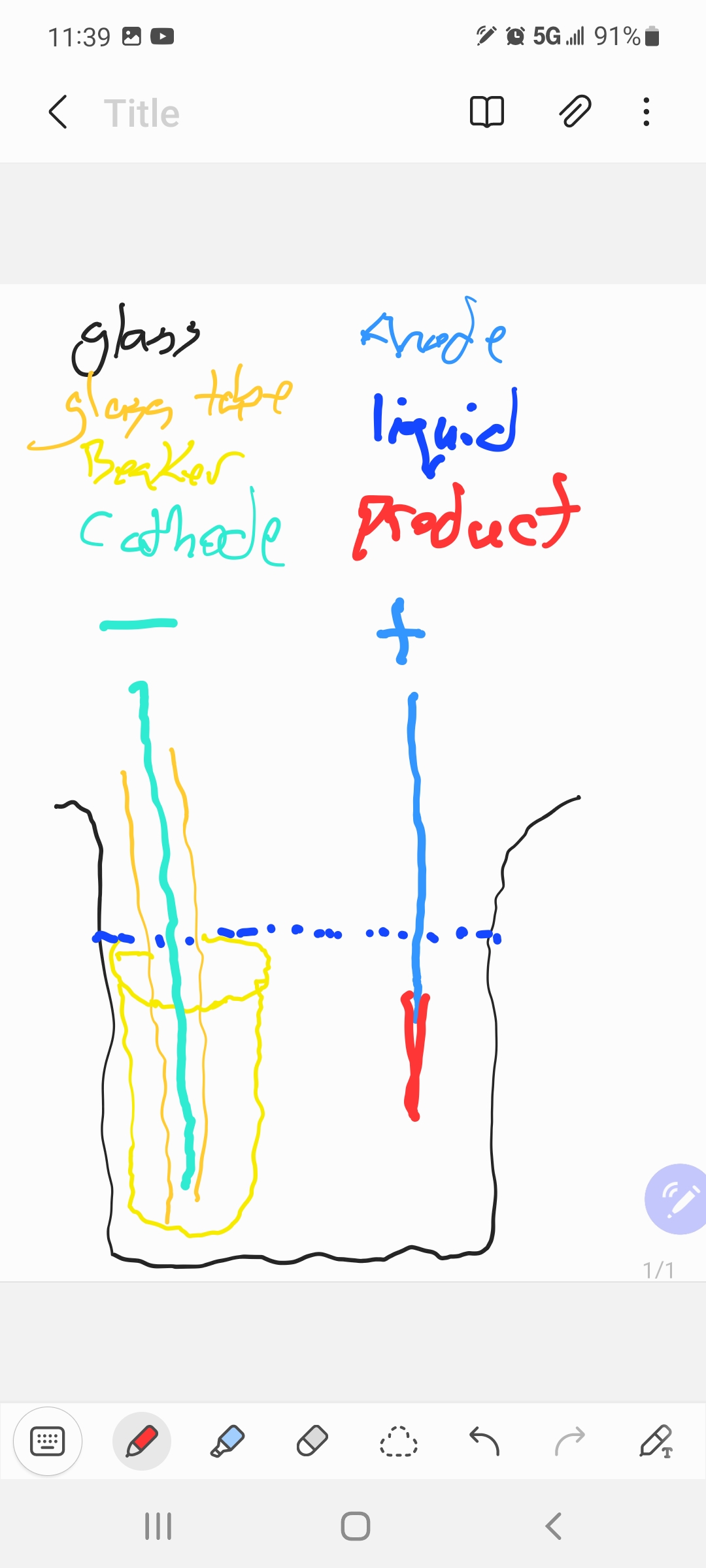

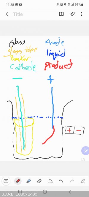

The angle was bad. If i could get my hands on a 2 thin plates and turn it 2d that would be easier to record.
Heres a doodle of the setup and effects
