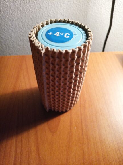

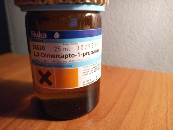

Recently I obtained small bottle of 2,3-dimercapto-1-propanol, which is an antidote against Lewisite, As, Hg, Bi, Sb, Tl, Pb poisoning.
Now I'm a little afraid to even touch it. The flask has special cover to prevent shattering the glass.
Is this stuff so bad too or is it less unpleasant than monomercaptanes (thanks to much higher boiling point)? Why should it be stored in fridge at 4 C?
