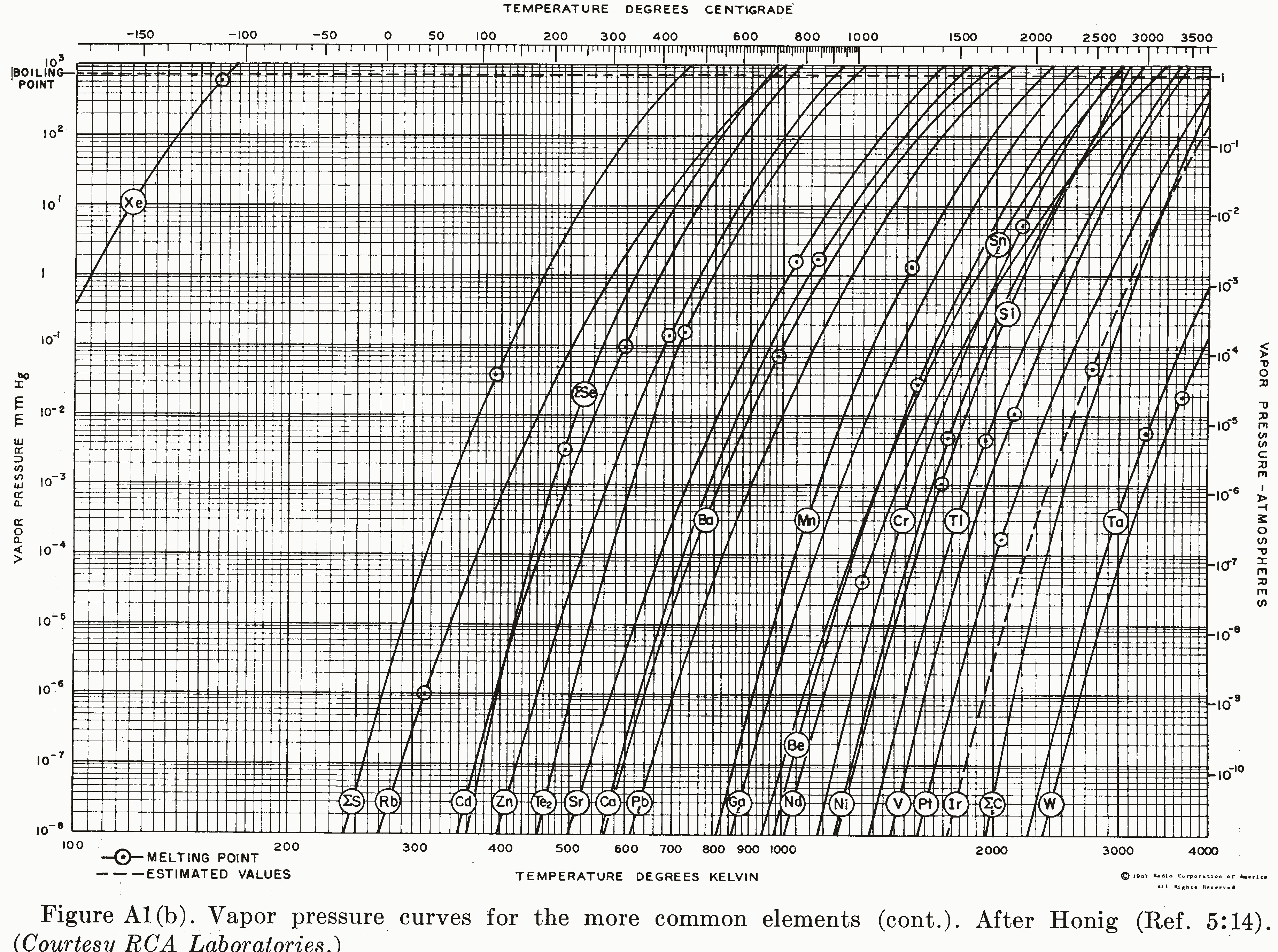

My biggest objection to this idea is that calcium isn't too terribly expensive and has a very high boiling point relative to alkali metals, which in
my opinion are more worth producing on one's own. At the kinds of temperatures us amateurs can reliably produce, calcium will be very difficult to
keep in a liquid form once condensed, and building an apparatus is further complicated by the fact you'll almost certainly need to apply vacuum. Even
with a vacuum of 10 Torr, the boiling point of calcium is still over 900C, which is awkward to work with for larger apparatus like the kind you'd
probably need to assemble. And you'd have to distill out AlCl3 beforehand, at whatever temperature that reaction even happens. Not saying it's
impossible, but too involved.
