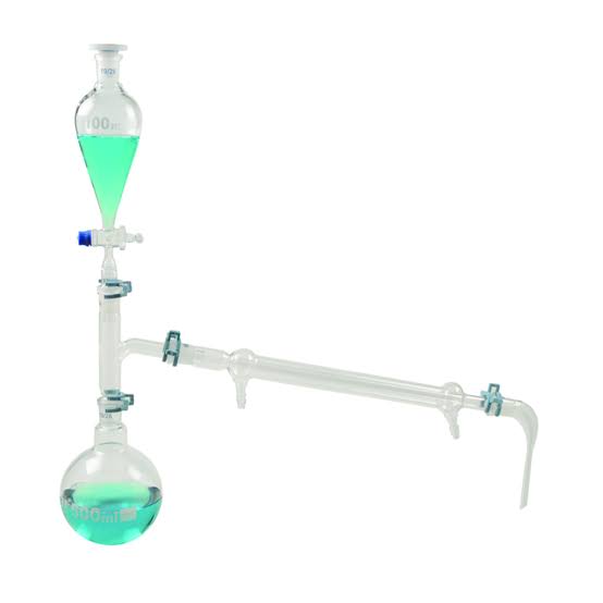

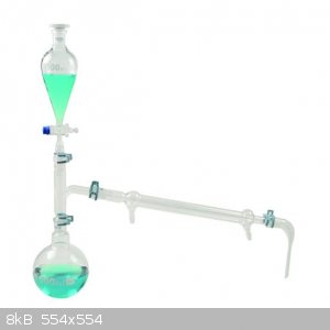

Buying pure boron powder from Alibaba/eBay and dropping br2 onto it in a quartz test tube with ground glass connections heated with a Bunsenburner or a blowtorch is really (realistically) the only option for someone in an amateur setting.
Imagine the below setup with the distilling flask
replaced with a quartz test tube. This way the rxn can be done with only the cost of boron powder and a fancy test tube.everything else is something most of us already have or can be made for peanuts. trying to fashion a metal vessel to survive the rxn seems possible but i
doubt bbr3 at red heat won't lead to catastrophe.
Trying to get a seal on a graphite crucible leading to glassware doesn't seem to be territory we've been before but it would survive the heat, hot metals/salts and maybe the halogens.maybe a ceramic vessel might work if one can figure it out and if ceramics survive halogens.the only other possible option would be a tube furnace which is an uncommon expensive harder to do way of accomplishing this.
