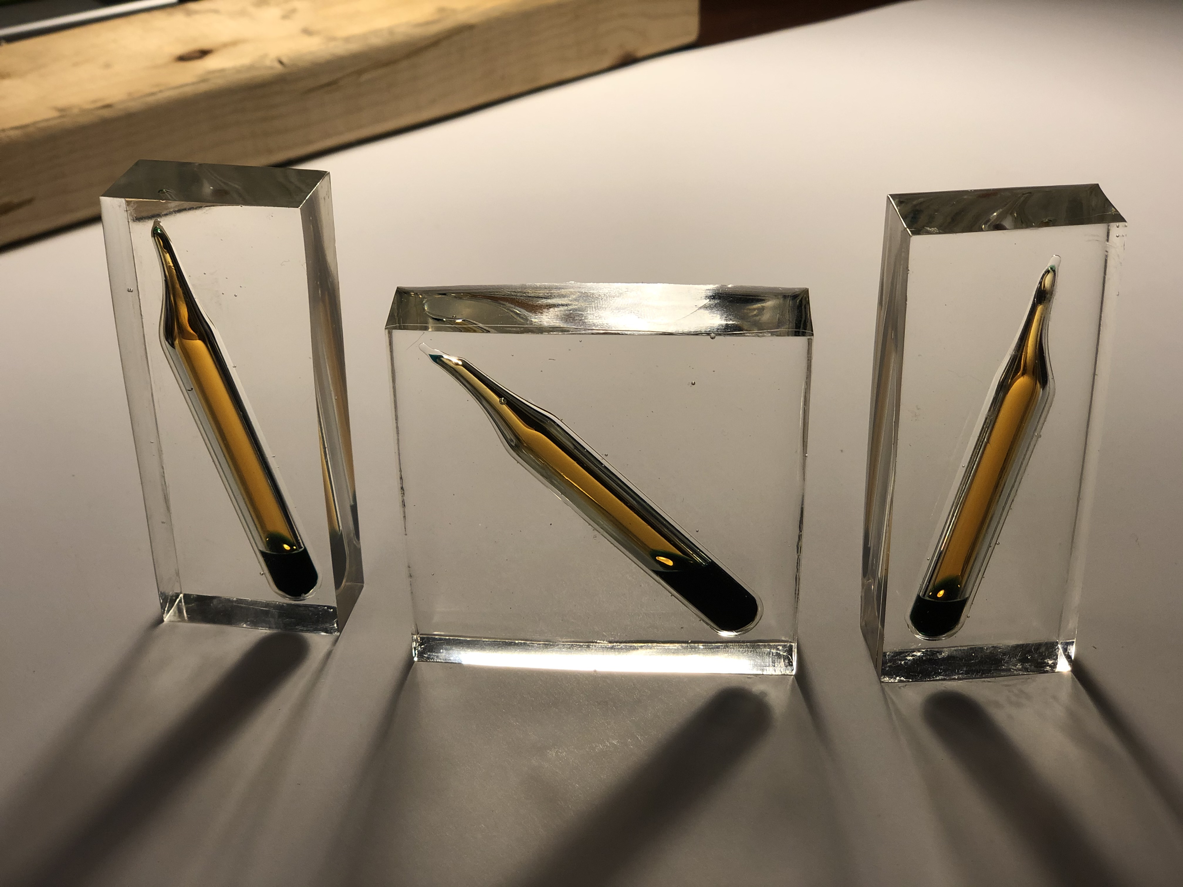

Hey everyone, I've recently managed to ampoule liquid N2O3 and NO2 using dry ice baths, borosilicate ampoules, and resin (for ampoule reinforcement in safekeeping). The process of ampouling these nitrogen oxides is fairly simple and very similar to the ampouling of liquid chlorine in terms of temperature of the condensation and vapor pressure of the condensed liquid. Though I haven't finished my video on making these ampoules yet, the process I used to make them is very similar to that used in this video:

Here's a picture of some of the N2O3 ampoules in resin that I sell.
N2O3.jpg - 1.7MB

Yeah, I gave up on the idea of potentially ampouling the N2O5 several weeks ago after seeing the rate of decomposition on storage. Not entirely sure how much pressure the resin blocks can hold but testing them to the vapor pressure of oxygen is not something I want to try out.
